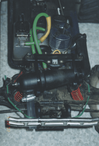

sway bars are easy to make... I made one fore my original t-max way back in the day (before the widemaxx)
get some stiff wire, the stiffer it is the stiffer your suspension will be.. you want stiffer for smoother surfaces, and lighter for rougher surfaces.....for a simple but effective swaybar all you need is a place that can "capture" the bar on the chassis, and a couple zip tires to connect it to the suspension arms... here is a pic of my t-max swaybar from 2002, i used the bumper mount to capture it to the chassis, and zip tired it in two spots to each rear arm.... it worked great and it was free...
