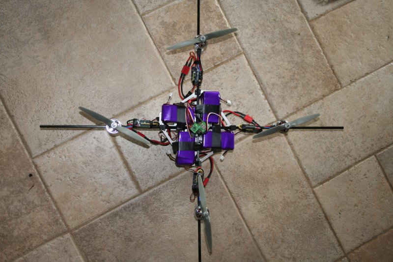

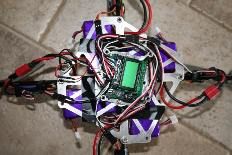

I have the gizmo basically built - 4 rotors, carbon fiber and aluminum frame.

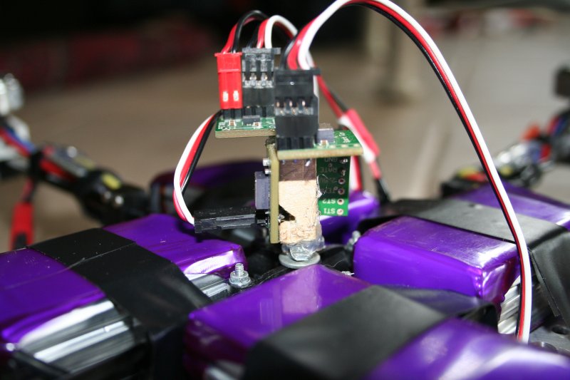

Electronics consist of 3 single axis gyros and 1 triple axis accelerometer hooked up to an atmega168 controller. I've written my kalman filter code so that from the gyro and accel I can get a roll and pitch estimate. For the yaw estimate, I basically integrate the angle seen over time.

Hi haobuhao ,
A lot of the info you're after can be found here:
http://www.rcuniverse.com/forum/m_14..._1/key_/tm.htm
To point you in the right direction ...... PID control is where you need to direct your attention.
If you've mastered Kalman filter, then PID will be a breeze.
Rather than picturing your quadrotor like an "X" you need to picture it like a "+" so you have front and rear motor pair CW rotation and left and right motor pair CCW rotation.
