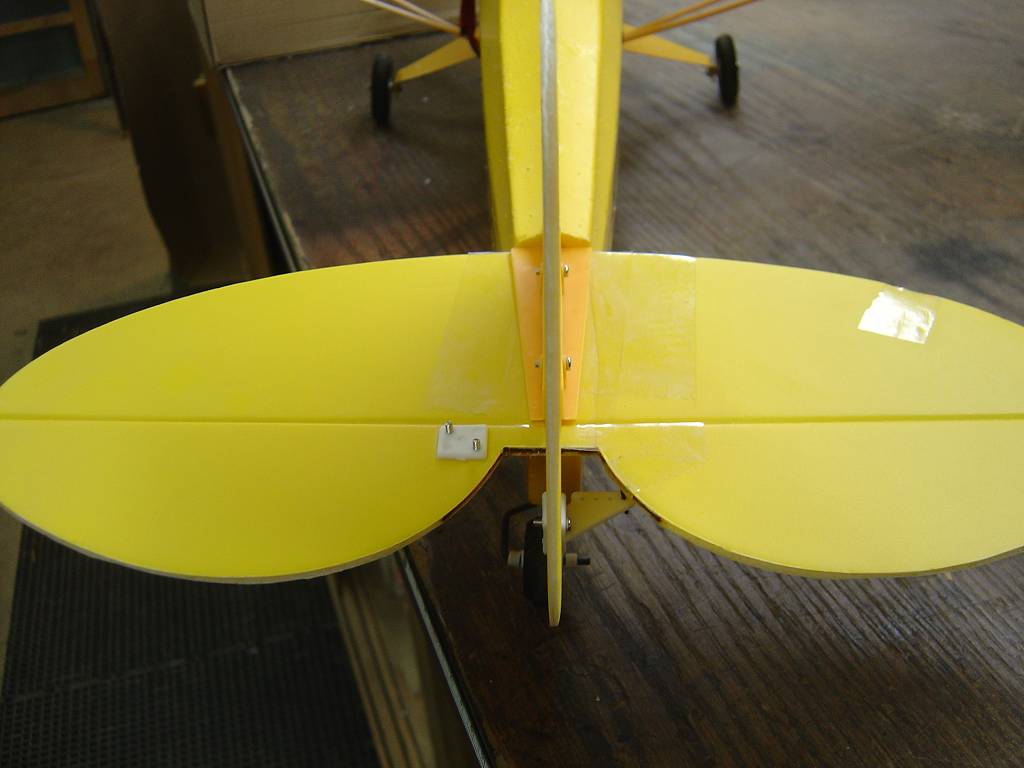

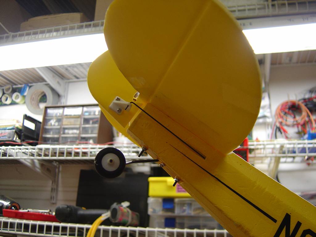

No, it has a little bit of flex , and since the horn is on the lower left it gets "pushed" toward the rear. It makes the left portion a bit higher than the right (when using full elevator) of course. Wouldn't this cause a roll toward the left though?

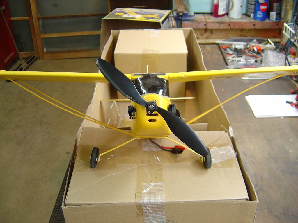

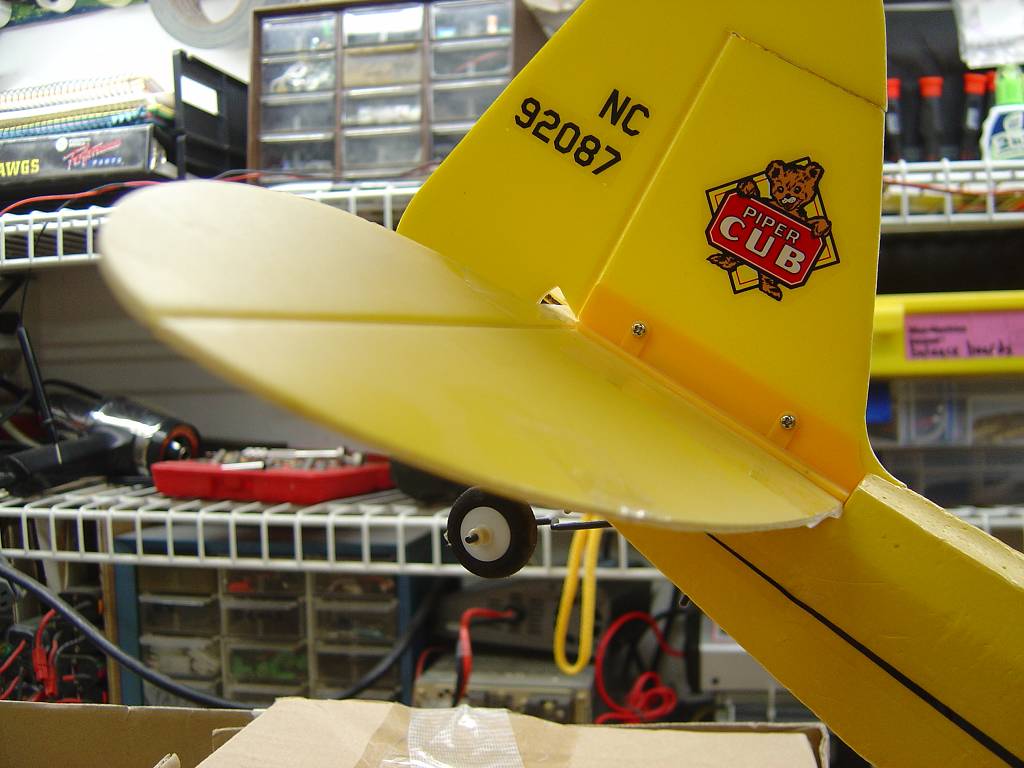

I don't have the Fly zone cub, but I have several Parkzone and Hobbyzone cubs. When one of them does this it is usually either the vertical stab flexing, the entire tail section flexing, or the elevator flexing. I have had a warped wing on the Parkzone J-3 cause this. I also had a loose strut on the Hobbyzone cause this once, but in this case it was a very gentle roll. I would look closer at that tail section.
My Feedback: (325)
Join Date: Mar 2003
Location: LaGrange, OH
Posts: 14,857
RE: Piper rolls right when up elevator is full
Checking the tails and the struts now. Thanks.
The struts are a bit hokey , they are bowed in opposite directions (one up and one down) but they have about the same amount of slop in them when wing is pulled up.

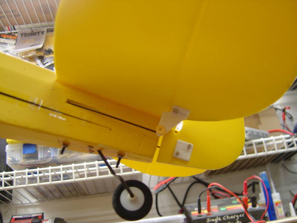

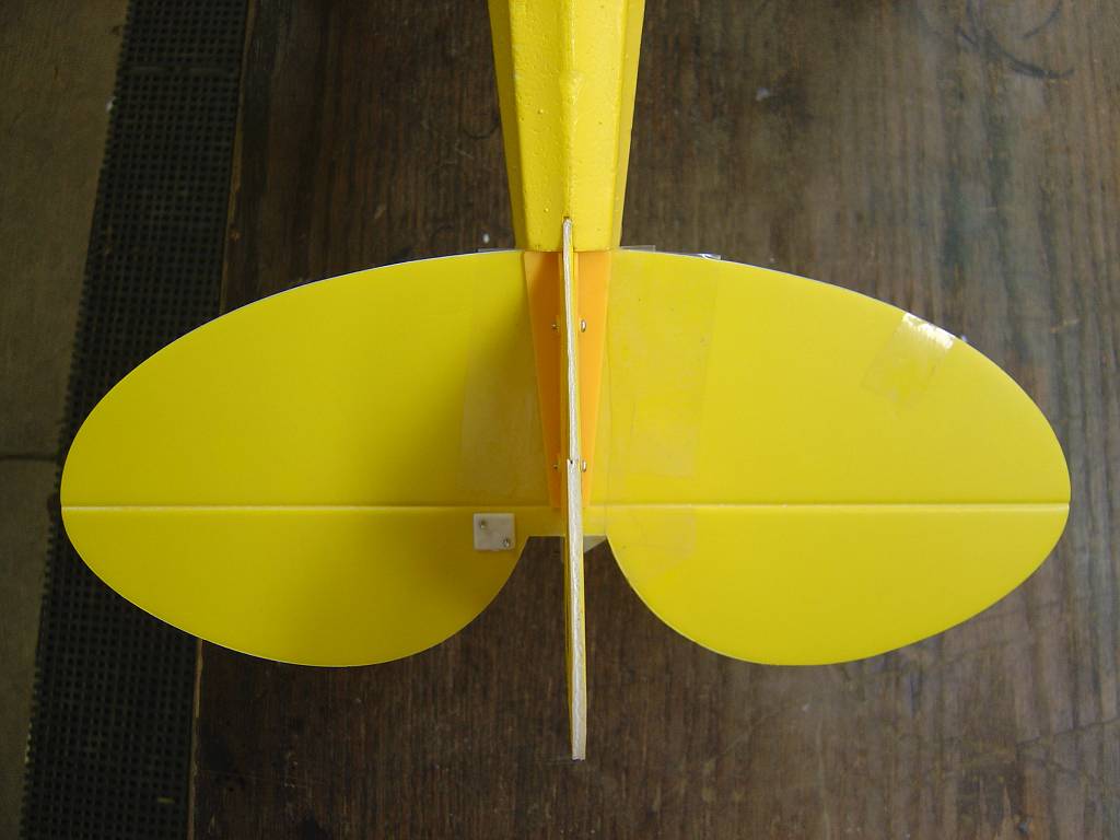

The tails all look ok to me, a bit on the weak side compared to some of my other planes. Here's some pics and I might just flip the rear stab over so the horn is on the right instead. I'll move the rudder horn onto the left and swap servos inside. I'm not sure what that'll tell me if it changes , but if it does change the behavior then I know I am onto something. The rear of the plane is very strong anf the fuse has no noticeable flex. The rear stab does "steer" right and left a bit of slop in it.
