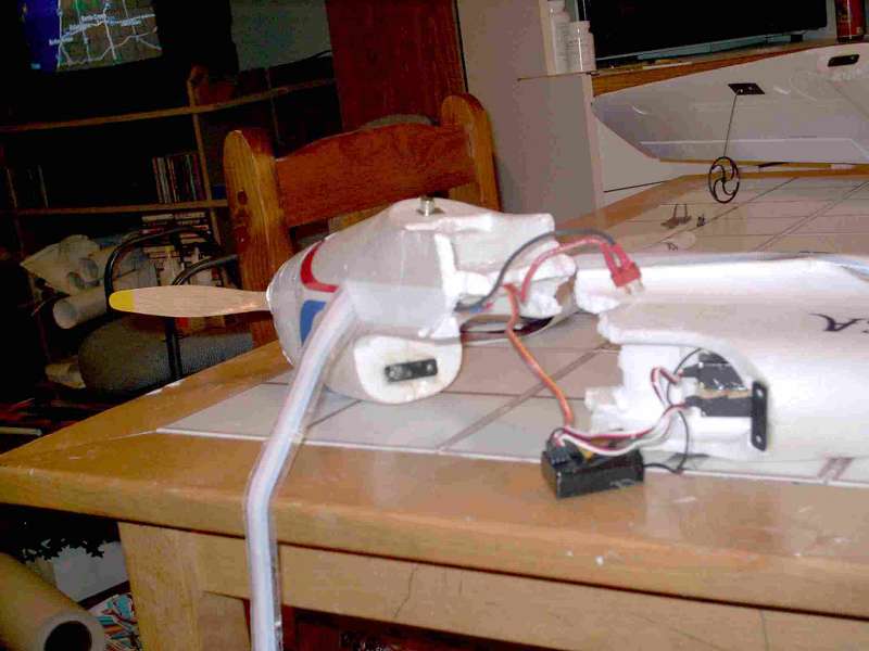

I enjoy my Formosa very much. I'm using Tanic and Kokam 1500mAh 3S1P packs, a CC Phoenix 25 ESC, and a 2025 4200 Himax motor. I'm using the GWS 400C gearbox with an H (5.28:1) gear ratio. This is about the same as a 350C geabox with the C ratio. I swing 10x6 or 11x7 props on it. The 10x6 is good for about 15 minutes flying time with excellent performance. The stock 350C motor is a lot of fun with a 3S lipo battery, but the brushes are destroyed at the end of one 15 minute flight. I run a speed 400 motor on a GWS PT-17 bipe on the 400C gearbox with an E (3.40:1) ratio. The speed 400 motor holds up quite well with the lipos. My complete drive system for the Formosa is available from www.e-flightline.com. You may want to reinforce the fuselage for the brushless system. Here is a pictue of mine after the 21st flight. Oh - I add a stick from front to back of the fuselage over the battery to ensure that the battery pack is still in the fuselage at the end of the flight.

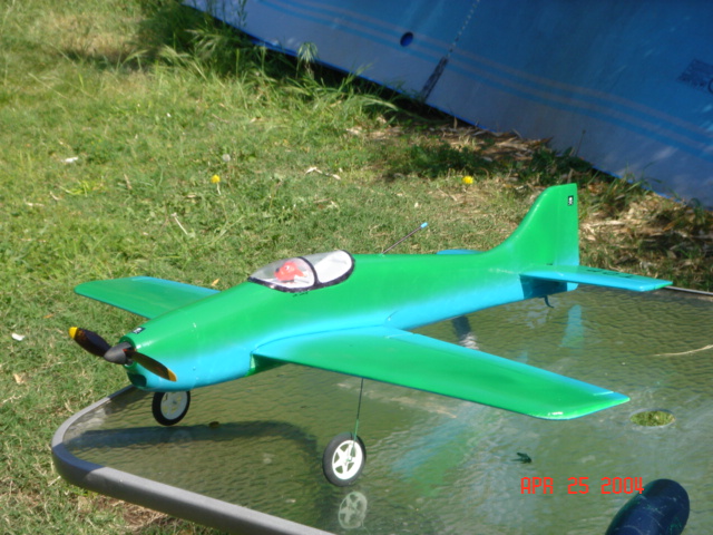

I have a Formosa that I flew stock for a while, then I changed the prop to an Apc and it made a great improvement then. Then I went to 3S TP and a 9x6 prop and a Castle Creations Pixie 20 ESC, removed the landing gear- great improvement. After about a month of flying the set up the motor burned so I decided to spring for the brushless. Castle Creations Phoenix 25 and a Mega 16/15/6 with an APC 8x5 and a TP 1300 3S the new pack (12C) and now take off roll is about 5 feet, unlimited vertical, will fly leveled with less than half throttle, and I get 12 to 14 min flights with mixed performance. The Mega motors are the best investment if you want to fly the GWS birds ior anywhere you need a 400 size motor that cooks.
