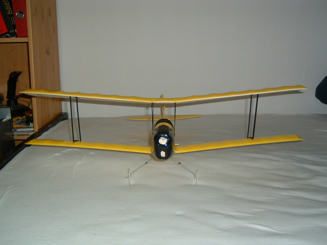

Hi folks,
This is my first post in this great forum and community. I'm from Switzerland (Europe) and I bought a Tiger Moth two days ago. Today I had the chance to fly it...but I got some problems:
1) At the first flight I had to trim the TM but...have a look at the picture, only with this trim, the TM is flying straight...why I have to trim it so much ?

Don't worry about the trim just fly it and enjoy it. I have had mine for about three years and have done every kind of damage imagineable and she just keeps flying, ugly trim and all. For the prop problem you want to run the nuts to the end of the threads closest to the motor and give it a good tightening with a lock nut on the out side. Try not to strike the ground with it on take off. Also get rid of the nicad and go at least to a 7 cell 300 mah NiMh, you will love this plane!

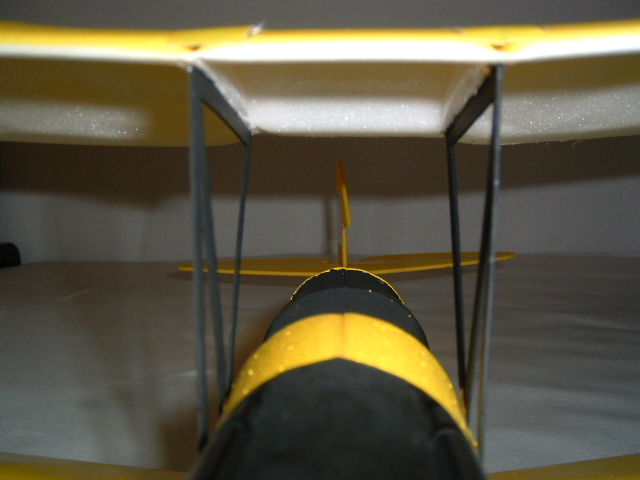

I got another "Problem" I tried to keep the dihedral angle at 80mm, but whan my Epoxy was cured, I noticed that the angle was only 60mm, should I leave it or do I have to "rebuild" the wing assembly ?

A little less dihedral will work just fine since the Tiger Moth has plenty of rudder authority.

I had the exact same problem with my DD 280 TM It needed lots of trim correction, it also did not turn very well. Forget replacing the prop and replace the motor with the ips geardrive, I think the gearing is the S1. As soon as I did this it flew great with no trim correction.
Yes I did try right trust to correct the trim problem, I beleave that the DD motor is no good for the TM the plane has too much drag. The bigger prop and geardrive gives the plane more thrust.
