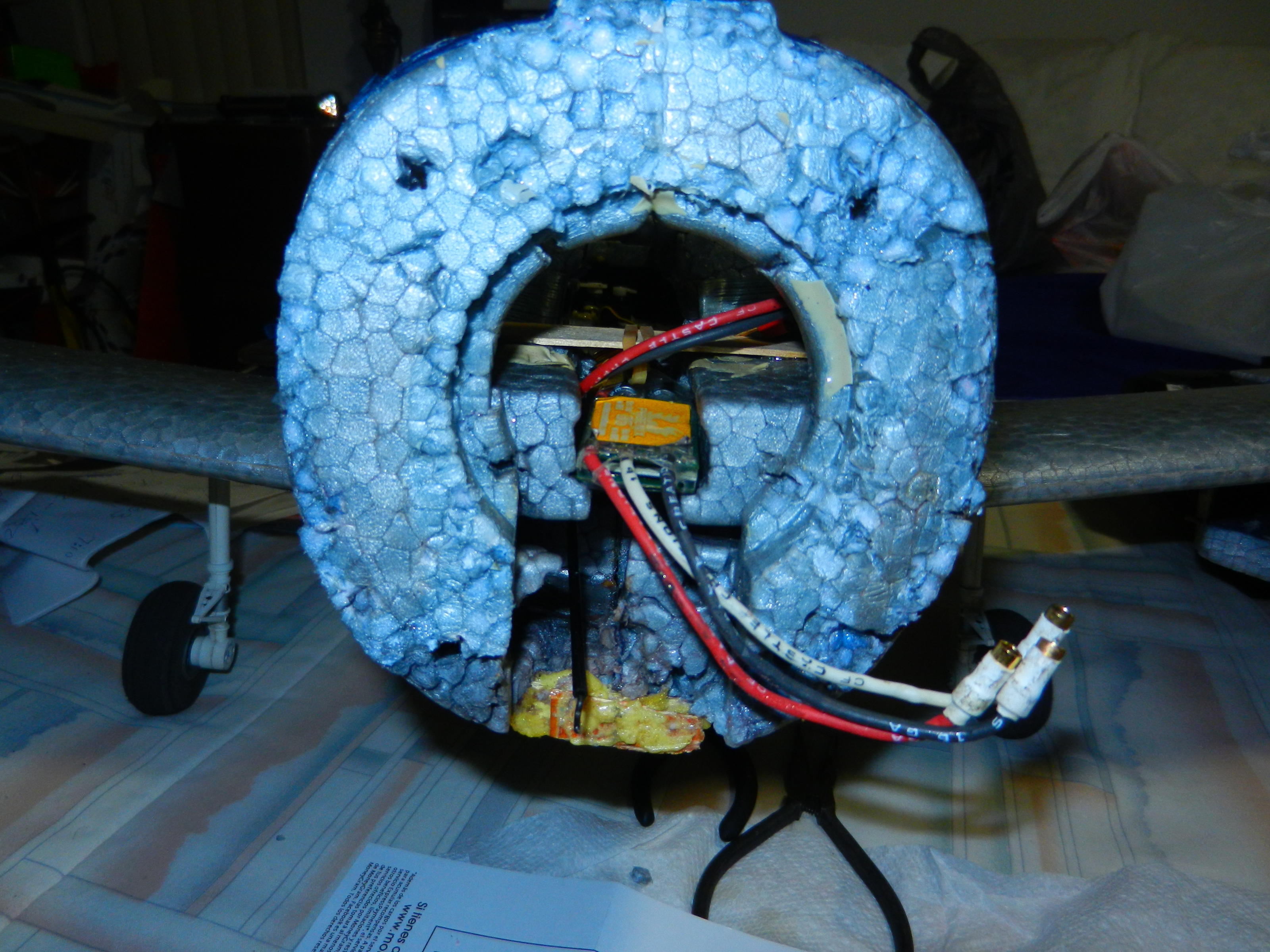

Okay, a super nice gentleman located one for my beloved T-28D "Airforce" Trojan!
My Trojan's Firewall finally got to a point of no return so, needed a newer one!
Received the Stock Plastic Firewall on Thursday, September 15th, 2016 and in perfect conditions.
I wasted no time and cleaned off / took off the rubbery glue and it looks ready for installation!

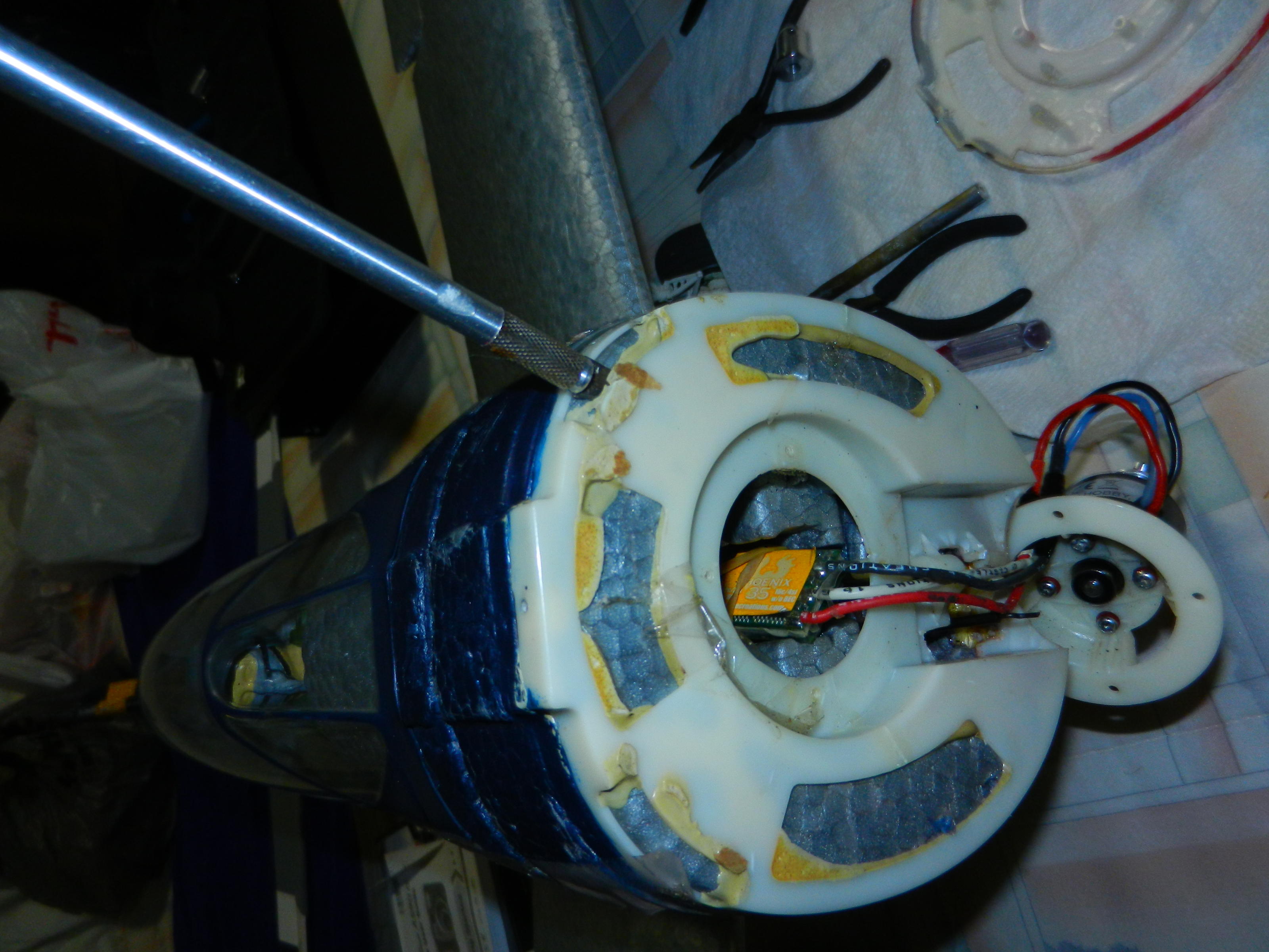

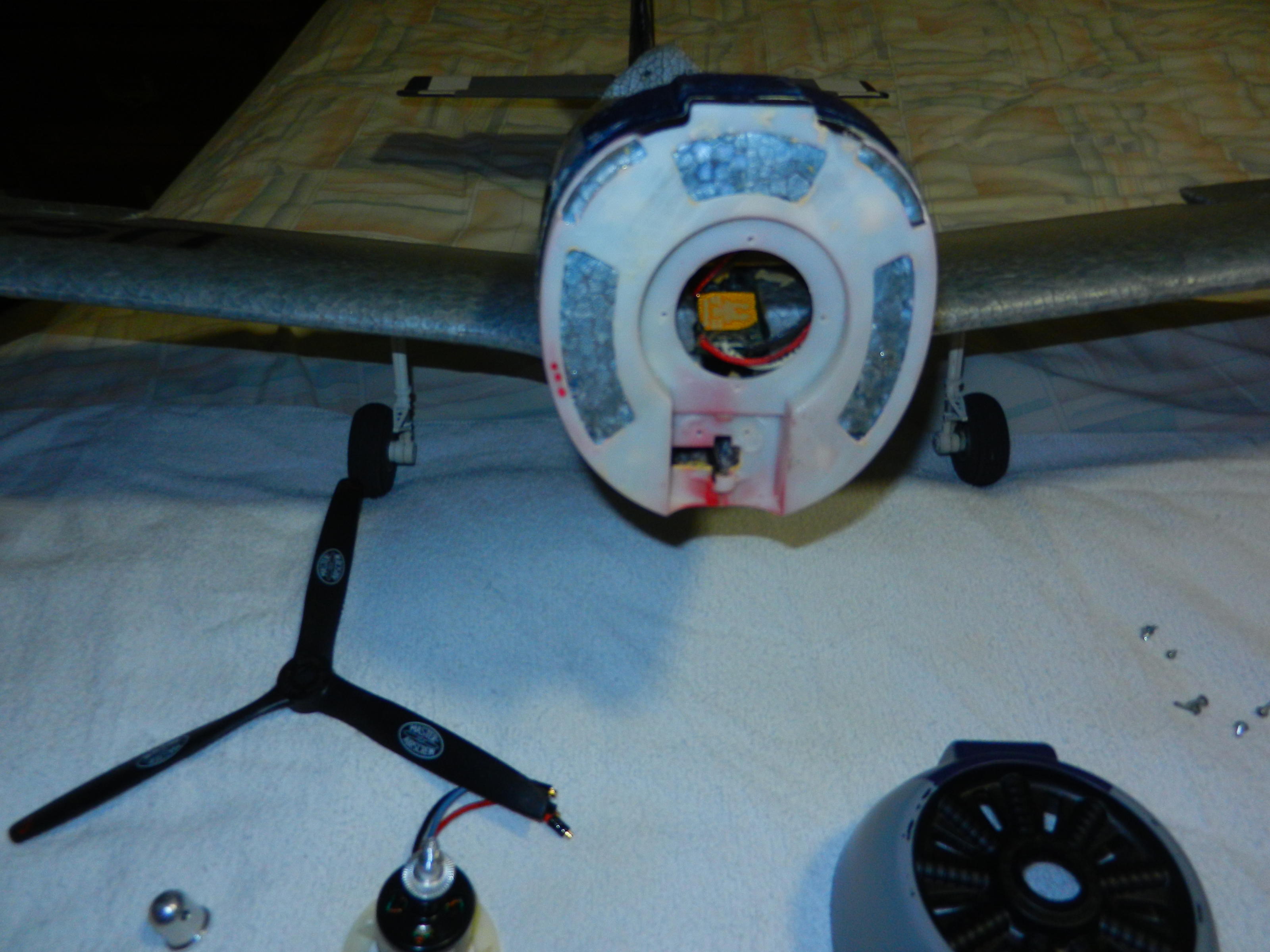

I finally had time last night and early this morning to finish my Repair Project with my Beloved Park Zone T-28D "Airforce" Trojan.
A few more cleaning tasks on the newer Plastic Firewall to remove the rubberized glue and a little sanding to remove the RED paint along the outside rim and presto!
Used 5-minute epoxy and set it over-night with a large Lead Acid Battery to provide pressure and it cured very well. Looks like new! (Well, Almost!)
A few pictures!

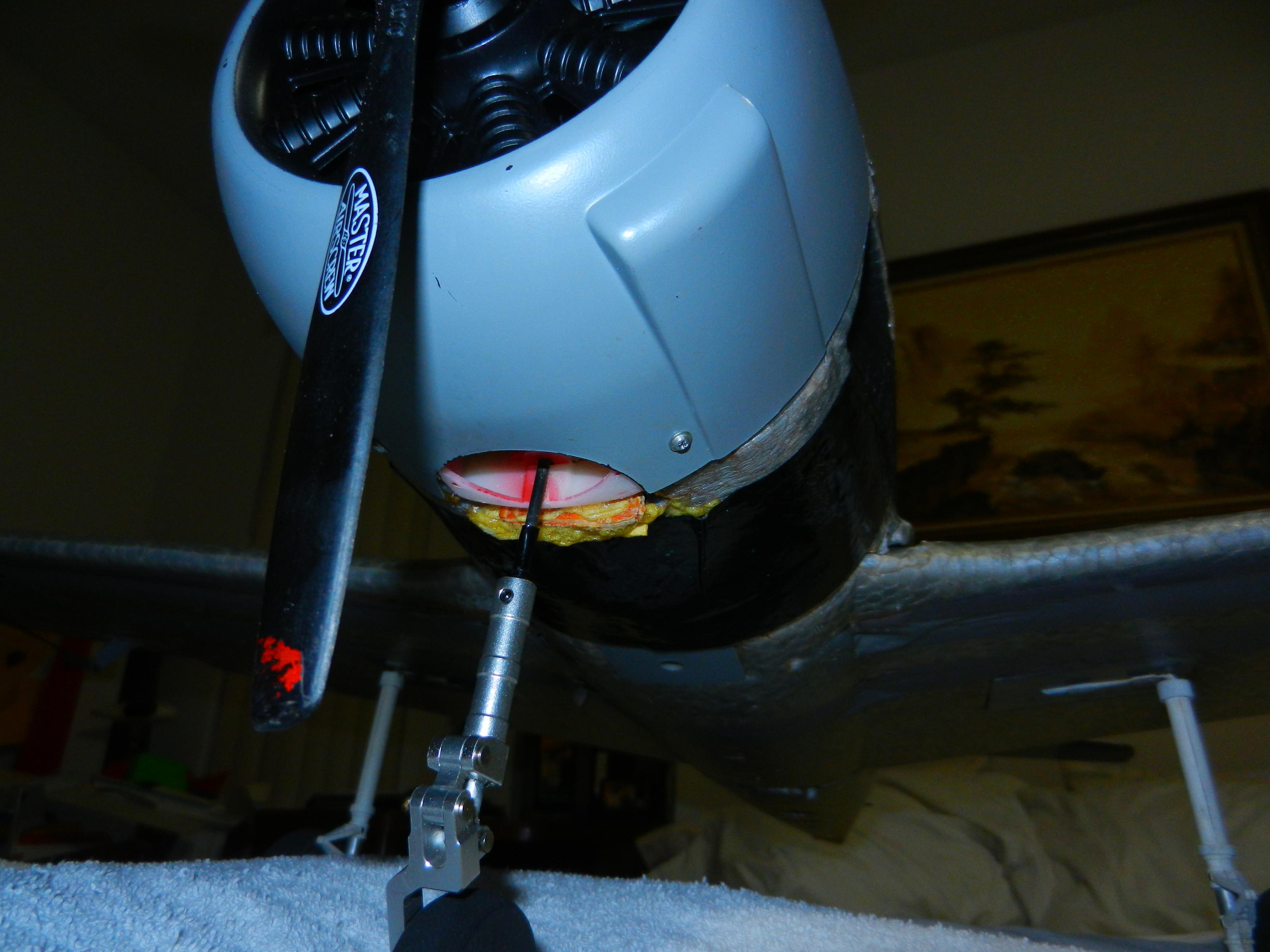

A few more pictures showing the completed repair!
