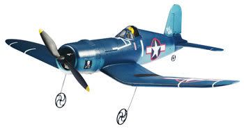

Default GWS F4U Corsair
I just ordered mine today is the ARF version with the ep400 motor included.! I want to listend to your experience with this bird. and what setting are u using on !! how much capable is in the air what kinds of maneuver is able to do and what mods have you made.
also I need your help setting up mine. I have a few radio system i got a 4 ch rx/esc one unit that have an 8cell 650 mah AAA type battery pack that use to power a ep350 motor on a cessna 4ch. also I have my Futaba t6exap system with 6ch reciver. if I go with Futaba I need the ESC wich I dont have.
for the batteries I have 3 diferent kind. Hobbyzone 7cell 1000mah, Tenergy 8cell 1400mah , no brand 8cell 650mah wich one will the best for this bird also how big is the battery compartment and what weight will be the best to get the best performance !!

You are not going to like any of my suggestions....
First, the good thing you have going for yourself is that the "GWS" Corsair is the RC model Warbird with the most Wing Area in the World War II RC Models and it will lift all that heavy stuff in your pictures.
I have three mustangs and one Corsair. All of which fly with Brushless and Li-POLYs.
Let me know when you are interested in making your Corsair light weight for much better performance and slow landing speeds.
