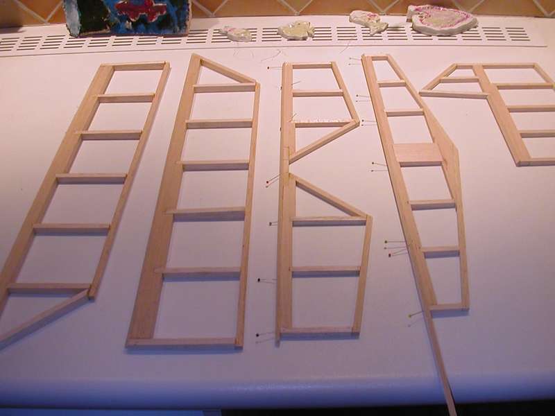

I decided to build the stab elevator assembly just to test my skills.
I selected the wood, the glues and the tools I think I will need
first question before I start : should I cut the spruce elevator joiner in the long 1/4 spruce part or is that piece precut and laying somewhere in the box (I couldn't find it in that case) ?
I decided to glue most of the frame with alliphatic resin glue except for the spruce joiner and the sticks composing the tips of stab and elevator that i plan to glue with epoxy resin for strenght
Am I on the right track guy's ?

I have'nt built my stab yet, so I dont know the answer to #1 for sure, but I think there are two peices of hardwood. One for the servo mounts and one for the joiner. I will check for you when I get home.
I am assuming you do'nt have CA type glue available in Belgium, but I would think the allipathic glue would work fine for the whole assembly and that epoxy might be overkill.
I think you will do just fine with the build, so have at it. I only wish my wife could see this wounderful hobby through your eyes, because you are truly an inspiration to all of us married Pro-Bros whose wives dont see things the way we do.

salmonbug has all the glue you can dream about in his workshop, but I decided to go with alliphatic glue so it gives me some time to react in case of mistake.

The beauty of this design is that you can cut all of the peices to fit bedore ever glueing. Then, you pin them onto the board exactically as they should be. When they are all lined up perfectly, put a drop of thin CA at each joint and voilla, it'll be perfect. Try it. Would'nt it be funny if you built and covered better than salmonbug lol Then, what would he do. lol

I admire your courage in undertaking this project. I personally would be overjoyed if my wife would build an airplane for me.
I think you'll find a lot of good advice here. But unfortunately I have not built this plane yet. (I have heard good things about it, and it is at the top of my wish list) So I won't be much help with your question about the 1/4" spruce elevator joiner. Although having built several kits of this nature, I would guess there is a spruce stick or two in the box that you will have to cut to length to match the plan.
I would guess that Mr. Swany is flying in Houston, Texas this weekend. And will be along in a few days to answer your question directly.
Glues on the other hand; are a matter of preference. Alpha tic resin will work, as well as the epoxy; but I don't have the patience to work with them. Their set times are too slow, and there will be a lot of mixing with the epoxy. I feel they are also heavier than CA. (Cyrano acolyte)
I prefer a bottle each of thin and thick CA and accelerator. You are able to pin most of the assemblies to the board apply a few drops of CA to the joints and shoot it with the accelerator. In a few seconds the assembly is ready to remove and sand.

my tough was that in the case of a structure like the burito (all sticks) the use of a glue with good gap filling properties was a good idea for the case you slightly miss the triming of a stick. the alliphatic resin will fill the joins better than CA and result in a better structural integrity, that's my opinion of stupid girl
for the weight consideration I have to say that i didn't tough this was so important. Will the plane be out of balance and unable to fly????????[]
my choice of allyphatic glue come also from the fact that I am in charge of the final sanding and covering of all the airplanes my husband build (salmonbug has very bad tastes for color scheme) and my experience sanding structures showed me that it's very difficult to obtain smooth regular sanding in aera containing "blops" of CA, the dry CA is much more hard than the wood !, you don't have that problem with alliphatic glue

ok, and let me know if you obtain something like this.......
I worked 3 hrs on it
I am not very concerned about the spruce sticks anymore because I found a dozen of identical ones in my husband reserve of wood. also balsa ones, this make me more confident
my major problem is that i don't find the assembly manual. I guess that he is with the other manual in my husband library, but he locked his office and is out of the house for one month[]

You're doing a fantastic job! You can download the manual at Swany's site here:
[link=http://www.swanyshouse.com/burrito/burrito.html]http://www.swanyshouse.com/burrito/burrito.html[/link]
Also, look at this thread if you have questions:
[link=http://www.rcuniverse.com/forum/m_1170617/mpage_1/key_burrito/anchor/tm.htm#1170617]http://www.rcuniverse.com/forum/m_1170617/mpage_1/key_burrito/anchor/tm.htm#1170617[/link]
latch66 did a great job documenting the build. His was an early run kit, so Swany fixed a few things. Go off the manual first, then look at latch's thread for more pictures.
Good job!!!
No. You'll be OK. It will just add a slight amount of weight....probably won't notice. Just don't get too carried away with the glue.

The 1 1/4x1/4 peice was for the joiner, it has to be trimmed. I was thinking about the glue situation and I agree about the sanding. Use the thin CA to attach the peices and use the other glue to fill any gaps that you get. Like quicker said, we are there for you and you are doing a great job. You will make your husband verry happy with this plane.

what do you mean by "trim" the elevator spruce joiner? the only think I did was to cut it to lenght and then sligthly round two of the corner so it fit perfectly in the curvature made by mister Paul's CNC machine drill bit.
is that correct or was it something else to do ?

Your build is fine so far. Build the fuse next, then the wing, which is the hardest part of the kit. Even it is not that hard, though.
