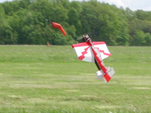

Here's my ETaco. Here's the setup:
AXI 280824 Outrunner
Jetti Advance 40p ESC
2 Kokam 3 cell 1500 mAh Batteries
It's got good power.. But it's not half the bird Chuck Auger came up with...... Hopefully he'll chime in here and lay out his setup.... I really like the mods he came up with for the airframe.... I'll be incorporating those changes into the ETaco kit.... He got his covered airframe down to something like 7 oz.!! He nixed the fiberglass rod and ply motor mount, use a CF tube that goes all the way to the motor. Then he nixed all of the sheeting on the wing.... Really nice setup.... Very well done.

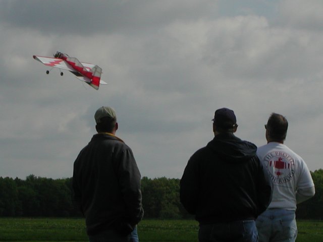

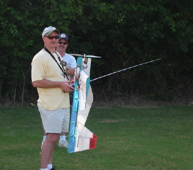

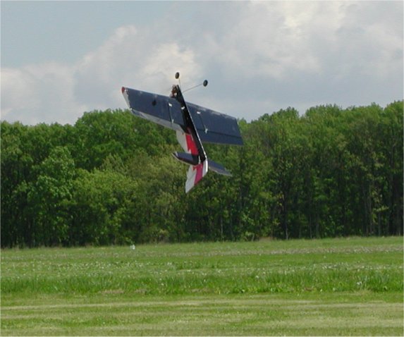

Here's some info on Jeff's ETaco:
Some pics of a radically altered E FF Taco. AUW 25 oz.
Lehner 1020/15 Phoenix 35
Cobri aluminum gearbox 12 tooth SS pinion, 70 tooth spur
12X6 APC SF prop
Tanic 3S 2600
Berg 5
4 X Dymond D200 Servos.
It was an amazing combo, lost to a midair on it's first evening out.
