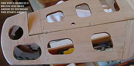

Here is a picture of one of my SE's with the elevator mod.
The added tip counter-balance lessens the chance of flutter, lessens the strain on the servo and makes the elevator 3 times as effective.
On the next SE I did the above AND added a 1/2 inch strip to the front of the elevator to make it wider!
