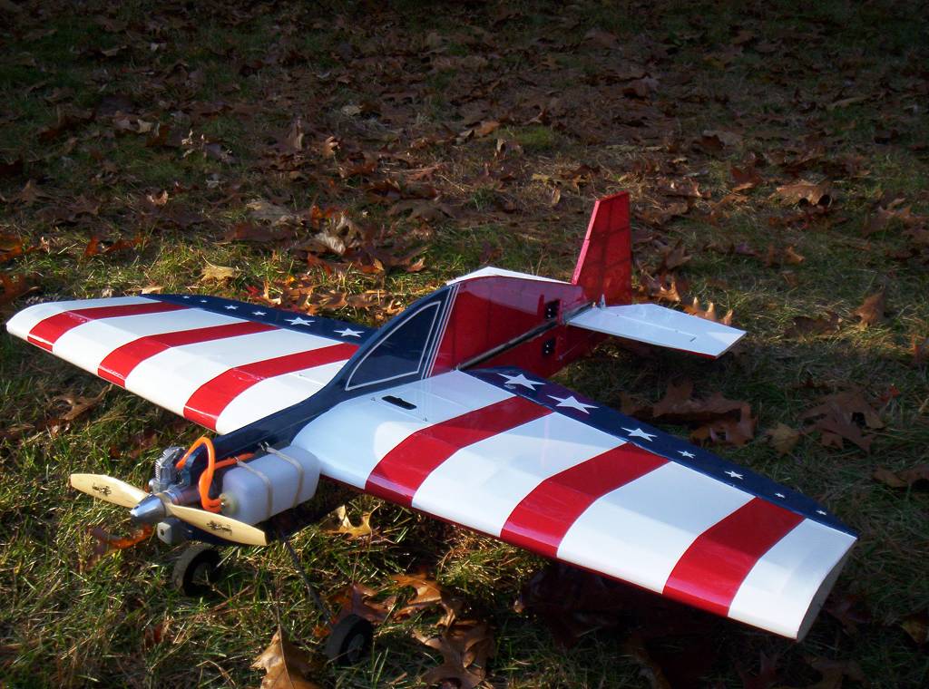

Default RE: Looking to get into 3D
FYI, the Evolution engine that comes with the Alpha 40 is actually a .45 size engine, but I don't think it's tuned for high power output. Mine's been a great, reliable engine, but it's power to weight may be a bit lacking for 3D performance.
I have a .55AX on my Mojo 40 and I love it.
Good luck. You are definitely headed in the right direction.
PS: Don't be afraid of building a Mojo from a kit. It is a really easy build.

If you can...built the Mojo and you will have the experience needed to repair it (eventually when it finally needs it) and left over covering. The insight gained from kit building a Profile goes long measures in someone being successful with it!

I agree. Building from a kit is the way to go. the arfs from OMP are really nice and I've had a couple. I had the little Edge forever. The thing just wouldn't die. But repairing an arf can be daunting. And the bumps and bruises that go along learning 3D will force you to face this. If you take a few days to build a Mojo, that's right, a few days, you'll know everything about the airplane. You'll have the confidence to tackle any repair job. What's more, you'll be able to maintain it because you'll know what's going on inside the thing. And when you do need to make a repair, you'll be able to make it look like new because you'll have covered and finished it yourself. Truly the way to go.
