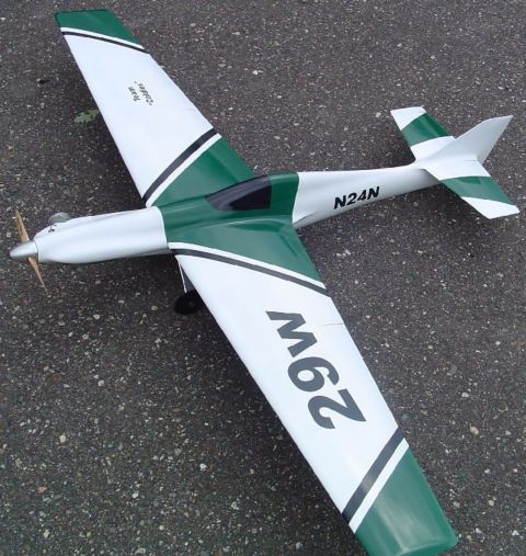

The Nats are sneaking up, and I still only have one somewhat flyable Q40 ready to go. I've been looking at this Polecat for a couple months and thought I'd get started working on it.
My first thoughts are "Very Impressive"! I got the servo tray, elevator, rudder, and throttle pushrods set up today. I trimmed and fitted the small fiberglass pieces that fit around the engine and the landing gear, and they fit great. Cut my holes for my fuel tank, and checked the fit of the engine. I noticed neither the Tetra or Jett C.G. tanks don't seem to quite fit under the wing?? After checking with Dub, it turns out he has a new "PoleCat" tank that clears the wing which I got on order.
I lightly dusted it with Primer tonight, and hope to get some paint on this thing by the end of the week...

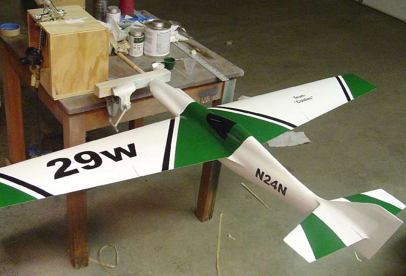

Painted up the fuze last night, and hope to get to the wing tommorrow.
Dan Kane did a great job getting this plane ready for paint (thanks!).
I have been using 2 part epoxy paint from www.klasskote.com and have been very happy. I am not a good painter, and this stuff just looks great. I got some stencils ordered from Jim Allen, and hope to get it trimmed out with numbers by this weekend.
When you mount the engine, and fit the fiberglass engine cover, this thing looks scary fast. I can't wait to fly this thing.

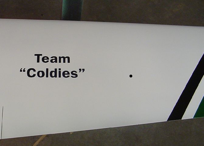

I painted the black trim and numbers on tonight. I will say, Jim Allen's Stencils work great. Had to throw it together for a quick picture. Still needs to get clear gloss tommorrow, and hopefully a test flight on Sunday or Monday (if it stops raining).
I can't remember being this excited to fly a plane.

I added some tape to the second tank. It was kinda weird with Stubby tank, its made of a different material (clear). I thought I could get it back out, but it was a pain trying to get a handle on it (slippery).
The C.G. tank ended up working fine. It came out a bit nose heavy, so I needed to move everything back. Snug fit, but ok.
The whole plane is painted and cleared with KlassKote 2 part Epoxy paints. I know I've mentioned it before, but I really like this stuff. Plus they got a great shade of green. The paint is fuel proof as it is, but the clear helps smooth out the paint lines, and I could tell it needed the extra weight. If you liked the old Hobby Poxy paints, you will like the KlassKote, also their catalyst and reducer work in most cases with the Old Hobby Poxy. There are NO trim colors on the bottom, I left it solid white.
