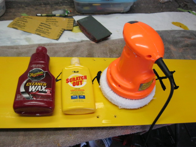

The clear coat was wet sanded first.
This was followed up with a polish and wax.
I'm planning to make some test flights this weekend.

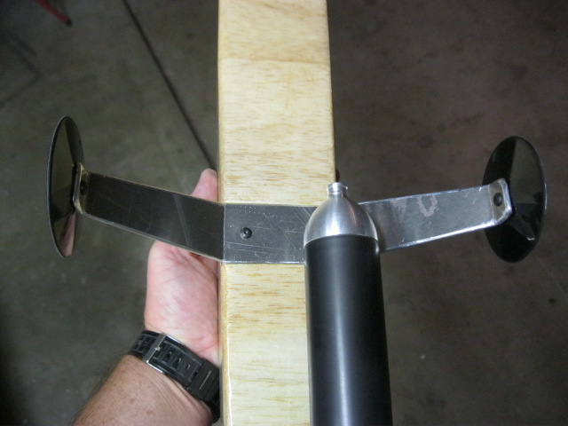

The edges of the landing gear were rounded with a file.
Pizza cutter wheels were installed on the gear.
The gear was attached to the fuselage.

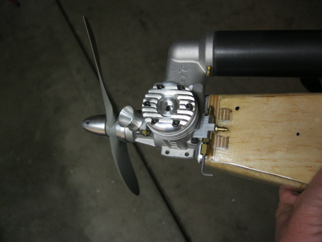

The engine was fitted to the motor mount and attached to the firewall.
The black dots show where the tubing holes are planned.

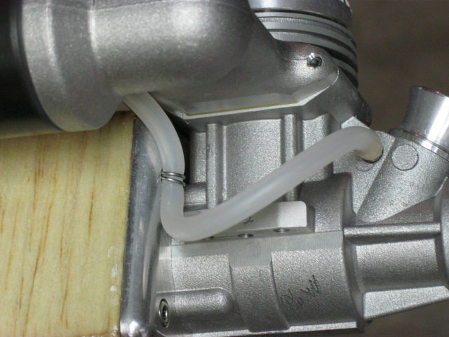

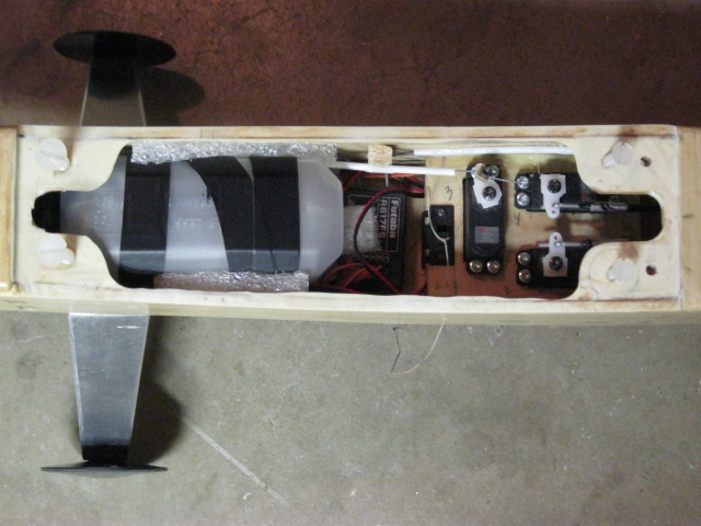

The engine kill, tank, and tubing were connected.
The Sullivan 3/32" ID (3/16" OD) diameter tubing is the perfect size for the engine kill.

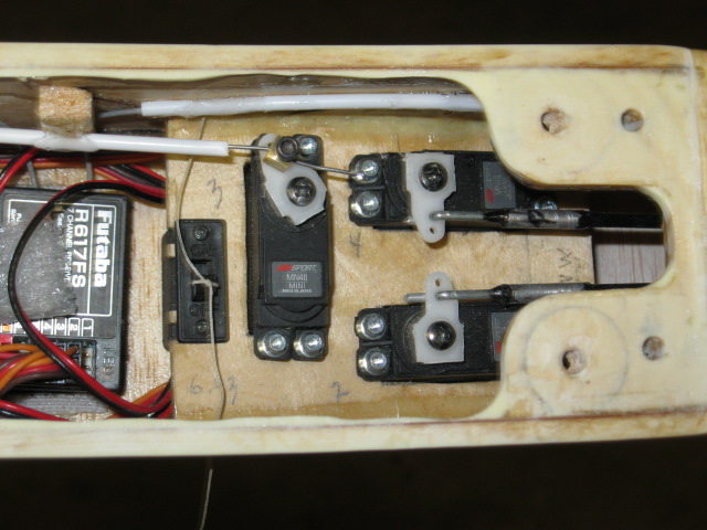

Here are a couple shots of the tank and radio installation.

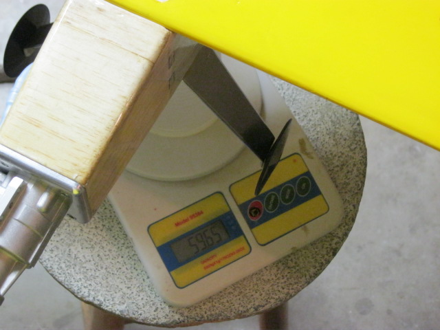

The completed 426 model weighed a little light (59.65 ounces). Sixty ounces is the minimum weight for a Q500.
The wing was actually relatively heavy (21 ounces) due to a painted finish.
The fuselage and engine were light and resulted a lightweight model.

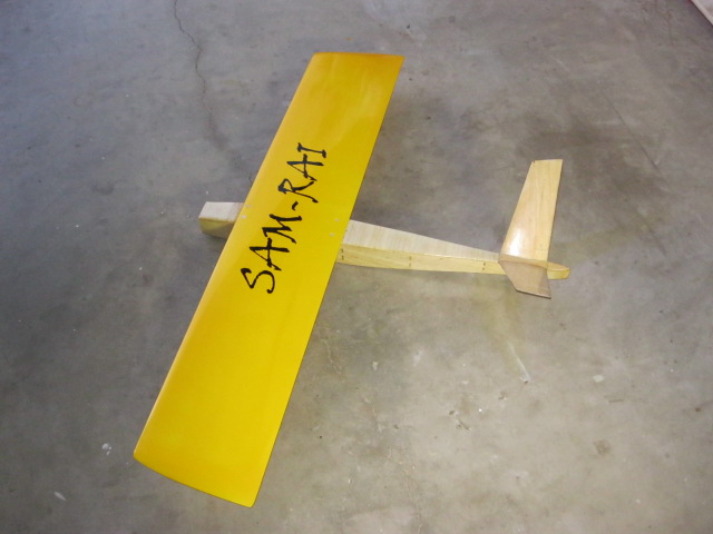

Here are a few pictures of the completed model.
With a little luck I will fly it tomorrow.

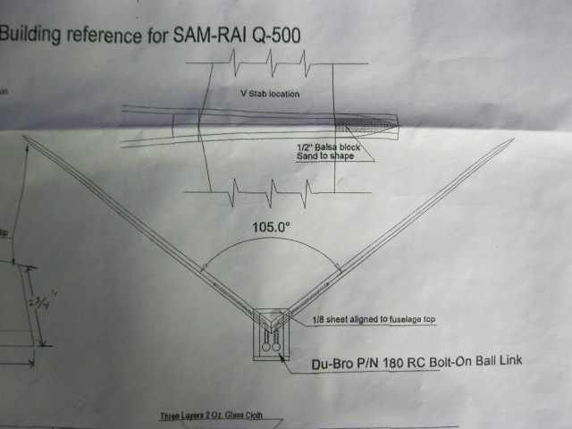

Here are the measurements on the tail.
