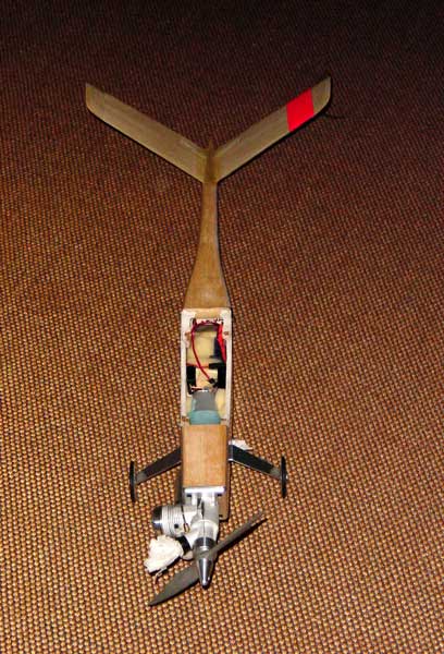

First test-fly
Wow!
First test-fly today. It flew great and I have never experienced such speed before. A fantastic feeling!
I was surprised it was so easy to fly. I ended up with the CG at 2 7/8, which felt perfect. It was very silent in the air, which I guess may indicate that the aerodynamic design is not a total disaster.
Rough timing showed 6.8 second laps, with a Nelson running rich and a low pitch prop.
Thanks for all your advice, guys!
