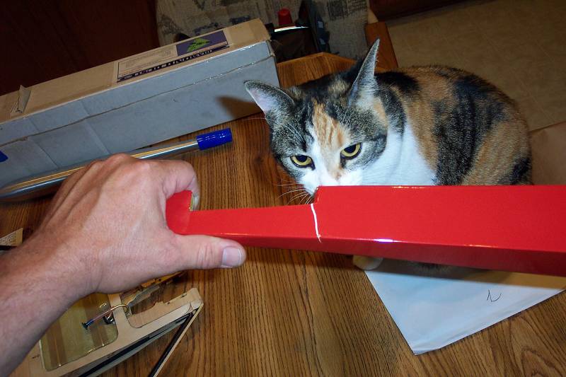

Good Idea, I've had two Viper tail failures in the past year with the total loss of both aircraft. Now I always reinforce with fiberglass or just build another tail. After the second failure I sent the remains back to Tower and they replced it free of charge. A good company.

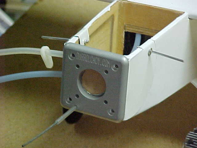

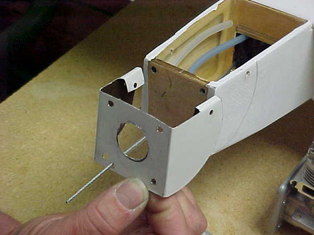

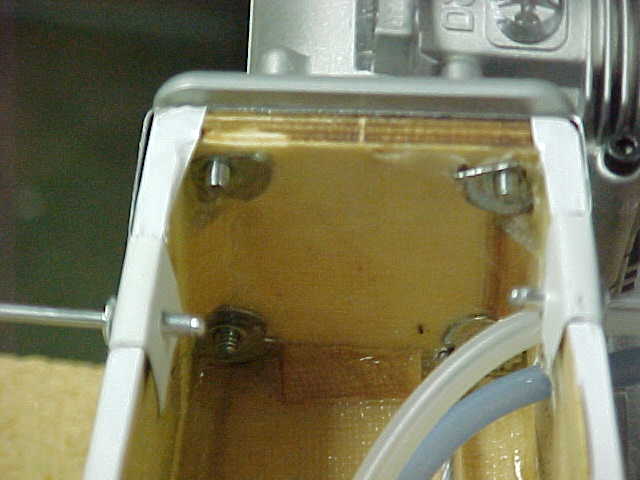

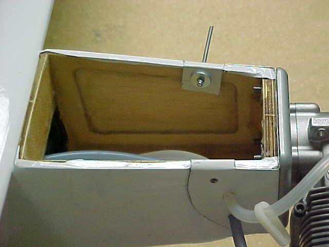

Here's a motor brace we made for the nose of the viper. It's made from .012 Aluminum Flashing that you can get at your local hardware store.

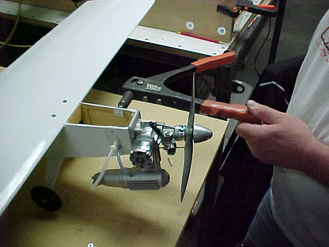

The most important thing you can do for the firewall is epoxy down the fuel hatch cover. Don’t screw it down. Even better, replace the balsa cover with glued down aircraft plywood. Remove the covering material in the glued area on all 4 edges for 100% contact. This forms a very strong box structure VS a channel. . Its funny how may people want easy accesses to the tank and ignore the instructions, I can’t blame them.
The second reason that the firewalls fail is that some guys spin up the starter, than slam it into the spinner nut sometimes misaligned, shaking the heck out of the poor plane.
Back the prop off compression so you get some momentum, line up the starter on the spinner and push the switch....much less violent.
Pictured, is a new in-box fuselage with the tail pre-broken. I removed the covering around the area applied medium CA in the crack and held it closed than carbon fiber strips were added high on each side and one on the bottom.

i must say very nice job on the motor brace but having only 2 fixing points [ rivets ] is not enough. if this was made in a box type section and fitted with say 4 x rivets [ 2 top and 2 bottom the strength would be much better. with the latest model Vipers they have added fibreglass cloth around the front and side outer fuse engine area plus f/glass to the inner mount and tank bay, what i now do for more strength is epoxy the front top hatch on then pin all 4 sides with 2 x 1/8th cane squers [ total 8 ] then finish with a wrap of light glass cloth , this has proven great strength with running Profi and Nelson engines from other club members .

The new batch of Vipers have f/glass on the inside and outside of the firewall. Its still not that strong enough. I needs to be beefed up. Mine just started to peel off. I opened it all up and find that the fibreglass is nonsense, is not flush in the corners. The balsa tri stock comes off with ease. Time to remove it all and fix her up again.
RE: Viper Q500 tips and techniques
One nice thing with the new ARC Viper is all of these mods can be done without having to pull off the covering. What a great offering from Great planes. We use these in local 428 as well but they do need some strengthening here and there. I did have a wing blow off with the Nelson on it. The wing mounts probably need to be looked at as well.
As for electric starter damage, at least for 424, I start mine by hand. I am a CL flyer though and electric starers are not only hard on airframes but engines as well when not properly used.
