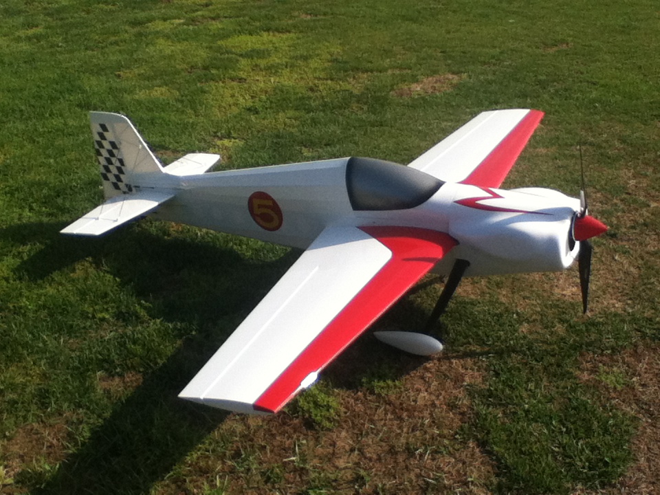

i have a C-G chipmuck that i build years ago and havent flown it until now it has a OS-61 siding side ways when i take off i have to give it a lot of left rudder i got the toe set in ,is it because the motor is sideways ? thanks rye

Don't think so. I think it's cause it's a tail dragger. You can cut down on this tendency by slowly advancing the throttle and not slam it open all at once.

Has nothing to do with it at all. The reason for pulling is called the P-Factor, the way the vortex wind is hitting the rudder. Most people will just call it Torque just to keep it simple. As mike pointed out, if you roll on throttle a bit slower and add some right rudder as needed it isn't any problem at all, it's normal for most planes.

Many things cause left-turning tendency, and they all inter-relate.
P-factor, also called assymetric disc loading, is most evident during slow-speed, high angle-of-attack flight at high power settings. It's cause is from one side of the propeller disc producing more thrust than the other. In our case with clockwise-turning props (viewed from the cockpit), the right-hand side of the prop has a greater angle-of-attack, so the plane tries to turn left. Also called 'prop-walking' in boats
Gyroscopic precession, sometimes called torque precession, occurs when the prop is moved from its plane of rotation, and the effect occurs 90 degrees from where the force was applied. In a taildragger, as the nose is pitched down to raise the tail, the 'push' is applied at the top of the propeller and the resulting force reacts 90 degrees clockwise (again, from the cockpit) to the right side of the prop disc, causing a yaw to the left. The opposite occurs in nosewheel aircraft; as the nose is raised, there is a bit of right yaw but it's negligible as the other factors counter it.
Spiral slipstream effect is what GB correctly pointed out, the spiral propwash striking the left side of the fin and rudder, also causing a left yaw. The slower the airspeed, the tighter the spiral and the greater the effect. It's present even during cruise flight, and many single-engine full-size aircraft have offset vertical fins to counteract the effect.
Engine torque also has an effect, and it's more pronounced in full-scale aircraft. Quickly increasing the throttle can cause a roll and , in the clockwise example given, a left roll can result. More pronounced at very slow speeds. My Multiplex Funjet rolls left during handlaunch, and I've read that a fullsize Bearcat will roll over on its back if the throttle is suddenly advanced.
P-factor and gyroscopic precession are the biggest culprits for us. Add power slowly at takeoff (3-5 seconds from zero to full).  As the aircraft accelerates, the tail becomes more effective and will help keep it straight. Make slow pitch changes also, for the same reason.
On the more powerful fullsize twins I fly, adding power too rapidly will cause the aircraft to turn left and depart the runway. No amount of brake or right rudder will stop it. Slow, smooth inputs are the answer.

forget the arguing about pfactor. just make sure your gear have the same toe in. use long sticks of 1/4 sq balsa and then look from above the plane to see if one side has to much. Also make sure the wheels are free to rotate. then check to make sure you dont have to much right thrust. it all good and still does it then get better on the rudder or by a gyro lol

Suggest looking at a thrust line issue.

The rudder is yaw control on the ground and in the air and what you are experiencing is left yaw caused by all the things discussed interacting to some degree. Taildraggers, depending on the design, size, engine, prop, scale shape will experience more left turning tendancies on take-off than a comperable design, size, etc. tricycle gear airplane whether model or full size. Some designs are better at handling all the left turning tendancies and a mimum amount of rudder input is required most of the time where others (like Cub) require vigilant rudder use, but either way, it's a learned skill and no amount of mixing or preset will work precisely on every take-off run.
Another thing to remember is that the rudder doesn't become effective until a certian amount of airflow (spiral or not) is flowing over it. Again, some designs are better than others so you have to figure out what works for you. I lost count of the number of times my 80" Hangar 9 J-3 Cub when roaring off to the left and cartwheeled through the tall grass before I started to get the hang of it. Getting my private pilots licence a few years ago brought a lot of insight into my model flying and the model flying helped with learning to operate full size.
Every take-off and landing is a unique experience where you have to balance speed, power, angle of attack and energy to make it work the way you want and not just be along for the ride.

You don't have any or enough right thrust on the engine. Add a couple of washers on the left side between the engine mount and the firewall. jmpups
