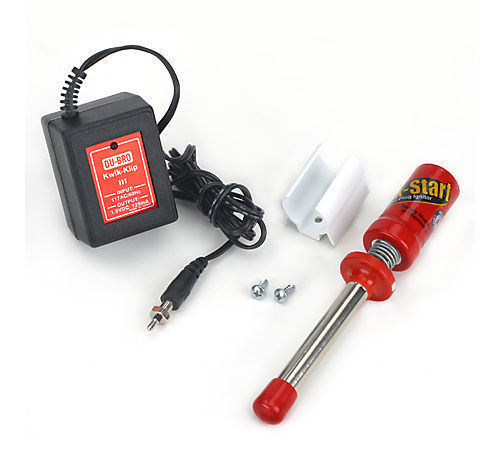

Besides a glow starter like the picture below and an onboard ignitor is there any other way to start a glow engine on a plane?

If you hand start your engine then a glow stick that you show above is good. I like the short ones as they are less likely to fall off.
If you use a 12 volt starter a 'powerpanel' like this http://www.hobbytown.com/Shop/Hobbic...ower-Panel-II/ mounted in a flight box provides a 1.5 volt supply and you can see that the glowplug is drawing power on the meter.
Sport flying I might use a glow stick as I almost always hand start my engines. For competition use I would always use a 12 volt starter and flight box with a powerpanel.

If I understand the way the question is worded the answer is NO....,,,,,,,well sort of.
In order to start combustion you need heat. The glowing "glow" plug provides that heat to start combustion. In order for a cold plug to glow it needs voltage applied to it either from a glow start stick or a power panel as ,mentioned.
When a glow engine is very hot it can start without powering-up the glow plug. I and others have had that happen however all the conditions need to be right for it to happen.

1.5 volt battery and two attached wires with alligator clips on the end?? Not sure about the question, a heat/voltage source is needed to ignite the glow plug so any way you can get 1.5 volts to the plug with a ground will work.

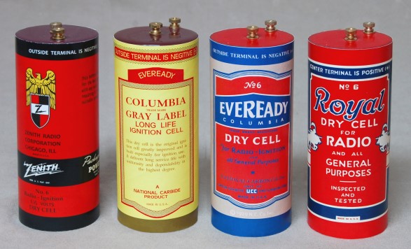

Those are modern glow drivers Steve is showing. Back in the really olden days we had a dry cell battery that was 1.5 volts and we just attached two wires to the top of the battery and had two alligator clips. One went to the glow plug and one went to anyplace on the engine you could attach to for the ground. The new glow sticks really make it easier.

Brian, too cool. I think it was RAYOVAC that had a cat jumping through a circle too?? Those were the days we bought kits from the local hardware store. Nice trip down memory lane.

I used those back in '73 when I first started in RC.. Went through quite a few !
There was a place that repos the batteries but it looks like he only sells the labels,tops, etc.. now:
http://www.radiolaguy.com/info/Vintage_Batteries.htm
