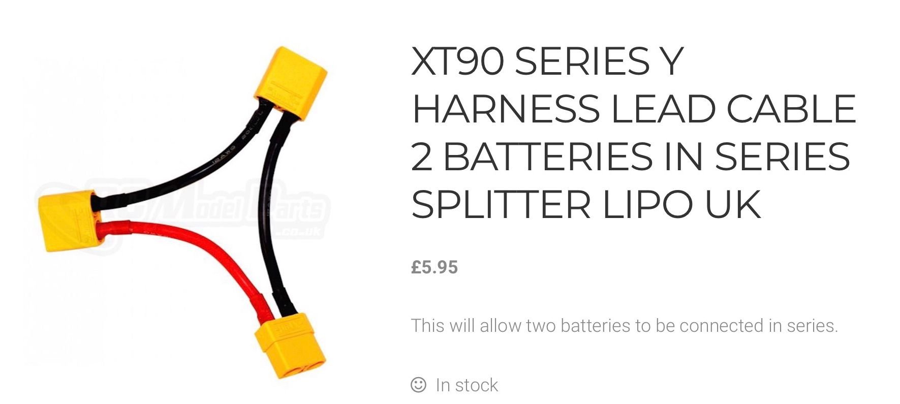

Adding just a few inches is not an issue. I have a couple airplanes that run dual 5s 5000 mah packs. I use a Y adapter to hook the batteries in series that adds about 4" to the length. This power system generates roughly 2,700 watts so yours should be just fine. I would suggest making up an extension that just plugs into place.

using a y adapter is not wiring your batteries in series. That is parallel. Remember voltage is series is additive.
I said SERIES and that is what I meant! Two 5 cell packs in series to make a 10 cell pack for a 2 meter pattern airplane. I really wish people when confused would just ask a question rather then assume the other guy is wrong!

sorry dude...but unless you reverse polarity on one of the battery leads a Y is parallel. Am I missing something?

Yes you are. A Y can be made up to be either series or parallel. As illustrated above, Castle Creations make them in both configurations.

Series or Parallel. I’m using one in series too.

Default Oh
a reversing Y. Makes sense, didn’t mean to ruffle your feathers
