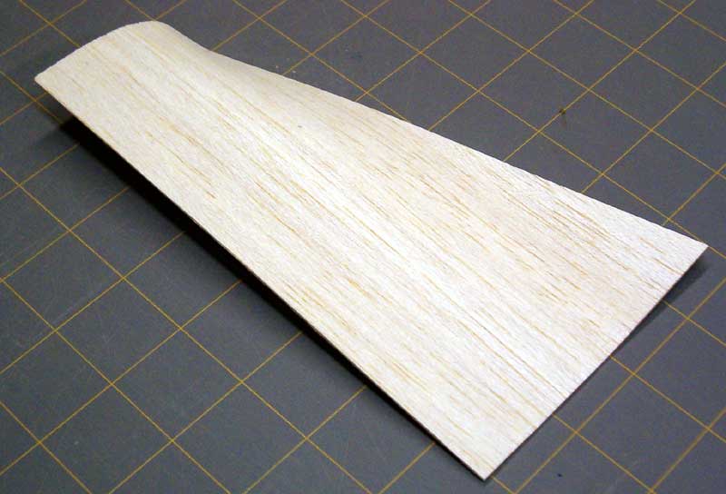

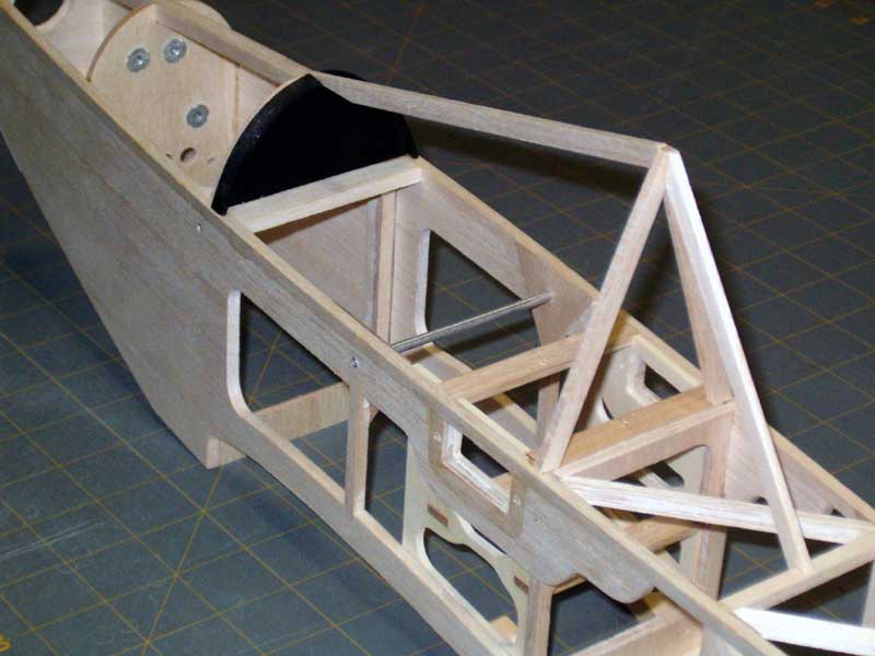

The sheet of wood shown here is 1/16" balsa. I ran it under hot water for a minute or two and then bent it into place. It's just being fit right now - no glue is applied. In fact, the front former is not what it gets glued to. There's another former that is identical to it that is glued to the back of the one shown.
The sheet bent into shape easily, but isn't quite right in the photos. There will be a stringer going from former to former for the sheet to glue to. Once the sheet is glued in place, it will be sanded flush with the stringer and another piece will cap the joint so that it's clean and strong.

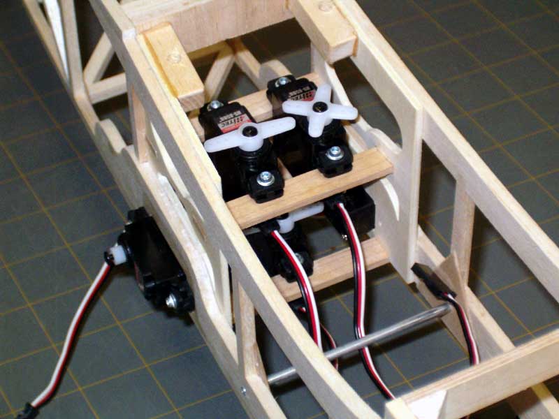

Oh yeah, the other two photos are not related to sheeting but I thought I'd show them just the same. All 5 servos are mounted in the center of the plane keeping them close to the CG. I expect this model to move easily about all its axis. About 500 inches of wing (biplane) and 40 ounces or less all up weight.
If it ground loops, the wings will be totalled. They're very delicate.

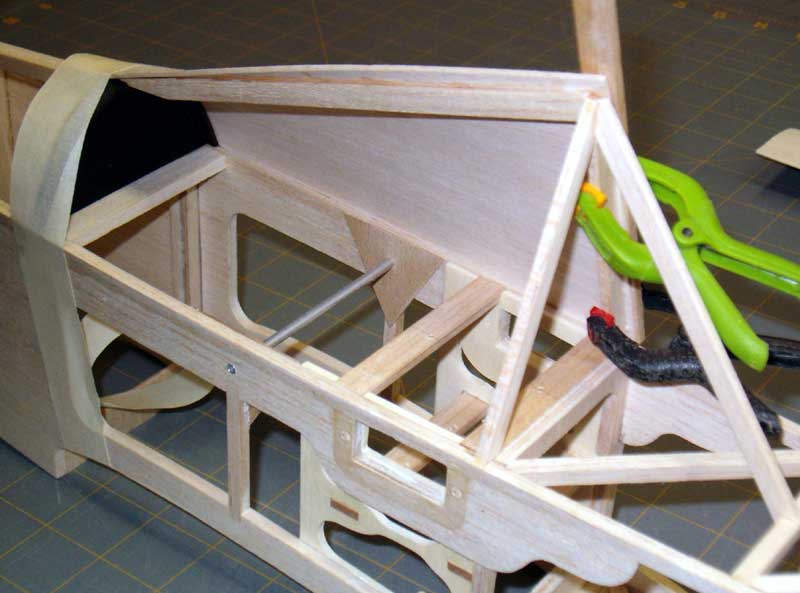

A few steps further along. I did the exact same thing with both pieces and let each dry in place. They are now "molded" to shape. I've just glued the first one on. When it's dry, I'll trim it and glue on the second piece.
If I had tried to bend this piece while it was dry it almost certainly would have cracked.
Every time I've had problems bending balsa it was because I was impatient and didn't work slowly enough when bending it or I didn't let it soak long enough to be pliable or I used the wrong grain of balsa. That last one isn't often true. Normally it's me trying to make the wood take shape too fast.
Anyway, hopefully this helps WILDCRASHWILLY with whatever it is that he's working on. Balsa is amazingly pliable stuff.
Last thing... use water base glue whenever gluing a piece on that needs to be bent. If you find out that the balsa simply won't take shape, then remove it immediately and use a wet paper towel to remove the glue.
Better to start over than to force a bad situation and have even more problems fixing it later.
