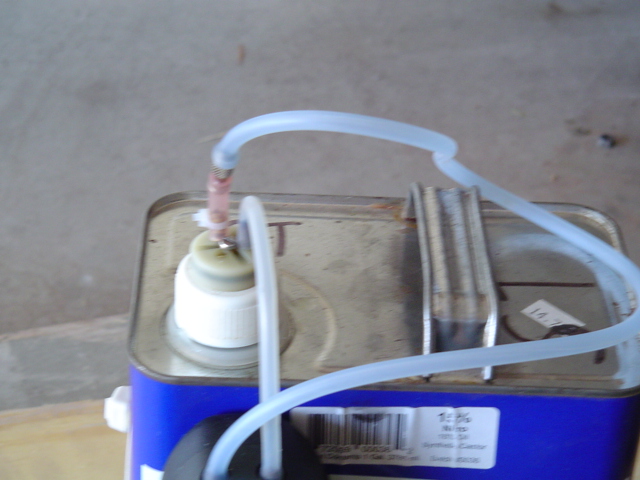

Try this way. I used a stopper and brass from a tank out of a crashed plane. I have a few of them just laying around. I just used an knife to cut the hole in the plastic fuel can lid. Then installed it like it was on the tank. The hand pump is zip tied to the can with a little two sided tape behind it. Works great and was free.
