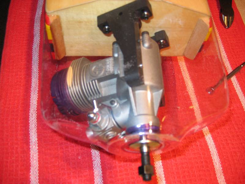

Putting together my aeroworks Edge and was getting to the cowl. With a Tower 75, the engine fits very nicely inside the cowl, such that I can either use a remote glow or cut a small hole for the glowdriver. My question is whether there is enough cooling over the head to avoid cutting a hole in the side of the cowl for the head? In the 1st pic, using the clear cowling you can see the position of the head, while the 2nd pic shows the two inlet holes in the front of the cowl. Wondering if those holes alone will provide enough engine cooling.
RE: Is this enough engine cooling?
For PROPER cooling you should use a 3:1 ratio. For every square inch of air inlet, you should have 3 square inches of air outlet. Depending on how cold it is outside when you fly, you MAY be able to get away with a 2:1 ratio. I wouldn't use this ratio for summer flying since the chance of overheating is greatly increased.
Thanks for the responses. I am not sure on the exit hole size, but it should be pretty big, as that's where the muffler will exit the cowl. I can always cut away a little more than I need to clear the muffler. Just seems like a waste to cut a big hole in the side if I don't need to.
A couple of suggestions.
Either block off or place a deflector in the cowl opening that's not in front of the engine. It's going to allow air into the cowl, but the air will flow right through and have no reason to go anywhere near the engine.
"Pressure cowls" are cowls that have all their interior blocked except for very close around the engine. They block completely except immediately next to the engines' cooling fins. They usually only use sheet metal because all they're doing is blocking airflow that would bypass the engine if allowed to.
Cool air is easier to move than hot air. Cool air is coming in the front, and if it runs into hot air, it simply goes around the hot air if it has a way to do it. You need to block those easy paths.
I'm including a couple of pictures of my Sukhoi. It's got a HUGE open cowl. I used 1" thick pink insulating foam board I picked up at Lowe's Home Improvement. It was very easy to work with. I filled all of the cowl that wasn't taken up by the engine and muffler. The foam also made the lousy-made, warped fiberglass cowl round again and gave it tremendously more strength.
You'll note that the opening in front of the engine is still huge. Sorry I don't have a picture from angles that'd show the exit holes, but trust me, they're not greatly larger than the "intake" area. The ratio of intake to exhaust only takes into account the area available to the air to pass at it's most restricted area. You can easily get by with a ratio of 1 to 1.5 if you block off the cool air bypasses. A "pressure cowl" design does that.

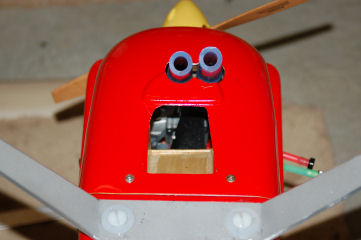

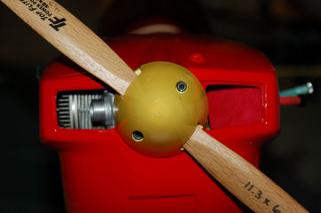

Here are some pictures to illustrate.
The picture from the front partly shows the baffle I placed behind the "worthless" opening. The baffle is about an inch back from the opening and is at an angle. If you could see it from the inside (sorry, but I didn't feel like pulling the cowl for pictures inside) it is glued to the top of the cowl and down the side.
There are two pictures of the bottom. One looks straight down on the bottom. The area of the exhaust opening, if measured at that angle, would be worthless. That opening could be hacked all the way to the tail of the airplane and it wouldn't do one bit better as an exhaust. The picture that looks up inside comes closer to showing the actual size of the true exhaust area.
I've guessed at the true area of the exhaust and it's actually maybe not even equal to the two intake openings. If it is larger, good deal. As it happens, I've been flying in the hottest days we've had this summer and that engine acts like it did in the spring.
BTW, one very easy way to block the offside opening would be to use screen. It's easy to fit, and easy to epoxy to the back of an opening like that.
The screen will allow air to enter, but once the other, unrestricted opening starts to flow, the screen-blocked side will be virtually closed.
However, whatever you do, if you do not block the areas inside a cowling that's got a lot of open area inside, the engine is not going to be cooled by the airflow through that cowl. Since hot air is harder to move, the entering air simply follows the other cool air that's nowhere near the engine, the cool air that's passing out the holes at the rear and that also never came near the engine.
