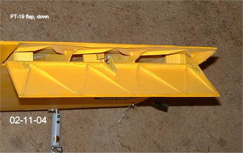

On my DynaFlite PT-19, I did it this way...
