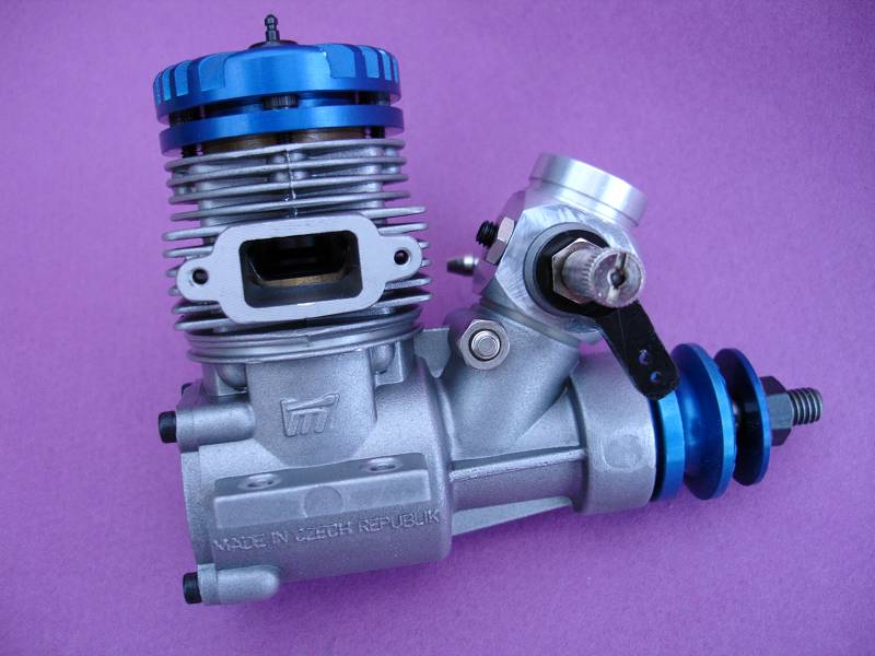

RE: Nitro methane replacement.
Hi!
Over here in Sweden some have tried 5% gas in the fuel and this works like adding 5% nitro ...at least so they say who has tried it.
Another way is to use engines that don't ned any nitro ...like Webra and MVVS.
