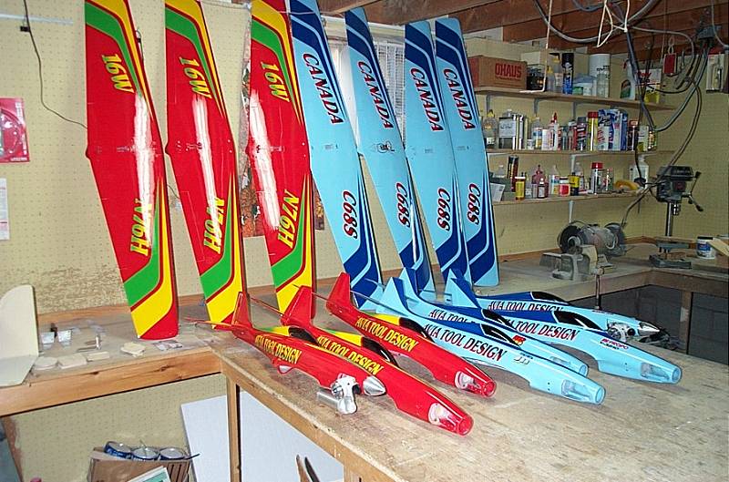

I use two types of automotive paint. One is called "Single stage" paint. I use the gloss paint. the base color has to be mixed with a catalyst. It cures to a high gloss and is fuel proof. If not too many trim colors are to be applied this is probably the best to use. It requires no clear coat.
The other system is refered to as "Base coat/Clear coat" The base color is just paint, no hardener is used and it has no integrity. Practility any solvent will attack it. This paint dries in about 20 minutes and can be masked right away. It dries with a flat finish. It is ideal for adding trim colors. This paint will require a clear coat. Hence the description. The clear coat is a catalysed material.
Both paints can be custom mixed to samples. The rang of colors is endless. Be warned though, automotive paints can be very expensive.

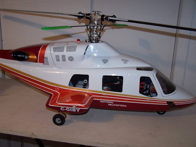

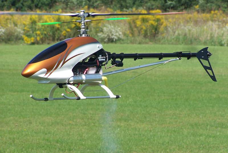

I use basecoat /clearcoat paints. They do a great job, but the down side, it's expensive.depending on the color, it may cost over $40 a pint for each color used. then you have to buy the primer/sealers, clear coat paint and the hardeners. They don't give those away either.
My basecoat is R-M Diamont Polyester, and the clearcoat is Limco LC4000. It does a terriffic job and is very durable. Adding plastisizer will help flexibility. The first pic shows my heli painted with the bascoat/clearcoat process.
I have found a quite suitable alternative to the expensive basecoat cost where you need multiple colors. My Bell 222, just recently painted used Createx air brush and Faskolor paints (both water based) as the basecoat colors. It is clearcoated with Limco LC4000.They are available in a wide selection of colors and are inexpensive. I think the Createx paint is about $2.99 for a 2 oz bottle. I airbrushed them on. As a matter of fact, overspray and fumes are so minimal that I sprayed them in my work room in the house. The clearcoat does require the proper equipment to apply and a respirator and ventilation is also required. I even mixed the secondary trim color for the heli to get the right color. These paints are very easy to work with. They are also sprayed as mixed right out of the bottle.
The pictures speak for themselves.
