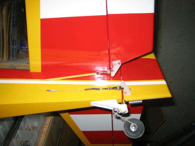

can someone post a picture of how the wire is secured to the control horn?

Usually the wire is secured to a threaded portion which mounts to a clevis, which is attached to the control horn, to allow for some adjustment. That is the method I have used for a pull pull setup, you could just loop your wire through the horn and secure with a brass or other short length of metal tube that is crimped to hold the wire, but I would not do it like that.

Here ya go ...
There is a crimp sleeve under the shrink wrap ...

What do you use to crimp the sleeve? In other words, what tool works best to make sure that wire won't slip free?
