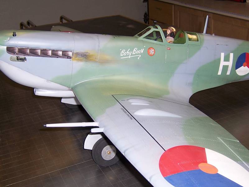

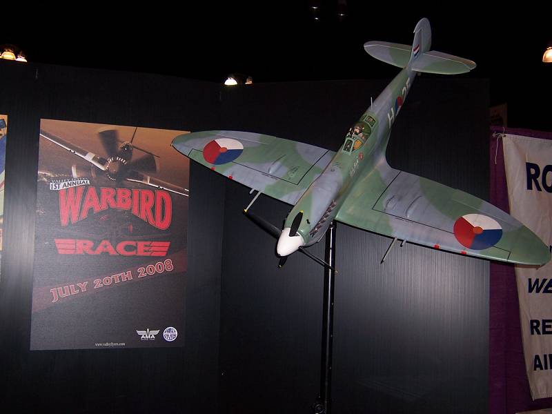

I used West Systems epoxy and 3/4 oz glass. To fill the weave and for surface detail, I used high build auto primer. The plane was painted with latex exterior paint using a Testors Aztec brush. Weathering was Humbrol and Model Masters paints. The clearcoat is waterbase polyurethane.
Here's a couple of photos.
Scott

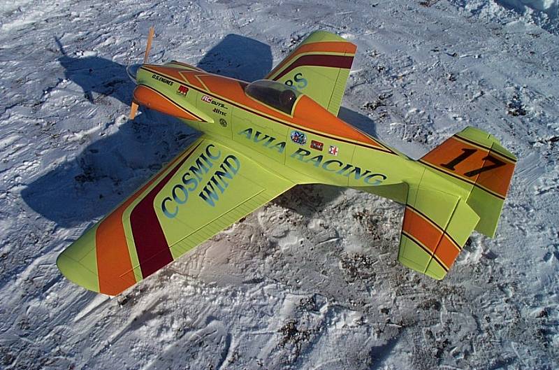

The picture shows a 1/4 scale Cosmic Wind Pylon racer. It is painted with latex and an automotive clearcoat for fuel proofing. You can bet your life that before I did that paint job I checked out fuel proof paints by painting test samples..
For glow fuel, latex is not fuel proof.
I do not care what anybody tries to tell me. Water based polyurethane clear or paint IS NOT FUEL PROOF. Some use the term "Fuel resistant" I do not want to hear that. I want to hear "FUEL PROOF"
Hence the automotive clear on my Cosmic Wind.
Ed S

You're right Ed, waterbase polyurethane is not fuel proof. But the satin finish will stand up to low nitro content fuel if cleaned after each flight. The problem with oil base polyurethane is that it yellows quite a bit. I'm sure some of the auto clearcoats are fuel proof, but I don't know them well enough to know which are fuel proof and compatable with latex.
