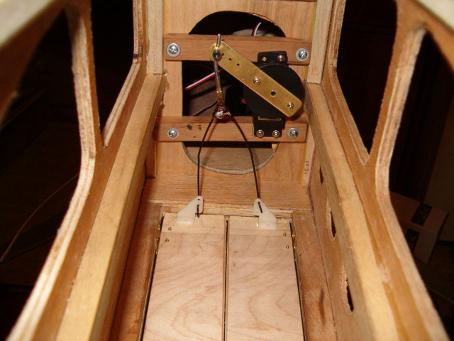

I have a 12' Telemaster that I want to put bomb bay doors on what is the best way to construct them using one servo???

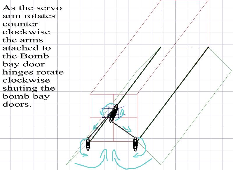

I found these on here a while back. I have not tried them yet. Might work for you.

The colored picture in TLH's thread is the way that I have mine and they work just great. Good luck, Dave

Go to my Bruce Tharpe Flyin' King build, http://www.rcuniverse.com/forum/m_75...tm.htm#7634858. Post #6 shows pictures of how I build a bomb bay for the King. It is similar to Bruce's design shown above with a couple of changes. It has worked well and is connected to the gear channel.
