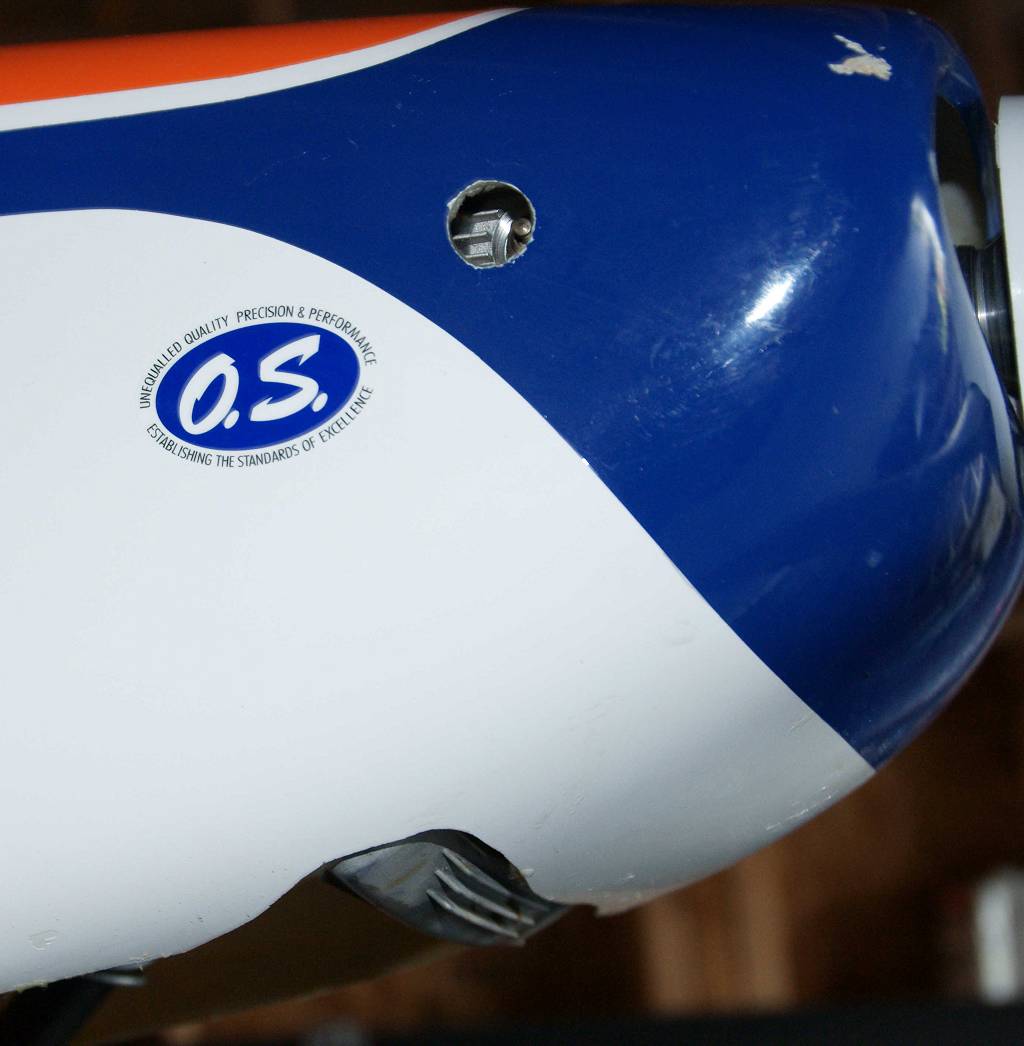

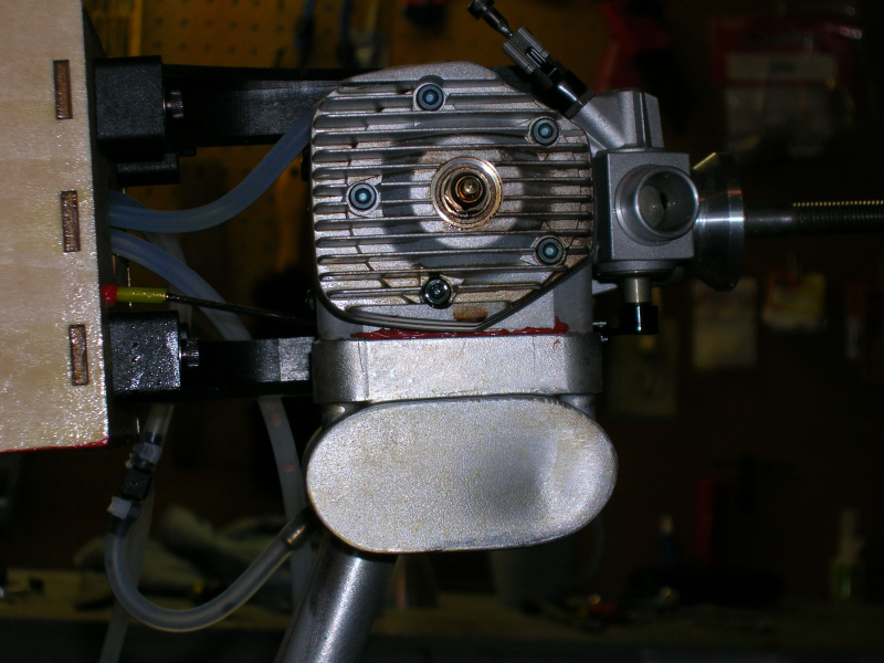

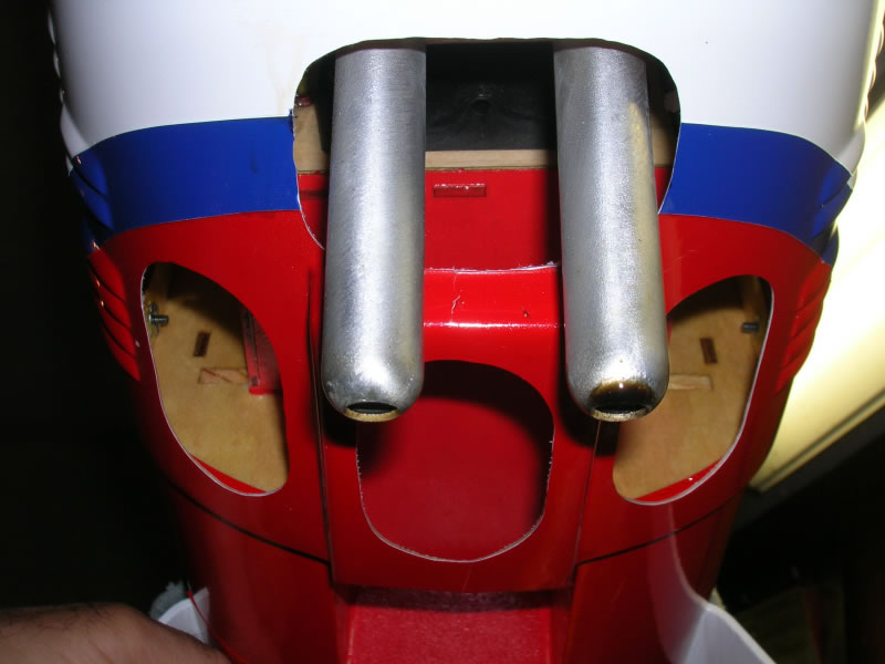

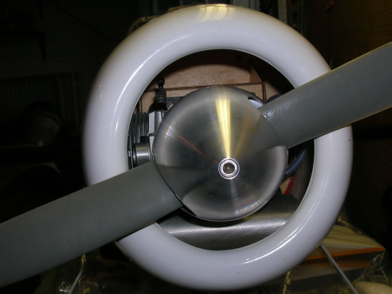

Here are four pics of the cowl setup; bottom view showing the large exit area and transverse muffler; view in starboard inlet - a small baffle is visible which is set angled up at 45* from the cowl interior; view in port inlet shoing bottom of crankcase; side view of cowl; small hole is the glow driver port
If any of you see something I should consider fixing, I would be happy to hear about it.

Well, there are some suggestions above. You can try them. I personally have no experience with an engine without a large area around the cylinder head exposed for the escape of cooling air. I know it's a difficult decision to start cutting away a cowl, and hopefully some of the other suggestions will work. I personally believe that you need to open up the cowl over the cylinder head, but I would wait to hear what others had to say before you begin cutting. It looks to me like you will just get a big zone of stagnant air (which in itself creates permits higher temperatures) in the side of the cowl where the motor head is.
It may be a combination of everything - nearly maxed out needle position, lack of exit for cooling air, and tank being a few inches from the firewall. I have all the same in my Yak, with the exception of increased ventilation, and while the engine doesn't get hot it does sound pretty lean once I get airborne and start wringing it out.
Just my late night opinion

Build a baffle. As already suggested, block off the left side opening in the cowl to force the air over the cylinder. Block off everything inside the cowl so the air MUST travel over the cylinder head before it can exit the cowl. It's a bunch of work, but it ........ works.

Couldn't agree more with Rcpilot. If I were you I would block off the left hand side of the cowl first and see if that is sufficient. Alloy from soft drink cans makes easy to form and fasten baffles if you need to go down that road.

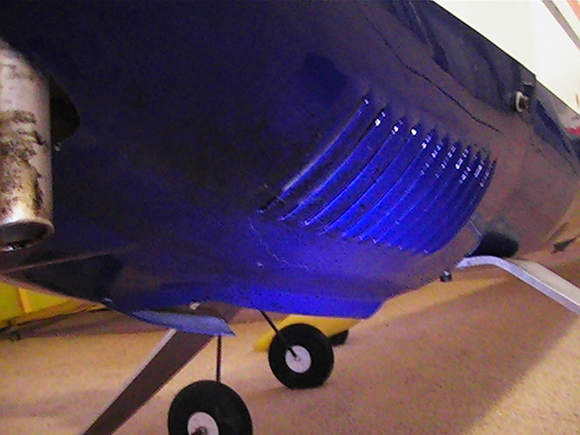

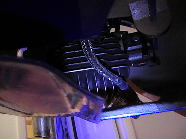

I use an air dam on my gasoline powered planes. Gassers run a lot hotter, so cooling is CRITICAL if you want your engine to survive more than a few gallons. It works. Check out this cowl on my 75cc Extra. The lip goes around 3 sides. I didn't make it - came from the factory like this. But it's not just for looks. It's a functional air dam to draw air out of the cowl. The louvers on the side are cut and functional as well.

wjcalhoun,
Here is the setup I ran with the OS 120AX and pitts style muffler. Hope you get it figured out. Nice flying plane with this combo.
