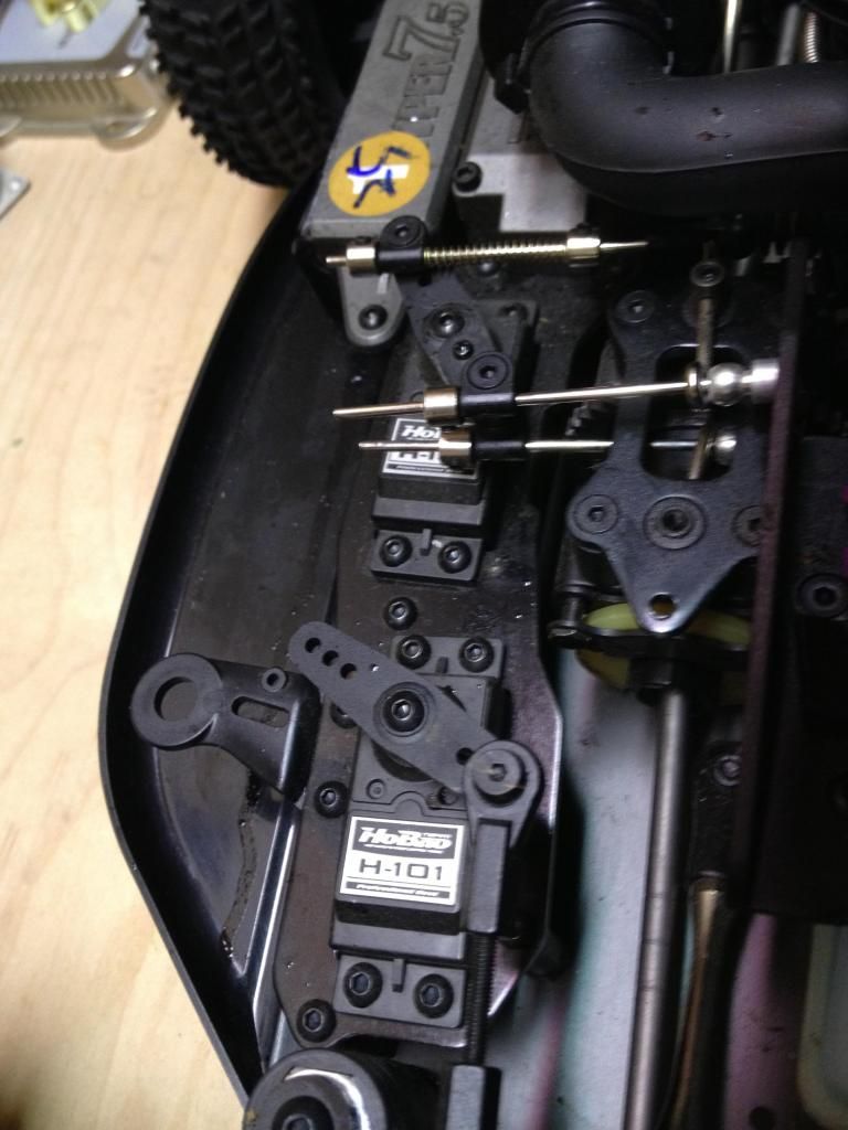

    Just bought a Hyper 7 :) !!
    Hey everyone
    Came across one of those "cant pass up" deals last night
    I was cruising kijiji and came across an add for a OFNA Hyper 7 ... It looked pretty clean from the add... It stated they only ran it 3-4 times
    Turns out a guys gf wanted to get into the hobby , so they bought her this truck and she lost interest pretty quick...... their loss, my gain ! ))))))
    It came with half a gallon of fuel, filler bottle, extra pull start and a JR XR2i radio
    I would say I got a pretty good deal on the buggy.... engine had lots of compression, fired right up. The chassis and wing didnt even have a scratch on them. .... What do you think a fair price would have been for this package ?
    NOW..... what are the first hop-ups I should do ? Im thinking servos.

    I am in the UK so will not guess at a price.
    It does look very clean though, nice and fresh and a lot cheaper than new (hopefully).
    Yes the servos are not great. I use Hitec servos and have a HS-965MG for steering and a HS-625MG for throttle/brake...but there are many different choices of course...and depending on your budget you can just replace the steering servo.
    Some form of failsafe and a 6V rechargable pack are also "standard" upgrades.
    Other than that upgrades will really be down to you, the Hyper7 has many variants and upgrades available. There are no weak parts to speak of (although I hear someone shouting "cast front knuckles") and if you break something then look to upgrade the part.

    Servos are the first thing I would upgrade, at least on steering.. Savox 1258 (speed) or 1256 (torque) maybe.. The Hobbico or Tower Hitec 5955 rebrand would be ideal, but a bit pricier..

    I have noticed the steering seems to be very sloppy.... or loose I guess you can call it... all links are tights, and nothing seems to be broken ? How do you tighten this us ? anyone run into the ame problem ?

    Follow the arm from the steering servo to the sevo saver, there is a thumb nut you can tighten on the underside of the servo saver. Tighten this against the spring and should take out the slop. Did you replace the stock servo, not all the way up to the task....

    I will do that when I get home Thanks !
    I have yet to replace the steering servo, I have heard that is the first thing to replace. Whats a good servo for the job ? (budget based of course)
    I was thinking for the sake of it being water proof... the 2075 traxxas servo ?

    I usually get the hitec 645 MG servos from tower around 30-40 bucks work good for the price.
    Personally I would use a Hitec servo, basically because I have never had a problem with Hitec and they have a suitable servo to fit any budget/performance needs.
    The HS-645MG is a popular choice, not very fast but it has plenty of power and is fairly cheap.
    No doubt there are other brands that maybe cheaper/faster/more powerful.
