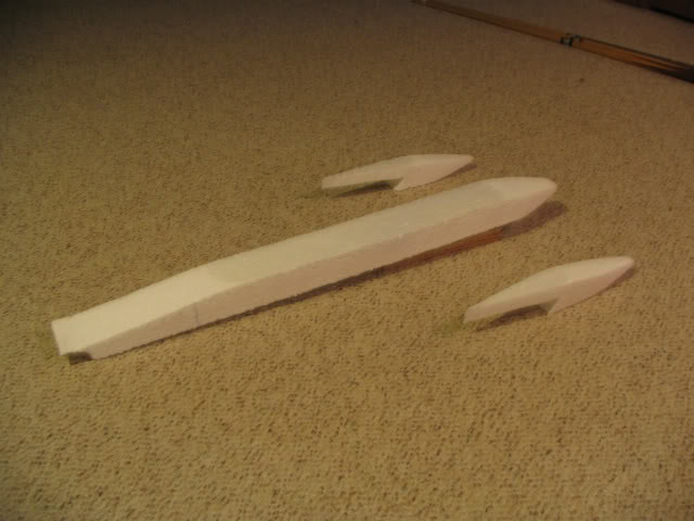

These boats are really tough to make unique. I want to build one thats of my own creation, with some styling cues taken from other builds. This is my Rough draft carved from 2" styrofoam. I figured I'd use styro because its easy to sculpt and I can get my overall design figured out before doing the hours and hours of drawing and then months of building. Overall length is 36" of the center tub and 14" on the sponsons. Overall width has yet to be determined. I figure it'll end up somewhere between 20" & 22". I still have some modifications I'm going to make to the foam before I will be happy.. once I am happy with it, I'll draw it out and (hopefully) build it. Framework will be mostly balsa with some 1/8" and 1/4" plywood for supports. I'm going to skin it in 1/32" or 1/16" plywood and stain it a different color than my last one.
Power will come from my new TT .46 Pro on a mid 10" - low 11" prop. I originally wanted to invert the engine but I'm gonna end up cheaping out and turn it sideways 90* so the exhaust is either on top or bottom.
Here's my foam rough draft:

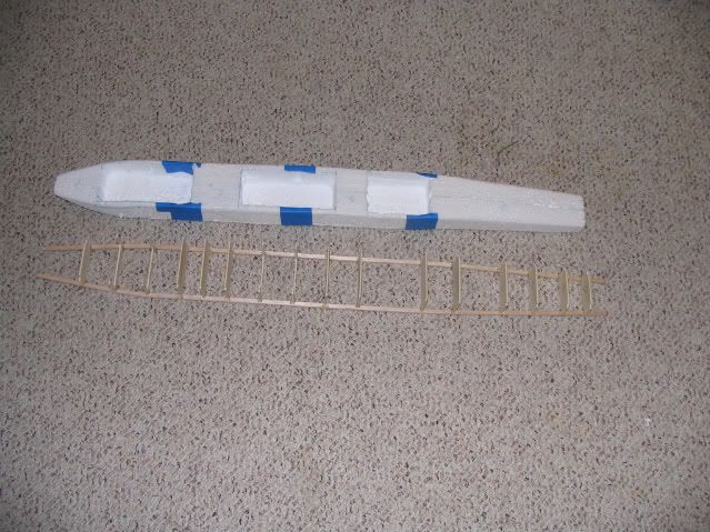

I drew up some plans and started laying out the frame. I made some adjustments on some of the dimensions - Sponsons will be longer, tub will be a little bit wider and the rake angle changed some. Most of the frame is 1/8" liteply with some 5.5mm ply in the crucial areas. Balsa is used for the outer framework.
I made a jig on a sheet of 3/4" sanded plywood and screwed down a few pieces of wood floor scraps to make the template. (Flooring is milled super straight and isn't bowed or bent) I laid wax paper down inside the jig so any epoxy that drops down won't glue the frame to the jig. I made a top jig to drop down unto the bulkheads to keep them straight and square (not pictured). I have a few more pieces to make for the jig to set the bends for the front and rear of the frame to get the rest of the bulkheads set. I havent come up with a name for it yet.. I have to make sure its going to be worthy of a name first...

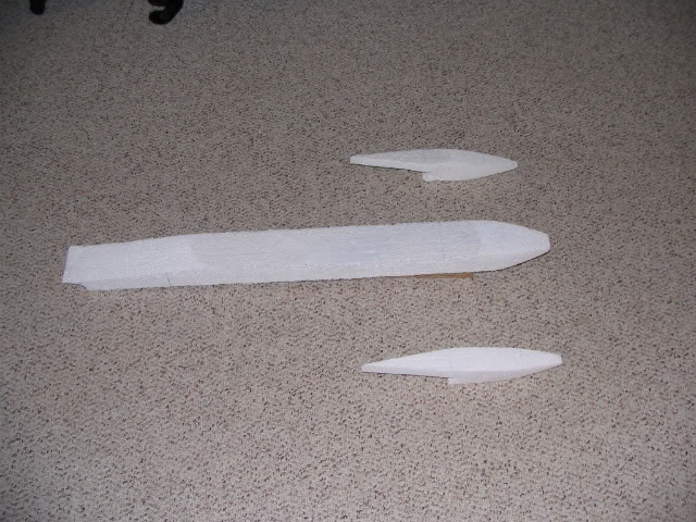

Here's some perspective. Frame side by side with my foam "dummy" boat.

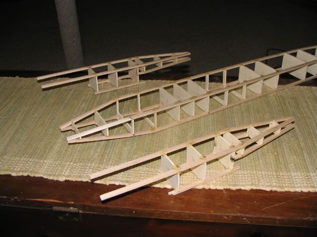

Got the rough frame done for the center tub. Going to start the Sponsons next so I can decide where exactly to put the boom tubes.

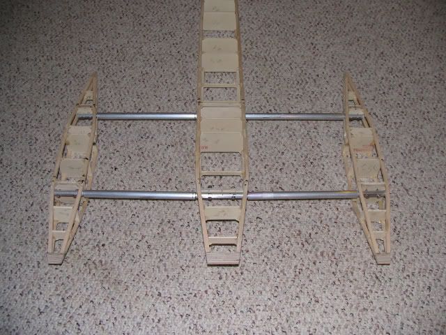

I almost have the sponsons done. I have a little work left to do on the front of the sponsons, then its on to boom tube mounts and frame reinforcements. I will probably cover the bottom of the tub and sponsons in liteply first and put 1/32" birch over everything. I tried keeping it as simple as I could.

Little more work done.. Sponson frames are almost done. Tub needs a little more work before I install the boom tube mounts but this is where I'm at now.
