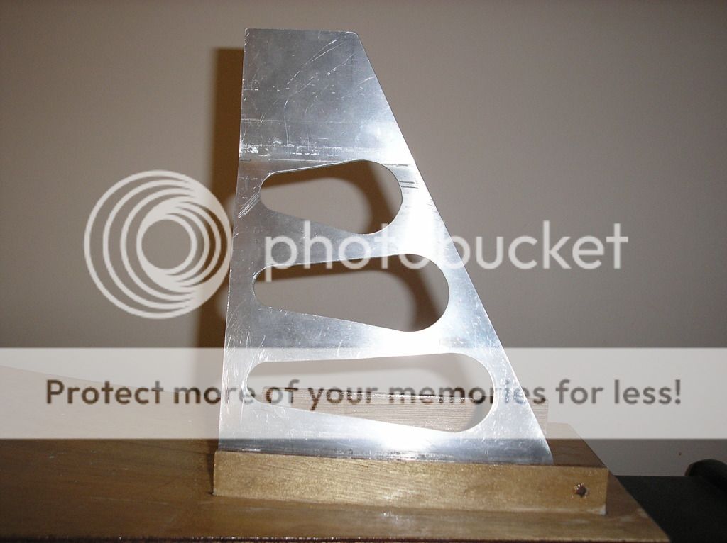

Starting the engine stand.
Cutouts to lighten it up.

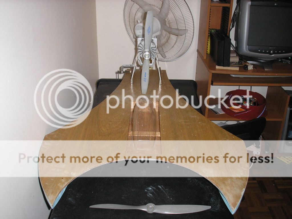

Engine brackets are done, bolted it together with the crank case to sit it on the hull for a couple more pics. for you guys!

The cockpit will look a little something like this!
