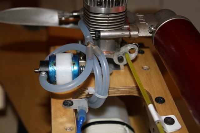

Engine/Fuel Pump. (I added a return line because the regulator on the pump couldn't be dialed back enough to prevent the engine from flooding. Added benefit is the mixture doesnt change much from full tank to empty tank except for air bubbles at very low fuel levels. )
This engine is a little picky on fuel tank placement. I could probably get the engine to run fine without the pump and keep the tank below but I like the more consistent fuel mixture. I need to replace the O-rings on the Low speed needle valve before I re-test it, The low end and midrange was a little temperamental the other day.

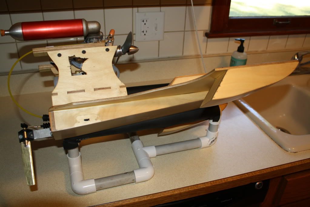

I decided to dust this thing off and tear it down to rebuild it so it will float, and maybe even run yet this year. Its been on the shelf while I run the snot out of my Kamikaze's.
Tore the skin off the bottom to make the center tub deeper, to aid in floatation. 1/32" plywood removed:
Balsa stringers added, making the transom 3/4" deeper than it was before, with a lighter taper to the bow.
Stringers glued on, and bulkhead spacers added, all balsa.
New Keel skin, made myself from 3/4" American Black Cherry. 4 strips 3/4" wide, 1 strip 15/16" wide. I used 4 small strips of cherry and epoxied them to the 5 strips to make one sheet out of it.
The skin strips are 1/32" thick and the 4 support strips are 1/16" thick
Waiting for the epoxy to cure, and I'll upload pictures of the skin on the hull.

Bottom skin is on and curing. Couple pics of the modification. The outside of the tub will get a thin skin to cover and seal the balsa.

Some more progress on my failed 3-pointer... Cut the old engine stand off and made a new one to mount in its place. The new one is a couple ounces lighter and has a small amount of adjustability added to move the engine fore or aft a little if needed.
Bottom skin with 2 coats of resin and 2oz cloth, and polyurethane on top for a smooth and slick finish.
New engine stand, with Enya 30SS mounted up.

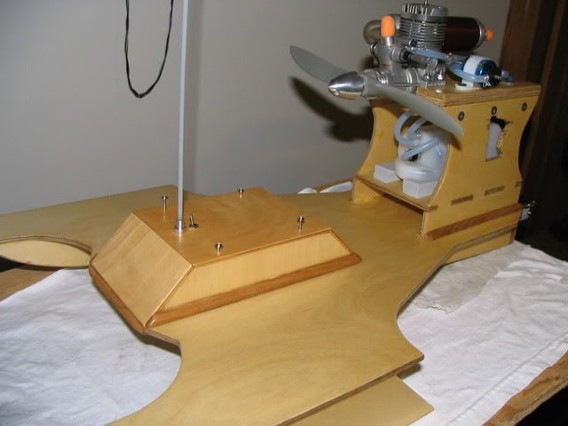

When I built this thing a couple years ago, I forgot how I set up the radio box since I pirated all of the electronics to put in one of my other boats. I figured out how I fit the pack in there, because I did get it in there at one time. I basically use the servos and their respective mounts to hold the Rx pack in place. I'll snap some photos of the radio box again.
Everything is tightened down now, control linkages are setup and adjusted, and I found the fuel tank. I just need to get the antenna tube installed and zip the radio box shut and its ready to get fueled up and carted to the pond. As soon as I get my first cup of coffee, I'll add some pictures. Im sure its gotta be like 10-11pm on your side of the planet, so you might not see them until tomorrow. Oh well.

I forgot to get a picture of the radio box before I buttoned it up, but here it is all set up and RTR..
Short video of me sounding like a doorknob running my little boat on the stand in the driveway. It moves!
http://youtu.be/k6k5x-R8Hsk
As long as it actually moves in the water without flipping over, I'll be happy. I'll probably have to give it a toss.. If the rain lets up, I'll run down to the park and test it out.

Well, I got a chance to get out and test this boat a little bit. The verdict is: This one is not a total failure, but mostly. Its too narrow and a bit too short. It will ride on plane, albeit kinda low. It turns pretty well, but its too heavy and not big enough. For 5lbs, it should be 20% bigger for the same weight. I think I might be able to take it all apart, and re-use the control cables and just build a whole new boat. Target weight of the new one should be no more than 5lbs. Micro servos are going to be a must. I have plenty of 3/16" plywood, and 1/8" plywood. I'll make my own skin again for the bottom, and hopefully take 2 will work better.
I wont do anything further with this boat. I'm not heartbroken over it... It was a slap together type of thing, so I learned a few things and will make changes on the next round.

Well, the problems I see with my boat is its 2 1/2" shorter than the SI 20. From the pictures I've seen, is about the same width at 14" I think. Another problem I have is its just too darn heavy. While running it yesterday, it seemed to run straight okay - handling its own little wake well enough. The problem came in turning... The top deck isnt big enough, and in a turn, the lack of the extra width of the top deck allowed water to come over the top of the deck somewhat and add in the heavy weight of the thing, and it would roll a bit. I added some thin plastic chunks I had with me and some tape to add a "guard" of sorts to the rear part of the deck and this seemed to help quite a bit though it still rolled on me and flipped.
Here's what I mean:
This makeshift mod worked better as it seemed to turn better, but it still would drop in the water when slowing for a turn, and still rolled on me. So I'm drawing up a new hull. The new hull will have a larger top deck, and somehow I will make it lighter than its predecessor.
I know it took a lot of testing to get the SI3 to where it is today. The SI3 20 is "just" big enough for a .30-.35, though it needs a hand launch. A .25 is about right, but I dont have a .25. My Enya .30 is 9oz without muffler, and the TT muffler weighs in at 4oz and the muffler adapter is about 3/4 ounce. Add in the heavy metal geared servos and 4-cell alkaline battery, and too much other junk, and it comes in at 5lbs. I'm hoping to get this weight down to at least 3lbs, if not a little lighter. I think the weight is my biggest adversary with hull size being second.

So the re-rebuild has begun. Spent some time sanding and cutting some plywood to make a new hull. Old hull pictured above is 14"W x 19.5"L x 2"D. New hull is 16"W x 22"L x 2.25"D (rear of sponson) / 2"D (at transom). The engine mount is not going to be a one-piece unit like whats found on the real SI3's, Mine will be modular so it can be removed/replaced if needed. Top plate weighs a little over a pound, and the sponson parts are very light. The deck is 3/16" Birch 6-ply plywood, and the sponsons will be 1/8" 3-ply Maple (50+ year old carmelized maple ply is from an old door from my house). All bulkheads and support bracing inside the tub and sponsons will be 1/8" liteply. I'm tearing the old 3-pointer apart to use parts from it, namely the control cables.

Got a few more pieces cut. Aft sponson walls (do sponsons have transoms?) and a bulkhead for each sponson, and two bulkheads for the center tub.
