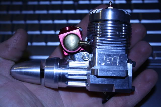

I decided to get myself a nice Christmas present this year. Putting a barn burner on my mini SI3, gonna see if I can get it to fly to the moon or maybe mars.
I'm calling it the barn burner, thinking I'll actually name this boat... Maybe 'The Blazing Banshee' or something.
Jett BSE .35 - 18,000rpm+ on a 9x6 using 15% nitro. Oofda!

Running the engine on the test stand with the tank padded as shown in the above pics gave no bubbles even up to 18,500rpm. I do however have a homemade bubblefree tank that uses 8oz baby bottle liners. It works well, but the engine I made it for burns that tank up in about 3-minutes if not less.. (15cc).
I wil test run the engine in my driveway on the boat in its cradle and run it up to look for bubbles. If I see any I will swap my custom bladder tank and try it.
My SuperTigre s29 turns over 17k and never had bubbly fuel/lines so another 600-800rpm shouldn't make much of a difference.
I spent all my money on the engine, nothing left for a $30 fuel tank. Besides, I have a 5wk old baby now.... Money really doesn't exist now.. LoL.
Andy mentioned the same thing on RCAW... Trust me, I won't fry this engine.

Made a fuel tank change - had to go bubbleless. Small 6-7oz bladder inside an 8oz plastic bottle. Works flawlessly.
Got a few runs on the Jett. Prop is an APC 8x6, 15% nitro, Enya 3 plug.
