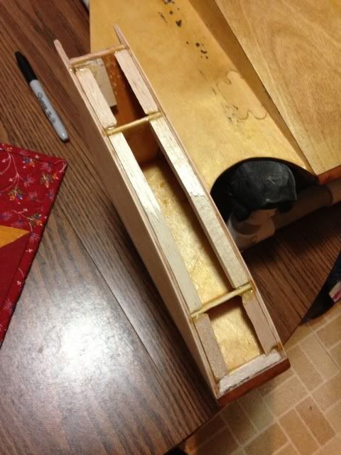

    So it seems that speed was taking a toll on my sponson skin... Part of that was my fault in not reinforcing it. So under the knife it went:
    Peeled the skin off, adhesion of the epoxy was fine, and no water intrusion.
    Cleaned up the sponsons with a light sanding and added balsa strips to support the skin. This was done in the tub, not sure why I didn't do it to the sponsons originally.
    After a quick sanding, I'll glue new skin on and get it fiberglassed again. We are trying to get another meet planned and I'm hoping to break my old speed record by at least 5mph... Wish me luck. More pics to follow.

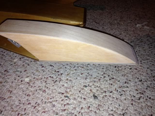

    New skin is on! The skin is MUCH more rigid. It shouldn't deflect much energy, so hopefully this translates to faster speeds. I added a small chunk of 3/16" plywood on the inside of the sponson transom on the port side to reinforce the turn fin brackets mounting. I couldn't track down any 4-40 T nuts to use, so I will just use wood screws. 6-32 T nuts were too big.
    Rebuilt sponsons:
    I don't have enough resin and possibly enough cloth to cover this so I'll stop by the hobby shop tomorrow.

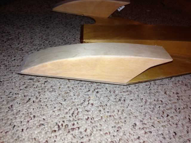

    Got a layer of 3/4oz cloth and a coat of resin on the rebuilt sponsons. One more resin coat tomorrow, a couple coats of polyurethane Saturday AM and off to the pond I go to bash the Jett some more...
    Here's the top deck after re-sanding down to bare wood to remove some fuel stains. One more coat and its seaworthy again.
