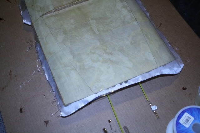

    I tore the boat down for fiberglass. The hull itself with only the 2 servos and servo mount/tray installed is 2lb 7oz. The engine, engine stand, full pipe, and full tank of fuel is 1lb 12oz.
    I'm using 2oz cloth on the whole bottom, but I haven't decided if I'm going to use 2oz on top or 3/4oz or two layers of 3/4oz. I have the cloth cut for the bottom, and some plastic sheeting to put over the wet resin. (This makes for an unbelievably smooth finished surface, the weave fills in much nicer this way.) Here's some pics of the glass prep:
    Its hard to tell front to back under the cloth, but here's front and back bottom shot.
    I had to make 2 small cuts where the step is. Had I not done this, I would have ended up with a giant bubble that wouldnt lay down. This way I slightly overlap the two edges and hopefully keep the edge of the step nice and sharp.
    I hope to get the resin down on the bottom, and maybe get the cloth cut for the top once I see how the 2oz lays out on the bottom. I'm using Pacer Z-Poxy finishing resin. Sets in 60min, cured in 3hrs. I used the same resin on the original Kamikaze. More pics to come.

    Bottom is glassed. First pic is before I laid the plastic sheeting over the wet resin:
    Plastic sheeting laid over the resin. This gives a near-glass like finish. final finishing is a breeze.
    I'll trim the excess fabric in about 30 minutes and let it cure overnight. Next I'll touch up any air bubbles and move to the top. I think I'm going to use 3/4oz cloth in the important areas and use resin alone in the rest of it. The bottom is what I was primarily concerned with, and the outside edges of the hull. I need to find a plastic film that wont stick to epoxy but is smooth all the way across. Using 1 or 2 pieces is a lot easier than 5 like I had to do this time.

    If so, here.. I use a metal screw and nut on top for the hinge, and the lower hole I use a nylon screw and nut. The nylon will break cleanly should I hit something.
    If not... what did you mean?
