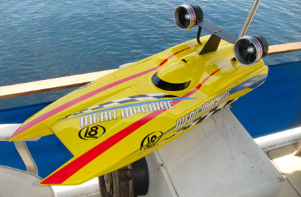

So, where I need help is figuring out how much thrust I'll need to power the boat I'd like to start with. This is not going to be your typical air boat, so my apologies for posting here to start, but I figured this is where the most help/interest would be.
the boat I'd like to use is linked below...
http://www.hobbyking.com/hobbyking/s...30mm_ARR_.html
Since its a medium sized boat, I was thinking I could easily make it scream with twin 64mm edf fans. My thoughts were to grab a nacelle like whats linked below, and mount it on the top of the cabin area.
http://www.motionrc.com/dynam-a-10-edf-housing-green/
next, since that part is foam, molding it to fit like a glove on top, gluing it down and then using the stock rudder....or perhaps use one similar to an airboats(behind the outgoing air) to steer it, maybe even both.
Do you think that two 64mm edf fans could make that boat go fairly fast? I know I'll never have the power of a true prop in the water, but trying to make something different that might still get me cruising along pretty good.

The biggest cause of slow speeds with airboats is excess drag caused by too much hull in the water. A catamaran can have less drag than a flatty, but the best would be an outrigger design. Next would be a twin hull like my air-prop-driven twin airplane float airboat. That gets low-30s on 4S with low amp draw. Less hull in the water means higher speed, period.
With an EDF weight is the enemy too. Use of smaller capacity/lighter packs can increase speed...the downside is less run time. Someday I will build an EDF airboat......

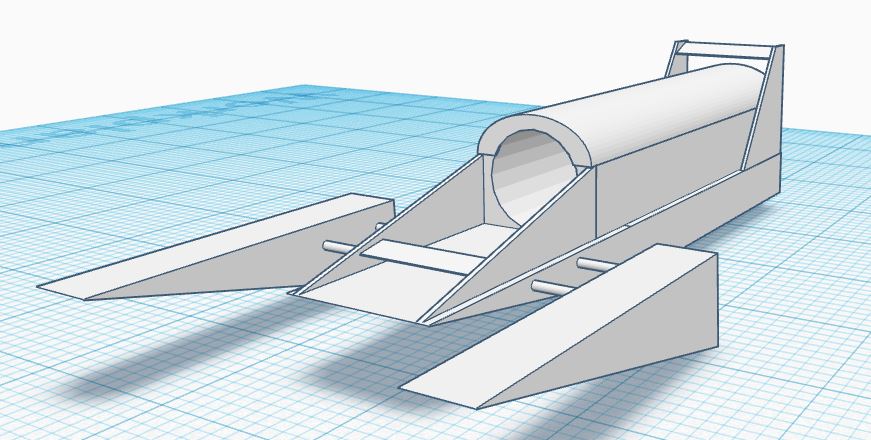

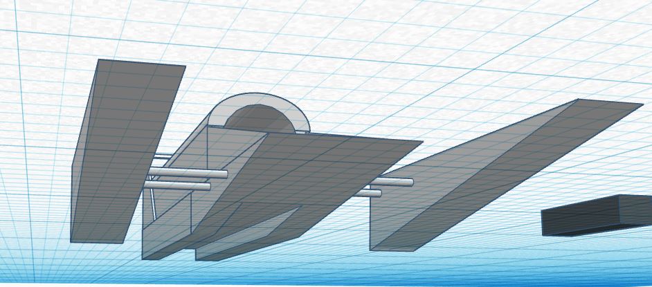

new question, super cub plane floats have a two part hull. I was thinking it would be a good idea to make the goal to have it plane off on the front bit of the floats rather than both, so it would make most sense to out the thrust up towards the front. Since you did something similar, I was curious how it went with the hull being not 100% smooth on the bottom? To me it could be a nice thing as I could effectively cut the water drag in half once on plane. What were your results like?
I found that if I tried to run on the front step only the boat porpoised terribly and would flip if I kept in the throttle too long. This was accomplished by moving the CG, jet thrust vectoring alone will not be enough. I was constrained by the semi-scale design, you will not be.
A float plane rides on the front step by using wing lift to stabilize the attitude, which we do not have. Getting a balance between CG and thrust vector to keep the boat on the front step only will be a challenge. Float designs vary so yours may be more - or less - forgiving than mine.
The upside is that running on both the front step and the transom is still a huge reduction in wetted area and drag over a solid bottom, or especially compared to a flatty. While it would be great to be able to run on the front step alone, it is probably not too practical especially for a prototype. I suspect that you will have a fine running EDF boat with the CG behind the step.

That's awesome, I see what you mean about the front being hard to plane off on. I'll probably mount my fan on slides and then I can play with it a bit to see what will work. If I could put a horizontal rudder behind the fan, it would be controllable to a certain extent...
im now thinking, for weight purposes, I'm going to run a single 90mm fan, it makes more sense and has far more thrust.

Still toying with platform ideas. The motor/fan I bought pushes 3.2kg of thrust, so now the goal is 3:1 thrust to weight ratio. I could go 8s for more, but seems like it might be overkill and weight will quickly become an issue. So anyways....I found a few F1 hull kits that are pretty light, and only 24" long. Also, I ran across a cheap one in eBay called the NQD PX-16....check it out and let me know what you think. For drag purposes and a better building "base" that could be a good option. The floats seem good, but a purpose built cat may take some minor engineering flaws out on my end you know?
this should be interesting....a car guy and a heli guy swapping ideas for a jet powered boat. Let's make the goal 60mph and see what happens!!!
