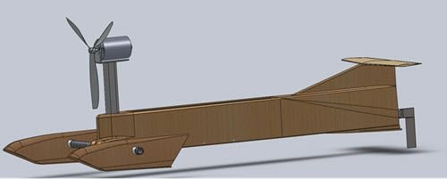

@GotRPM thanks for your input.
The first important topic is to have a good sizing of battery-controller-motor and later will have to test different propellers for best performance.
Below is a rough design of the boat. I'm still working to figure out if I can build it with in 2kg weight. I am not actually sure how much installed kW power I need in order to get relevant high speed.
Actually the reason I opened this topic is to get support in sizing the power plant and propeller.

Then a 36-42mm motor with a Kv around 600 on 10S spinning a 10x6/3 APC Electric prop should get you to 60 mph with reasonable amp draw - assuming the hull design works. The better the motor and cell quality, the better the chance of high performance.
Your hull design is rather unconventional, most riggers have a tub wider than it is tall to lower the CG and to help keep most of the sponsons well above the water at rest. You don’t need the T-tail as it adds complexity and drag, but the vertical may be a good idea. So is the rear shoe, it defines the hull’s aoa.

The unconventional design with taller than wider tub is to reduce the air lift created by the hull. This rigger is not supposed to be too maneuverable, I can increase distance between sponsons for stability.
Regarding T-tail I was thinking to test if at higher speed the T-stab will lift the rear shoe out of water and run only on front sponsons. Anyway if not efficient or troublesome can be removed.
The CG is about 70-80mm obove water while gliding.
