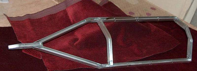

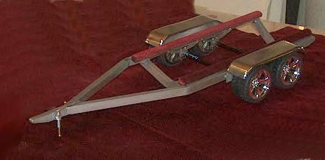

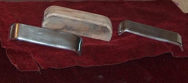

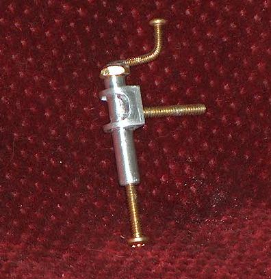

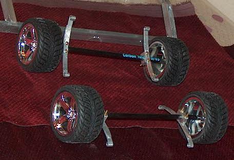

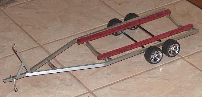

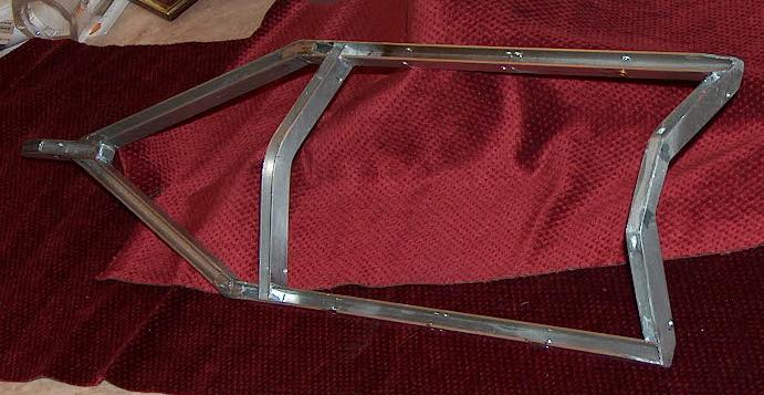

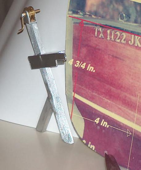

I’m building a trailer for my Turbo Vee. This is the first 1/10 th. Scale trailer
I have built. I have built full size trailers before. I patterned this after my full
sized jet boat trailer. The frame is all aluminum wielded together. The axels
are carbon fiber. The fenders are made out of a flat piece of aluminum, that I
molded using a form made of hard wood. I really like how my trailer jack turned
out. What do you think. I’m open to suggestions.
Don M.

That's really nice. ...how I wish I could tig weld. How long did it take to build it? Have made you made the tongue yet? Do you have an RC truck with a ball you can hook up to?

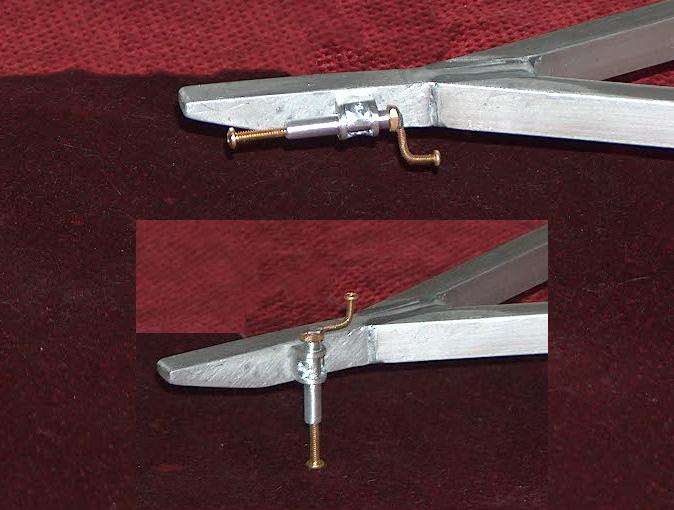

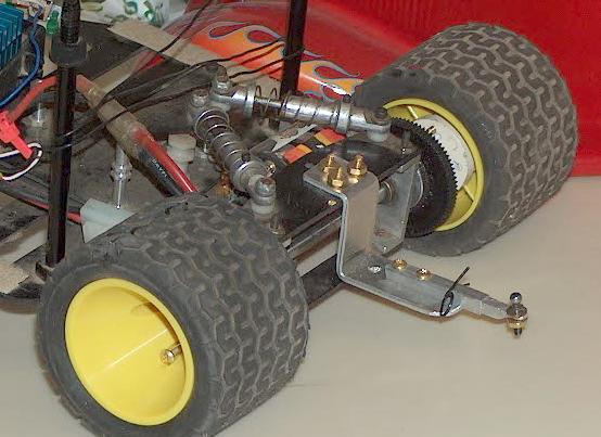

I'm realy enjoying this build. I worked on the hitch last night.

More work on the hitch. Made a removeable hitch receiver for the car.

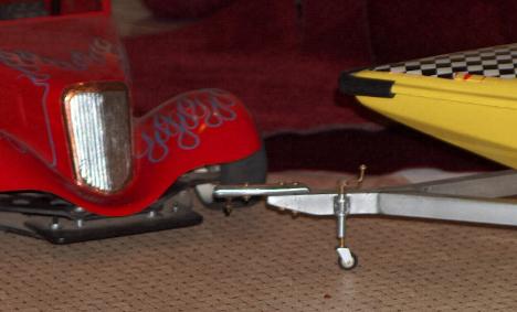

Is the ball attatched to the rear of the car or the front of the trailer?
The pictures don't add up.

The ball is mounted on the car with a removeable hitch receiver, just like full sized cars.

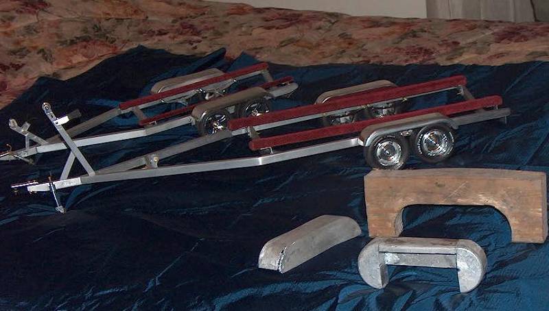

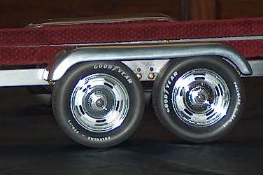

Finished # 2 last night.
I think the fenders was the hardest part, I was almost done with one
And burned a hole in it.
Then my wood mold broke so I had to make a new one out of aluminum.
I used my new lathe on the winch and trailer roller.
Don M.

Its soldered aluminum, The finders are made from a flat peice of aluminum formed
with a hardwood and aluminum mold. I use a propain torch. this place has rods you can get to weld aluminum.
The metal has to be very clean.
http://www.alumaloy.net/
The trailer was custom made for a Ready-to-Run Pro Boat Barrel Back, for a guy in Texas.
