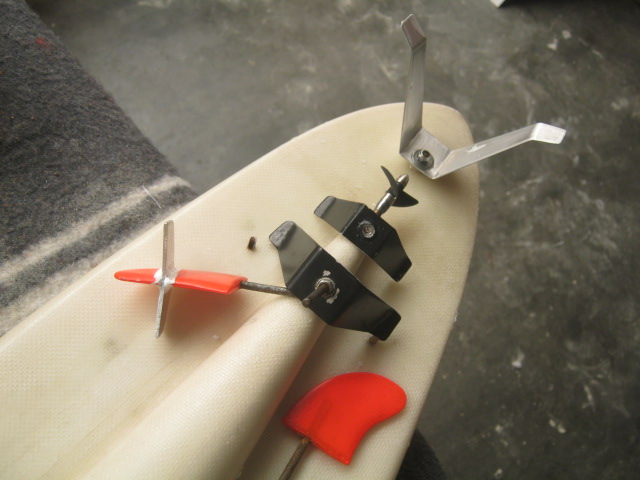

Much about custom 'board shape and design' has been spoken about on this thread - but - very little has been discussed with regards to the actual Turn Fin. whic makes a huge difference in the boards handling.
I have tried a few different shapes and foils ( some in pictures) and keep coming back to the Bi- Fin - The Bi-Fin seems to keep the board more stable and solid in the tight turns - kind of carves better than a single fin - I am finding that bigger is better - the current fin I am running has a fin length of 60 mm and a foil length of 15 mm with a slight negative trim which holds the tail down - the board runs very stable in the water and definitely carves best with this 'new Bi-Fin size'
I would be interested to hear what others have found to work well for them.......

Agreed Karl - most single fins do work well - and to a fare degree, can throw the board around quite effortlessly, depending, as you say, on the set up/design of the individual board.
Seb made some added head way to the single fin by adding the trim foil - but as you mention - with the bigger boards - the foil needs to be more of a wing - which may add to much drag and effect the ride in the vertical plane.
What I would really like to know is -if any of the 'Custom Guys' have ever tried the Bi-Fin design on any of their boards - as from what I have researched so far - looking back on all the various designs- I have not seen any from the US..... only Cananzi in OZ - running them on some of his custom boards and commenting on its performance advantages.....
Brendon's design of the Bi-Fin certainly has a few very unique added features compared to the single fin......which I reckon could only add value to any already 'awesome board'.......
If one hasn't tried it .......I really recommend it.......its very easy to make - all of 30 minutes at worst.

YPC
I Agree,
The Wombarra Bi-fin design is the optimal Choice. OZ Has Fin Design Down. Heck, Look what Simon Anderson Contributed (The Inventor Of The Tri Fin Thruster)
I tried many others, Like BB's Glassed Single Fin (was Break Proof), Ed's Tri Fins (Looked cool, didn't seem to add trim value) and Spenser's Brass Single Fin
But what worked The Best was the Bi-fin in my opinion.
The only flaw The Kyosho / NQD Bi Fin had, was that the stem would break.
Most all of us solved that issue with using a Stainless Steel Bolt Stem
Surfcurls took it further to make the Bi-fin with Carbon Fiber So It's solid as the rock / reef that it might challenge ...
Simon designed The Tri Fin 30 + years Ago ...
Note The "Aloha Racks". Do they Still Exist ? All We Use Now Is Soft Racks ...

Hey Curls.......LOL......... finally ! we have found something 'we agree' upon.....LOL......I'm going to print that 'reply' and put it on the wall in my workshop.......LOL...
The OZ's do seem to have a thing for fins.....Brendon mentioned to me a while back that the Bi-Fin was his idea, we just never had a chance to discuss his take on the actual overall design.
When one examines the 'features' the Bi-Fin offers.......it offers whole lot of 'Things' going on below the water......VERY SIMPLY !......For myself - I definitely notice things like- A more stable board on the water at speed and on vertical faces ( even though I have a 2kg lite board) the fin holds it down - The board leans over more and holds the thrust in the tight turns better - The board responds smoother to turning/transitions rail to rail - pulls the tail down/nose up in turns...eliminates high speed 'toppling turns ( on the narrower boards)....etc
I like the Carbon route...........I'm still playing with size/shape/foil angles etc......the nice thing is, once you have 'your' ideal Bi-Fin - it relatively easy to reproduce in carbon, using the original as the mold........Use a small sandwich bag and pump to vacuum it while it cures, and it will be even more Bullet Proof.........

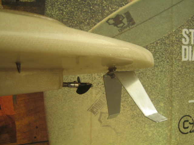

YPC ... I fitted the origi kyosho bi-fin on my single fin kyosho last run for a test and the board bounced bad at speed but tended to be easier to handle on a wave espec at slower speeds.. bit like riding a motorbike with the back brake on a bit to help stabilize everything....
Anyway what are your thoughts regardeing the trim tabs on a bi-fin... was thinkin the angle would be speed related and without a hull to suit the downforce at any given speed maybe an adjustable downforce tab is more the go......
(bi-fins do make it way easy to get the prop shaft out for a re-grease without dismantling the rudder setup but hey...lol)
BTW..... I have seen pics of bi-fins without tabs but was wondering if there was anyone out there in ******** land who has run a single fin board then tried an angled bi-fin without the trim tabs on the same board.... ?

Hi Bearcave.....did you get to enjoy the eclipse......I saw it on CNN......it was amazing........seems you OZ's turned it into a good party.....Yeah !
Interesting feed back..........the original Kyhoso board, from what I have seen....comes out with the Bi-Fin and most of the videos I have seen of the OZ originators shredding the Kyhoso board, seem to be running the Bi-Fin.....so I am sure, with some tweaking , it will work even better. I am always amazed at the Original Kyhoso video's that were produced by Whambara.......amazing stuff.
You may need to add a few grams upfront to move the CG forward, which will reduce the 'bounce'......I also dont think that the boards need to be driven as fast as we currently run them...Every hull has a 'hull' speed.....after which it will start climbing out of the water simply due to the thrust and aerodynamic lift that gets under the hull. If you seek to remedy that, you simply end up being counter productive.
I reckon the 'trim tabs' (foils) play a major part in helping to generate the type of desired 'Yaw' turn effect (dig the tail - lean & turn) as we are trying to emulate an actual surfer. I am kind of fixated with getting the surfer to be more 3 dimensional........tail digging in - surfer leaning -cambering into the turn.
I have run bi- fins 'without' the tabs and the result is that one losses much of the 'Yaw'
On the straight - at high speed - the negative foils (tabs) do pull the tail down into the water and start to generate a kind of rhythmic bounce - but frankly -as you say - its not really an issue on the actual wave.......as for most of it, the boards CG will change when ridding on a 'Burm' ( face of the wave)......so -as I have learnt- flat water is very different to being on the face...............no surfer won a comp for scoring points while paddling out............LOL
In-fact - I recently started running my board with more weight in the 'TAIL' ( 150 g's) it keeps the tail 'HEAVY' and adds some punch in the TAIL, in the turns. The added weight tail seems to generate a outward centrifugal force, almost like a surfer powering a solid tail turn/slide.......the combination of the Bi-Fin and the added weight, really seems to have added 'more dimension' to Bro's surfing style......Blah Blah Blah............LOL
