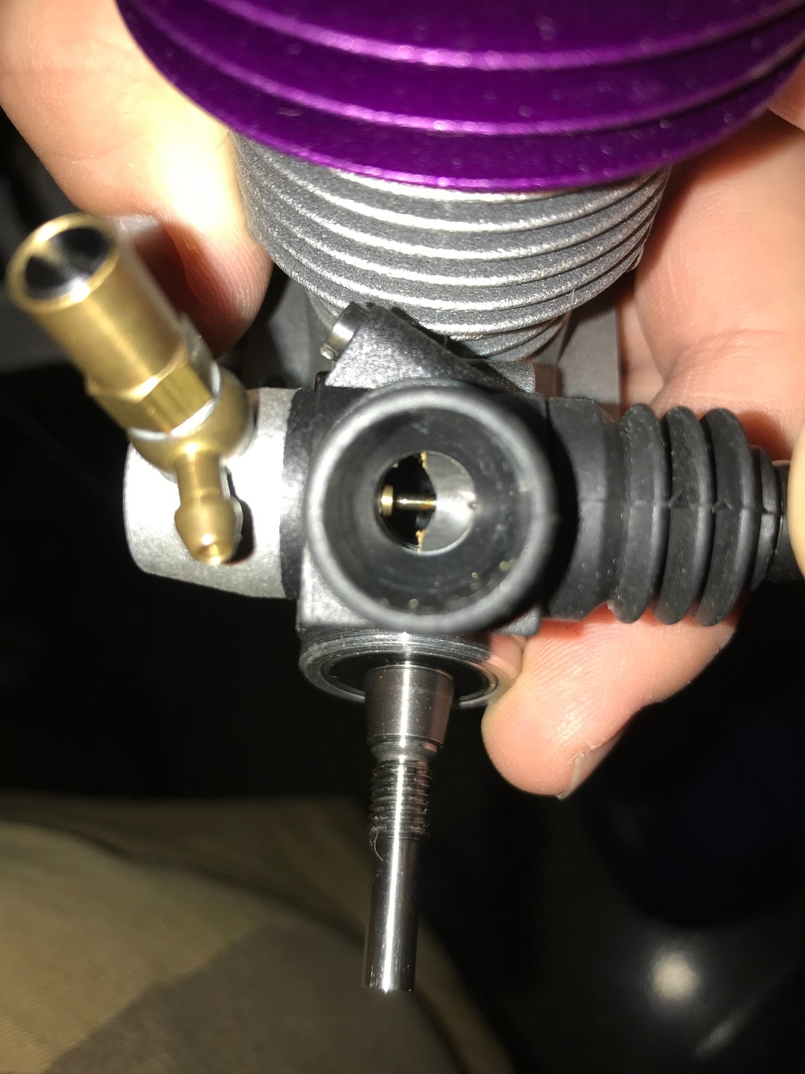

Old 05-28-2018, 03:41 AM
Luxer
Join Date: Oct 2013
Posts: 4
Gallery
My Gallery
Models
My Models
Ratings
My Feedback
The LRP Z.28r is a short needle engine, so the LSN should be tuned just for a nice idle.
It is the HSN needle, that controls low, mid and high throttle settings.
Any of the experienced Guys around? Do you agree with this statement please?
Thanks in advance for your answer.
Luxer is offline

Old 05-28-2018, 07:01 AM
1QwkSport2.5r
1QwkSport2.5r's Avatar
Join Date: Oct 2006
Location: Cottage Grove, MN
Posts: 9,582
Gallery
My Gallery
Models
My Models
Ratings
My Feedback
The idle needle controls idle and the midrange up to about 50% throttle approximately. You can tell your idle is still too rich if you drive the truck around at 50% throttle and it starts to burble and sputter; and then burp a bunch more when you open the throttle further (it might quit if you punch it hard and fast while loaded up). Short needle carbs should have the idle tuned so you have a nice slow idle with an ever so slight loading up while having a clean running midrange.
AFAIK - the only real difference between long and short needle carbs is how much influence the idle needle has and for how much of the throttles travel. Short needle - idle to 1/2 throttle or so; long needle - idle to 3/4+ throttle and the main needle covering overall fuel metering as well as WOT fuel metering.

Old 05-28-2018, 05:56 PM
1QwkSport2.5r
Join Date: Oct 2006
Posts: 9,582
Gallery
My Gallery
Models
My Models
Ratings
My Feedback
I have Novas and Piccos, as well as several SH based engines. Every big block engine I have ever owned have been short needle carb equipped engines. Until the idle needle is completely out of the orifice, it will interfere with fuel mixture. I’ve never owned a long needle carb equipped engine, so I cannot say for sure. But what I can tell you - rotary carb or slide carb; the idle needle will have some influence over the midrange. Depending on the design of the carb, some have more influence than others. The most common tuning problems I hear people trying to sort out are too large an idle gap and getting their compensation tuning fixed. By this I mean lean idle and rich top end and vice versa. This problem only gets magnified when the idle gap is huge.
My tuning method is simple. Break the engine in on more oily fuels initially.
Dont use HOT glow plugs
Preheat the engine!!!! I will preheat an engine if it still has a cold pinch. The longer the pinch stays the longer the engine will last.
Idle gap starts at 0.5mm - never bigger than .7mm.
Run one tank of fuel to heatsoak the engine. Once this is done, do your final tune.
Final tune: set the high speed first and for best peak rpm in a WOT pass. No burbles, hiccups, or anything. Just a nice smooth rev to WOT. Set the idle so you get a slight loading at idle - 10-20 seconds is best. After a WOT pass you just let the engine idle. After a few seconds, the rpm should drop and it should have a lower lopey idle. Monitoring the engine temp
at idle should show a 1-2 degree drop every 2-4 seconds. This idle setting almost always gives good midrange performance. **if after a WOT run you get some idle hang, then open the high speed needle a tick or two and run again. If you get any cutting out off idle, richen the low speed**
I have been running nitro engines for 20 years. I currently own 58 Engines, and every single one of them gets tuned the same way. High first, low second, note transition. Engines with midrange adjustments do get used.
1QwkSport2.5r is online now

Old 05-29-2018, 03:12 AM
1QwkSport2.5r
Join Date: Oct 2006
Posts: 9,582
Gallery
My Gallery
Models
My Models
Ratings
My Feedback
Thanks again for your input. Please allow me to ask one more question:
Do you ever do a fuel line pinch test on the box (initially) to check the LSN needle?
Do you trust this kind of check?
Thanks in advance.
The pinch test isnít accurate on truck engines IMO. I do not use it. I set it by ear and engine behavior.
Attached is a photo of one of my Novarossiís with a short idle needle and showing the needles position at 1/2 throttle. The idle needle probably has influence above 1/2 throttle.
