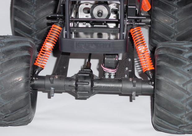

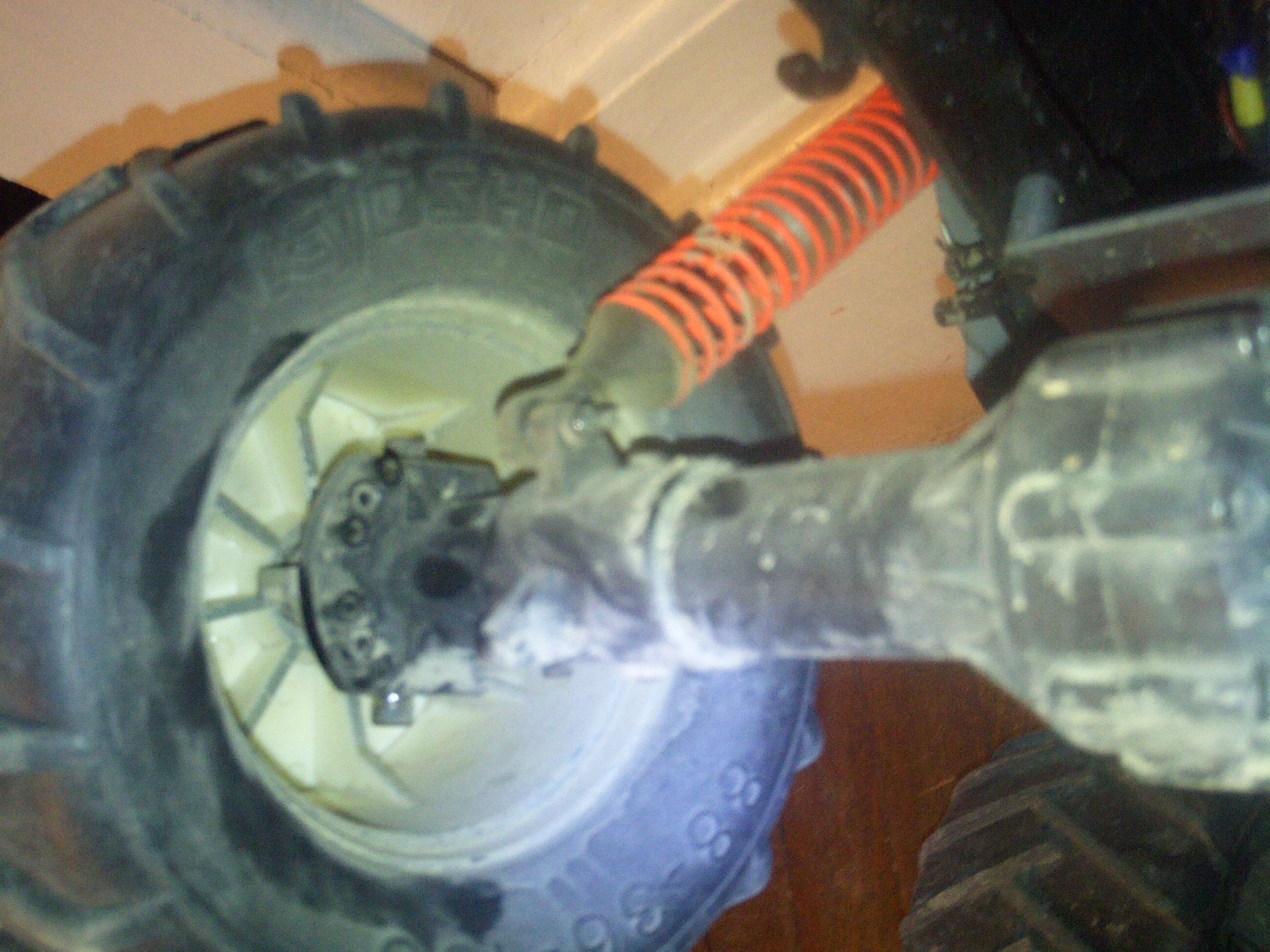

I did some running of my twin force today (see video in video forum) and it did well until the pin in the front center dogbone came out, leaving it RWD.
then while looking up parts, as well as a steering upgrade (the slop is bad) I found a pic showing the suspension setup.....which is NOT like mine.
see the 2 pics below. I then looked up the manual and sure enough the lower shock mount point should be the adjustable mount location near the wheel...not the tab where mine are mounted.
here is the problem, look at my shock and the location of the outer (proper) mount point....if I put the shock there it will surely hit the wheel! that mount is about a half an inch from the outer edge of the wheel, and as it sits the shock is already just 1/4 inch from the wheel.
what gives? should my wheels be mounted further out somehow? (I ask cause the front wheels can hit the lower links if I have my steering rate above 70%)
what am I missing? my current setup helps explain why the suspension is so stiff.

Well just looking at the pics you posted there is definitely something not stock on your truck. Your wheels and tires are further inboard than stock, I don't know if that's due to wheel offset or something like the wheel hex. Wheel offset seems the most likely if Giga Crusher wheels have less offset. But maybe your truck has shorter stub axles with shorter wheel hexes on it. The only other explanation is early MF had shorter axles with wider offset wheels but I doubt that. Either way it looks like you have lots of comparing part numbers to do, assuming you can find part numbers for everything.

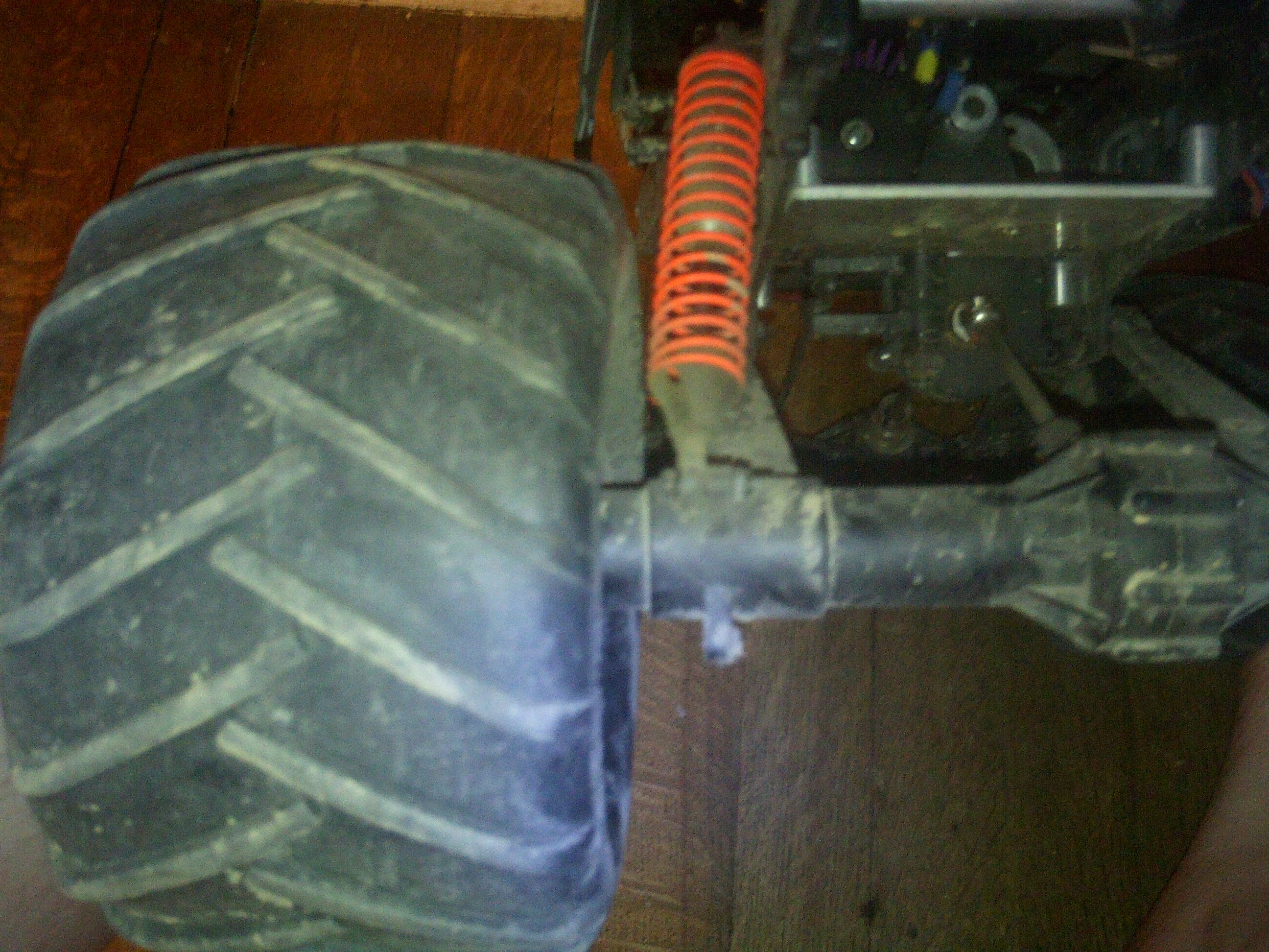

The third picture is where both (sold one) of my nitro Mad Force's are. No rubbing. Was wondering how this build went cause I want to convert one to electric. Not being too familiar with electrics, I'd like to copy what you have done if it's not a problem. To me, everything is exactly the same between the nitro version and the electric one besides the power source, one way on the three speed, and the 3 speed. I just replaced my diff in one of them. It seems they came with aluminum pinion and ring but upgrade to Inferno steel #MA050. I watched your video and that is about enough speed that these things should run. If you could help, that would be great. It seems rcmt.net is no longer or they are not accepting new members?
I ended up selling the truck, but I did put a brushless system (low power, 1/10 scale on 2s lipo) and didn't have any problems with it.
As far as the steering is concerned, I left it stock and I used the EPA setting on my radio to adjust the steering throw...so the tires wouldn't rub.
There are kits that move the steering servo over to the axle....this in combo with a radio that lets you adjust the steering throw will give you good steering. The stock steering linkage allows for a bit of play, and a bit of play with large tires means the truck doesn't always track 100% straight.
