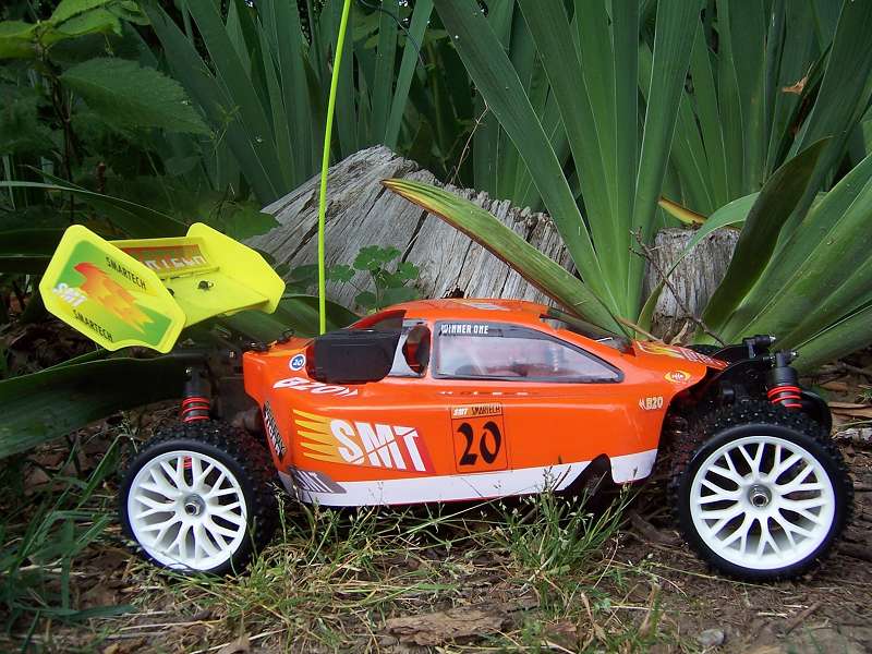

whatup everyone, its SmT64...i dont have that buggy anymore, i ordered me a nitro rush, comes RTR w/ dynamite tuned pipe and heaps of extras for only $107.00usd! pretty sweet deal eh?

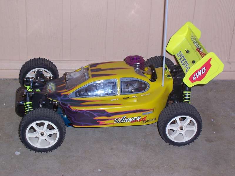

I own a smartech winner sport and it is running great, but it is hard to get spare parts for, so to all people who are considering buying a smartech rc car take this into consideration. Does anyone know if other brand rc car parts will fit the winner sport (eg. HPI, Traxxas etc.) and what is the smartech website???
Below is a picture of my rc car.

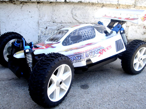

Has anyone bought this smartech buggy? it is a vanguard
HUGE 1:8 .27CXP Engine like to know what you think and where to find parts
OFF ROAD "VANGUARD SPORT" RC GAS 4WD BUGGY
< Message edited by 4wheelfun -- 6/23/2005 8:10:02 PM >

Hey People i had some problems finding spare parts for my winner sport rc car but now i have found
a site that can give you parts from a winner 1 and tiger but because they are basically the same the parts
are compatible with all the other off road cars so here it is http://www.raidentech.com/smsptisppa.html.
Another cool thing that i found is that other brand parts can fit on the cars as well so read this
The Car Contains all available hop-up parts; body or engine included!!!Designed to compete in national and local competitions, manufactured at a super-modern facility, Smartech's nitro r/c gas cars are created with a mind for high performance racing, scale speed of 55mph+. This 4-Wheel-Driven Gas Powered Car is a 1/10th scale that combines many sophisticated performance-enhancing features that represent a culmination of the long years of Smartech's design experience.
OUR CAR HAS A 80-90% PART COMPATIABILITY & MODIFICATIONS WITH OTHER BRANDS LIKE HPI,TRAXX, ETC. YOU CAN CHANGE THE BODY-KIT INTO LIKE LEXUS, BMW, MERCEDE, ETC. YOU CAN ALSO MODIFY/UPGRADE THE ENGINE. ADD NEW TIRES, NEW SUSPENSION, RE-PAINT,+ MORE!!! THIS IS A GREAT KIT FOR ANY AGE, ANYONE !!!

Hey folks
Have finished for the time being, fitting my buggy out with a few trick bits and hopping it up where I can.
Pics are below:-
http://www.rcpics.net/img/59779
http://www.rcpics.net/img/59780
http://www.rcpics.net/img/59781
http://www.rcpics.net/img/59782
Bascially, it has a new OS .18 CV-RX engine (broke the carbie retainer nut so havent had a chance to break it in yet [:@]), with a new 17T vented clutch bell housing, and new high grip clutch shoes (white nylon stuff type), and a HPI exhaust header (it actually stops the fuel going all over the engine!), plus Ive added new adjustable shockies all round (rears units from a Duratrax Evader), with better spring rates, plus made up a new front shockie retainer as the old one wasnt high enough and didnt allow the new shockies their full travel.
Just waiting for the spare part from OS to arrive and I`ll begin breaking the engine in. Hoping the main drive gear hold up with the increased engine power and torque, but Ive geared it down from the original 15T to 17T so hopefully the bigger engine will give me the same acceleration as the .15, but a slightly better top speed.
Guess only time will tell though.
