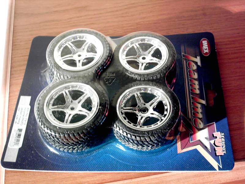

I have an rs4 3 w/ the 12Rss engine. I needed a new engine and wanted a OS .18 CVR. When i was at my hobbytown i noticed they had a .18 tz/tx and being only $60 more then the CVR i put it on lay-way. Got the engine. Fits good (better then the stock engine really) and Aside from needing a better gearing selection, i need a better set of tires. I cant use my foams because the roads around here suck so I'm looking at getting slicks. I wanted to get at least 26mm in the front and no smaller then 30mm in the rear. I found a pair of IMEX 32mm tires on ebay.
"The question": does anyone know of any good slick tires and tires wide "anuff" tires that would fit the rear tires? Being at least 30mm

In reply to my own question, if anyone cares to know... http://imexrc.com/detail.aspx?ID=884
This is exactly what i was looking for, but im guessing there is no offset for the rims. so now trying to figure out how to make them fit will be the next issue. Other wise folks, i was thinking about Hpi's vintage rims a tire combo, 26 Front X 31 Rear

Ive already done some homework on this so its koo. Ive been looking around on-offline and it came down to two options that ive found, either go with the hpi vintage rim & tire combo being the rear tires are 31mm with a 6mm offset or go with the imex combo (above post). But the imex combo is 32mm rear and im betting they dont have an offset. And i can find only a few...VERY FEW 32 or 30mm tires but its dam near impossilbe to find 30-32mm wheel size.
So i order'd the imex combo (got free shipping by the way) and they should hopefully be getting here thurs-friday. The only main issue i know of is the left rear tire will rub on the battery/servo tray, so i "won" a carbon upper deck off ebay and that should free up enough space for the tires to fit the rear. but the body could be another issue[:-]

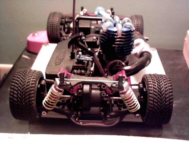

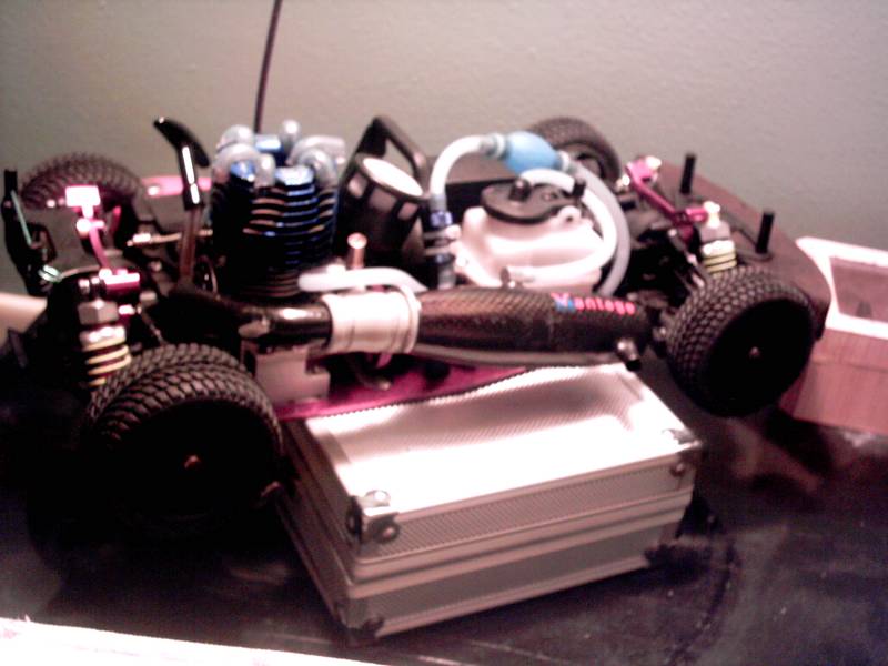

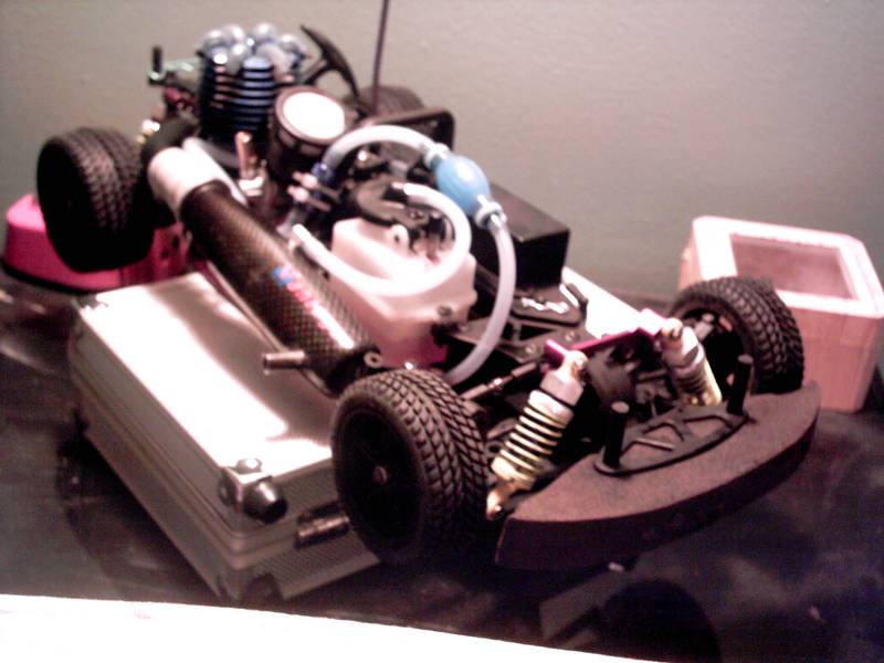

Its been around six or seven months since i had a real "RUN" with my rs4.
Im just going to cut thru most of the story
So once i received my tires via UPS. the first thing i did was sand off the edges of the rims and tires so the glue would bond a better.
The tires gave a considerable amount of grip even with all the loose gravel we have in front of our house. There good enough tires to make it clear your gonna need to "re-edit" your suspension a bit. So the next thing i did was go to my LHS and bought a pair of Hpi's inner foams. Altho they are 26mm they still fit good enough to drive. Make sure you use slow drying tire glue when mounting
So i took my r/c to a near by 90% empty parking lot. Sadly the car rolled over a few times (scratching the heat sink) which then I decided to ease off from turning too sharply so I wouldnt flip anymore. The hardest thing im having trouble with is keeping the tires glued to the rims. even after sanding they still come off on the outside edge. Since i could not mae full use of my Imex wheels, i brought my foam tires with just in case the ground was smooth enough to use foams. The foams worked great and even though there was some small rocks and gravel, the tires barely "chunked". Only a few small chunks are gone but nothing worth worrying over
So do you want a pair of tires like these? ~Sure~ The price isn't too bad and you can use them on loose (NOT rally tire loose) grounds along with smooth pavement.
Really any car can benefit from having WIDER tires on the rear. but if you dont have an after market battery tray, your going to need to find a thin spacer or small washer to keep the tires from rubbing on the left rear side of the car (the battery tray). I would recommend putting the spacer/washer on both side to keep everything even.
ALSO! i almost forgot this tip. when you get any new rims. put a few thin coats of CLEAR over the rims, this way u can help keep them from losing the chrome/paint that's on them

damn man, those tyres look big like rally tyres. How many washers did you have to fit to clear the radio tray?
also whats that blue bulb in the middle of your tank and fuel filter? Is it a primer??
Join Date: Aug 2006
Location: Sioux Falls, S.Dakota >_>, SD
Posts: 1,784
RE: Engine to tires
lmao. that "blue blub" is a primer. but yea i just used one washer in front of the hex but before the wheel. I would of liked to find longer hexes but i dont think they make those
