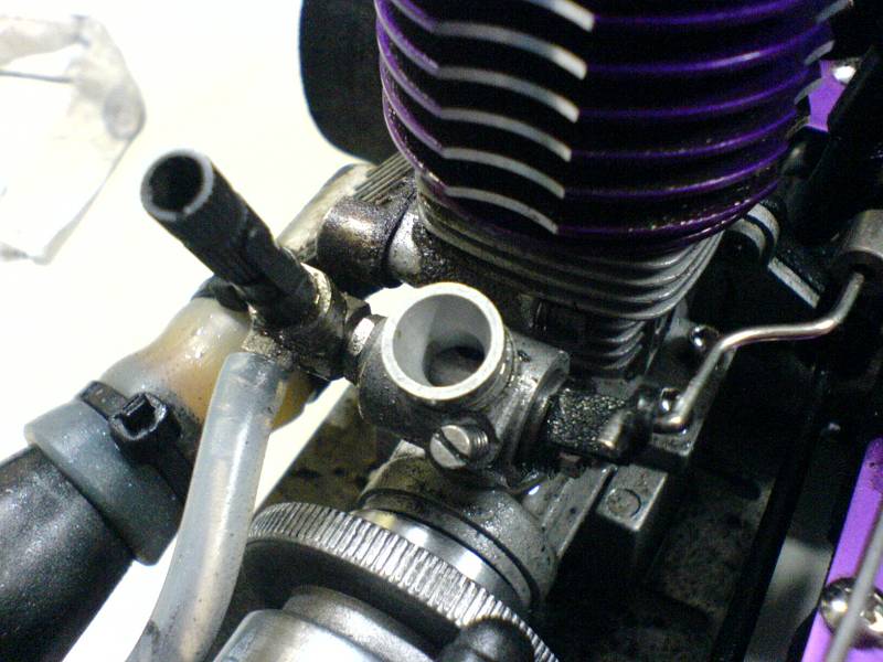

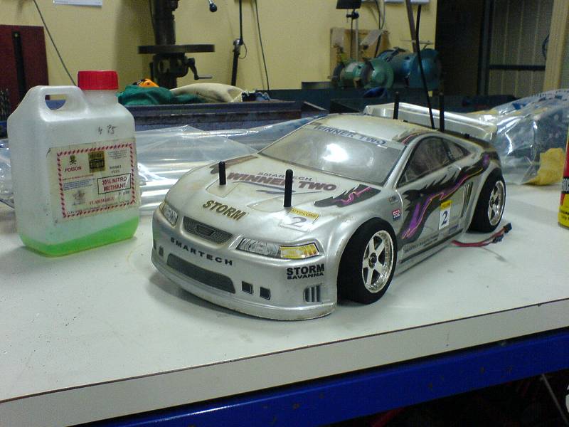

I got my first nitro car the other week was given to me with no radio gear i got myself some radio gear off the net for it and have it all set up and the radio stuff works fine. from what i have worked out its a smartech winner pro 2 car , i think it has the .15 cxp motor in it im not sure tho, all i got was the car has no manual nothing else with it. i have had it running but extreamly hard to start have worn skin off my fingers from pulling the pull start for hrs trying to get the car going. Once i have got it running id dusnt want to rev easily and it hates to idle. i have the carb at idle open about 1mm but it dies in the ass at idle unless u keep the revs up and it seems to rev not bad but also sounds like its missing i have fiddled with the carb settings get it revving nicley and freely but seems to just cut out while revving. hard to start and once it starts i cant get it to stay in one spot it i just wants to drive off,, plus the other day the clutch seemed to have stuck on and while pulling the pull start the wheels were spinning but that problem has gone once i had the car running for a little bit, people keep saying warm he car up then tune it i cant even get it to warm up to temp coz it barely wants to run, plus how do u tune this motor i have attached some pictures and was wondering if u guys and girls could give me a hand on how to tune her up a bit and get her running. sorry for such a long post but i need some help bad. the car also has a new glow plug #5 if that helps and is running on 16% nitro fuel. that is also new

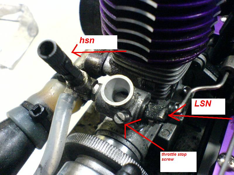

Reset the high and low speed needles to factory settings. I am not sue what they are, but you can go online and find the manual on pdf file to find out. Then it should fire up and you can start tunning. To tune just turn the hsn in until you see no more improvment in engine preformance or smoke stops pouring out of the exaust. If there is not smoke you are running the enige to lean and it will burn up. Also everytime you make a adjustment you need to make a couple of high speed runs to clear out the engine and to see the effects. when you make adjustments only turn 1/8 of a turn at a time. Then tune the lsn just pinch the fuel line rihgt before it reaches the carb. IF it takes the engine longer 3-5 seconds lean out the lsn and try again.

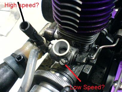

So is the setting just after the fuel intake the HSN and the little 1 on the carby that sets the opening of the carby at idle is the LSN?

Either way turn your main needle in all the way until you just start to feel resistance. Don't force it. Now back it out 2 1\2 turns. That will be a rich starting point.
If you have a low speed needle as well you should unscrew the idle stop screw (the one by the carb barrel) until the carb barrel will just close completely. With the barrel closed turn in the low needle until it just stops. Again, don't force it. Now open the carb all the way and unscrew the low needle 1 1\2 turns. This will be a very rich setting. Now you can put your idle stop screw back to a 1.5mm setting.

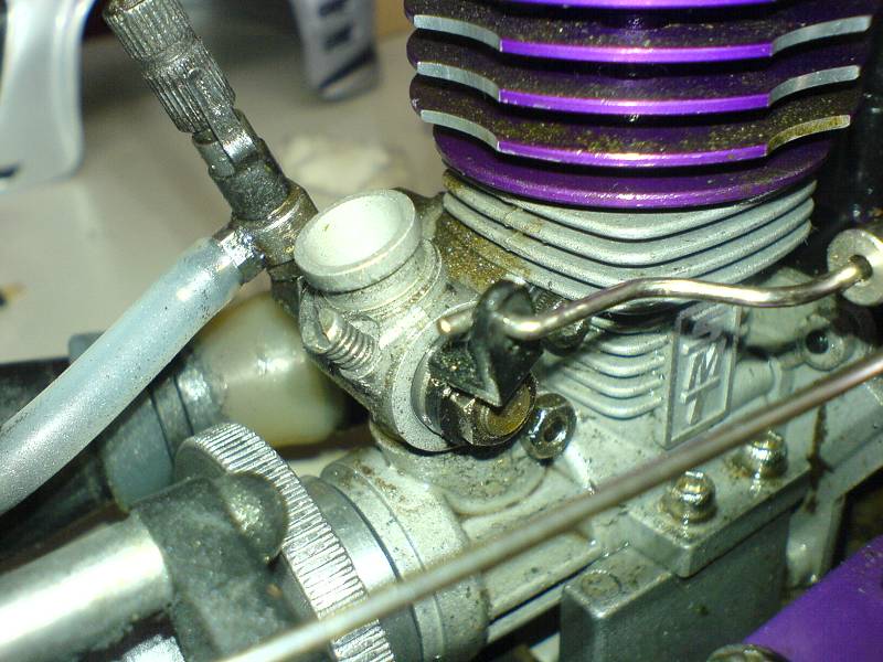

edit: just went to have a quick look there is no LSN its just wat the servo arm connects to with a nut clamping the little bracket in there here is a pic, this is my first time with nitro cars so bare with me :S soz for being a ball breaker.
