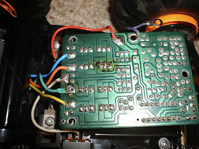

full quality pics are here: http://picasaweb.google.com/nova20/RicochetProblem
Here's the back of the board (click for bigness):
In the lower right there are 4 sets of 3 connection points (right above the red wire). The problematic part is connected at the set of 3 in the upper left of those 4. It seems to be in line with the orange wire.
Wire layout:
white - battery
yellow - motor 1 (works)
green - motor 1 (works)
orange - motor 2 (bad)
blue - motor 2 (bad)
red - battery
purple - antenna
Here's a close-up of the part itself. Looks pretty nasty (click for bigness):
Camera was too close to focus on it, so here's a wider shot (click for bigness):
The text on the part:
NEC
B2772 Q
B772 Q
M 72

It's a transistor. I've found some possible matches:
http://www.newark.com/stmicroelectro...tor/dp/38M2093
http://www.mouser.com/ProductDetail/...9LqplOmLibqLc3
Your part number threw me. After I looked at the pictures close up, I saw it was B772. You can put that in the search box on those sites and pull up the rest of the hits. Looking at the back of the board, the only thing Ican suggest there is to maybe resolder the green wire. That joint looks a little iffy.

That older stuff had decent boards, that were actually repairable. Heck, they even indicate Emitter-Base-Collector locations. Just pay attention to that when replacing the part.

Got the part in today and got all excited while I pulled out my soldering tools... desoldering braid, iron, and solder. Honestly I think I did a fairly good job, but sadly it didn't do the trick. The damned wheel just won't turn. I even took the part back out, turned it around, and put it back in. Nothing. It's possible I damaged the board with my 30W iron... but Idon't think so.
In any event, here's some pictures (as before, click for bigness)
New part in place:
On the other side, you can see my horrid soldering job. Actually, it's not that bad, there's just flux all over the place. How do I get rid of that stuff?
As you can see, I also re-soldered the green wire, but I think Imade it worse. However, that wire goes to the other motor (and works fine), so I'm not complaining.
Anyone got any more ideas? I'd restart from the ground up with all new parts, but I'd have to use the existing board (unless someone knows where I can get a new one).
