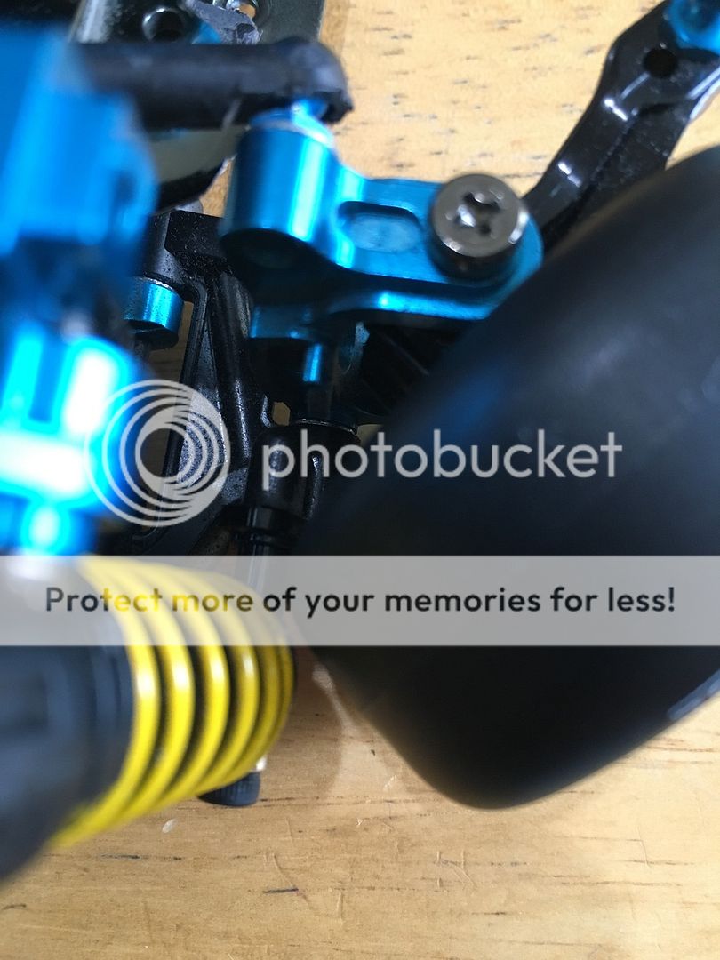

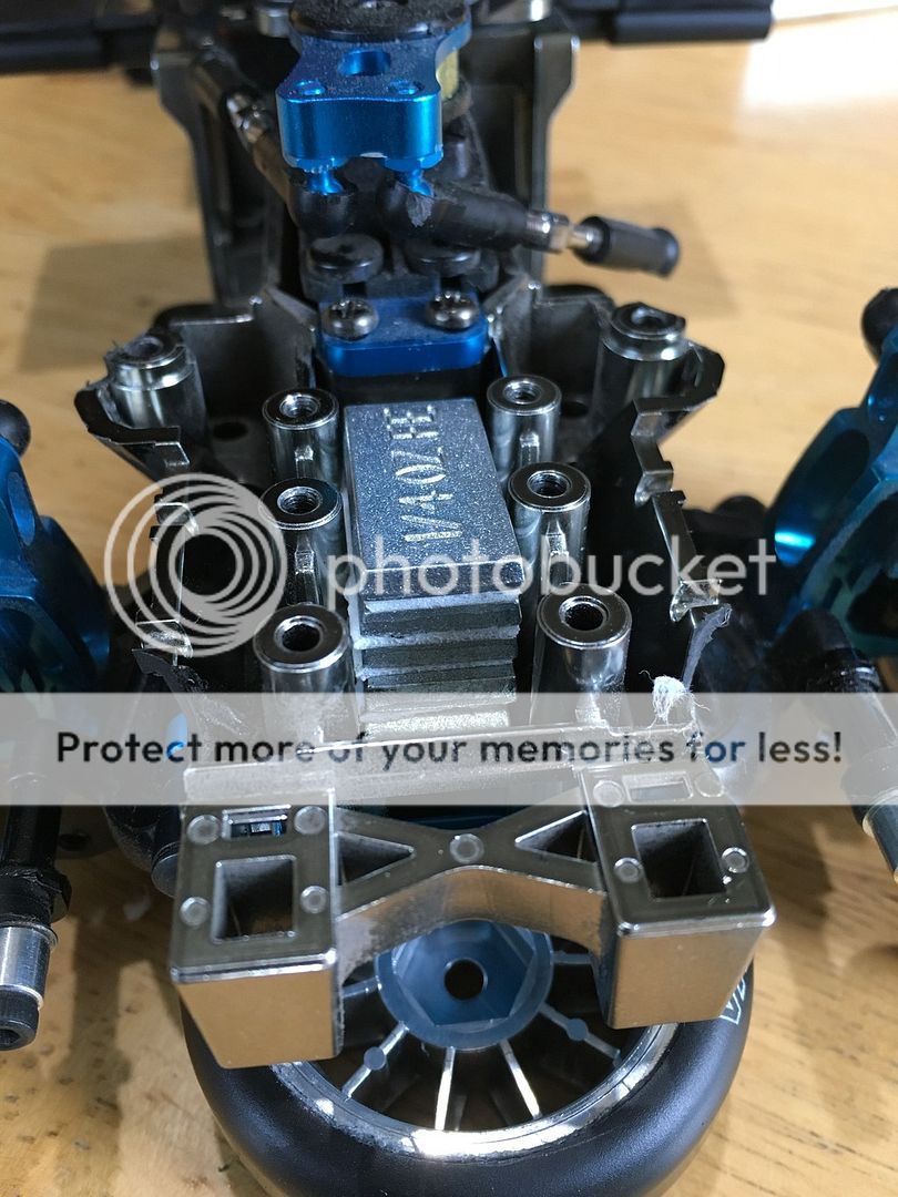

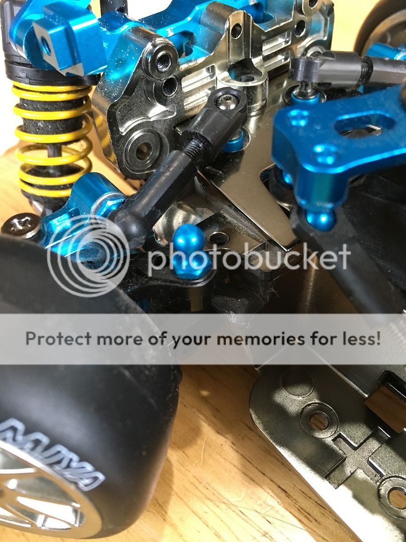

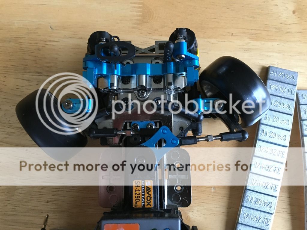

Hello all!
Been a while. doing weird stuff. Like this.......
As anyone familiar with Tamiya's "M" series chassis can see, this is an M05, but the new model....the ver.II Pro. It has also been reversed, to a RWD drifter. The only real things missing are the drift tires (more on those later). The entire idea is an old one - approx a year ago, someone posted a vid on Youtube about this very conversion. It intrigued me enough to want to do it, And with the ver.II Pro coming out, it was a no-brainer.
The M05 in the vid used a different type of front suspension/steer set-up that is popular in Japan. I tried to use as much of the kit's parts where I could, just to see if it can be done, and you would be surprised to learn just how little extra is required to make this conversion.
That said, the model was weighted, in the pod that now makes up it's front end. I'm not certain about the amount, but suffice to say the compartment is filled with 3/1`6th's diameter pieces of lead wire held in with Shoe-Goo. This makes both ends weigh the same, so technically, this model with a good rear diff could conceivably make a good converted RWD racer, too.
As can be seen in the pics, there is a gyro tucked in between the RX and Servo. The unit is an HPI D-Box 2. The motor size is 4600KV, which, I am finding, is a bit anemic, so am going to try the 5700Kv motor. The ESC is the Castle Sidewinder 3.
The body is no longer available and would it surprise anyone to learn that that particular body is six years old, and sat at the bottom of the closet for five of those years?
Now, on to drift tires for "M" class chassis:
There are pathetically few companies making tires for this class, and even fewer making anything drift-worthy. So far, all the companies I've tried make them too hard for smooth concrete or asphalt. I have another set from yet another company coming, so will give an accounting, as soon as they arrive and are tested. There really is only one company that makes tires that will work, but they are out-of-stock pretty much everywhere.
HPI T-Drifts.
Anyone wanting to know any particulars I didn't go through here, just ask! This conversion was relatively easy, and by using the components I did, will save a few bucks for drift tires. So far, the only companies making "M" class size tires are:

Here are a few more pics.....
The first two to show the amount of steer deflection the STOCK components get! More than enough!
The bottom shot to show no mods under there.
and a closer shot of the rear body mounts, which were made from essentially parts from the kit......

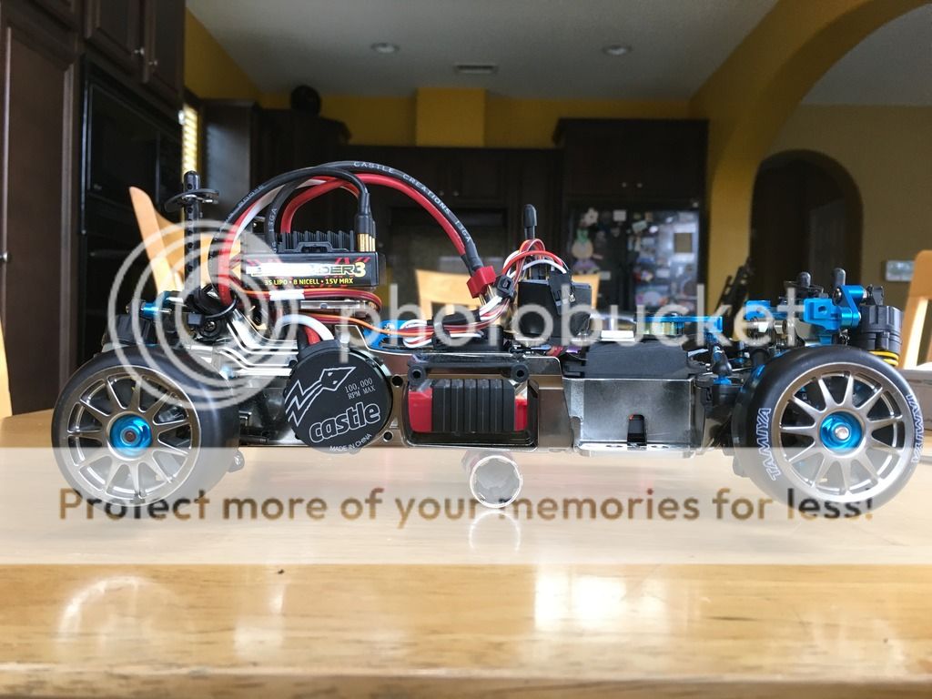

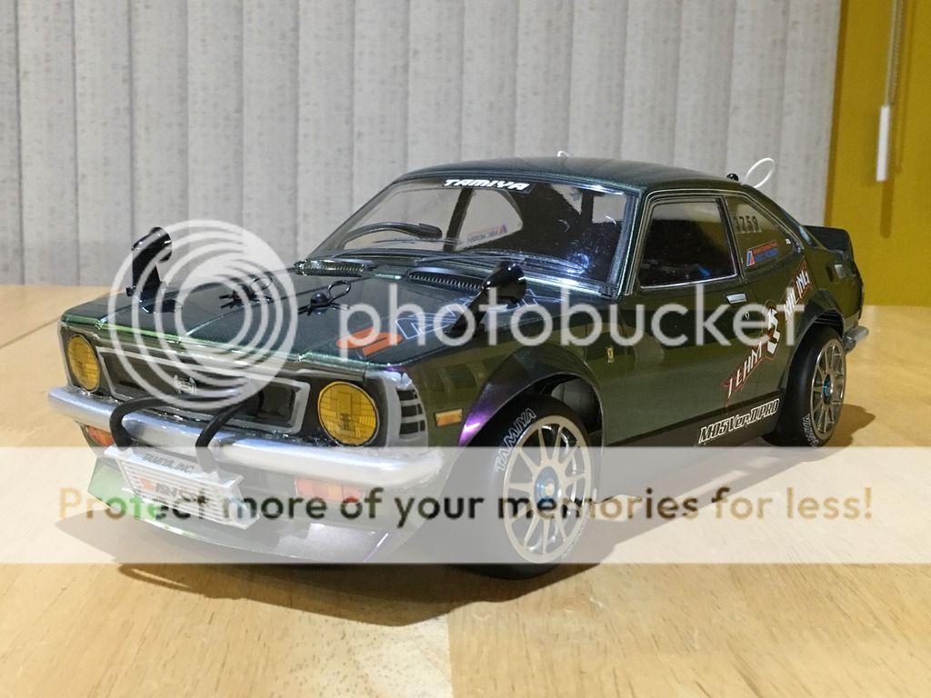

Update:
Here are pics of the drifter in it's last version. Notice some things have changed slightly.
Now....on to what I really found.......
I have Berber carpet in my home. I ran the M05 drifter on it, just for fun. I found it a perfect surface for running them. I moved all the furniture around my home (I'm the only one living there, and I don't entertain), and ended up with a 12 ft by 14 ft area to play with. It's more than enough to run the M05, but more importantly, every tire compound I run on it acts differently! At the moment, this brand of Berber prefers the harder compounds.
The factor most important to a RWD drifter, is it's ability to accelerate. The combination of Berber carpet with hard drift tires was an accident, but I find also many drifters in Japan going to carpet tracks, and those tracks have like....zero tire wear, but hard plastic drift tires and low, close-weave carpet like Berber just work well together.
Now I have somewhere to drift over wintertime, that's warmer than my garage, which is where I used to drift, and the garage isn't heated.
For anyone wanting to know, the rear shocks are from an Ofna H4e. In this particular application, both spring rate and damping were perfect as rear shocks. With the discovery that I can run this drifter in my house, I now find this M05 RWD drift project an interesting conversion that works, if the cardinal rule concerning tire/surface selection is obeyed. As a matter of fact, I find this conversion easier to drift (not just because of the gyro, either), but it re-creates actual driving.
Of course, not everyone can have Berber carpet in their house, and to those, they will have to work at finding a compound that works well on a particular surface near them. The Ride "S" compound appears soft enough to be a good choice for asphalt. My own all-around preference is still the HPI T-drift. On Berber, the best tires seem to be the hardest compounds. Tires like Tamiya's own "M" class size tires for drift (which I am using now) work well. As soon as I can get a set of Ride "H:" compounds, I'll let everyone know, but in the meantime, I'm drifting in the house!

I know that this is an old thread --- but following the pictures as best I can I have come to this point in my rwd project. Work in progress...
Body Test Fit: Tamiya M05 chassis
Left Max Turn
Right Max Turn
Can't clear front suspension that is the max angle I can achieve unless I changes front suspension...
Front barely hits spring
Dremmel corner to clear front arm
Adding stick on weights from local tire store as the chassis is rear weight bias
Before: Note Rear weight:
weight in front compartment:
After Weight added:
Rear balance notice veers to right because of motor. need to get counter motor weight from tamiya:
Body Complete:
Other Drifter: shaft awd Rear spool front 1 way. Yokomo Type C
Final Form:
