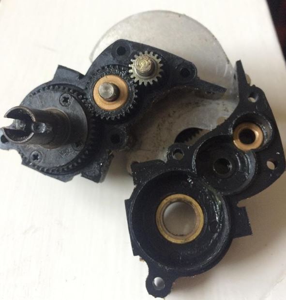

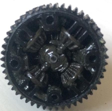

I opened it up pretty simple, can't really find any wear
Wait am I suppose to fill the diff with silicone oil or the same lithium grease that needs to be put on the outside of the diff (the edges)
everything seems good no wear here^
do i put in silicon oil (i have some thrust bearing grease too) or do i put in the lithium grease in here?

The EXT diff is not a sealed diff. Putting oil in it is basically useless. Grease only. I don't know how old those bushings are, but that's one area (bushing < bearings) of the truck I'd be upgrading first. Bushings only last so long, and will develop signs of wear over time. Installing bearings, in place of the bushings, will increase performance greatly.

Oh god yes, replace those bushings with bearings! Man, that must be an old tranny! The gear teeth look fine. Clean out all the old grease. Use some black grease on the gears and in the diff. Lithium grease is too thin. Trak Power blue waterproof grease is the best, and a little tub will last you years.
on those missing parts .. first I thought you were missing the screws! But I see it's the lock washers. It could be that those screws, without the washers, are poking out the back of the slipper plate and not allowing the plates and clutch pad to mate properly. Check for that. Also, the brass bushing that fits into the spur gear wears out and needs replacement eventually. It does sound like the pinion spur mesh is tight.
