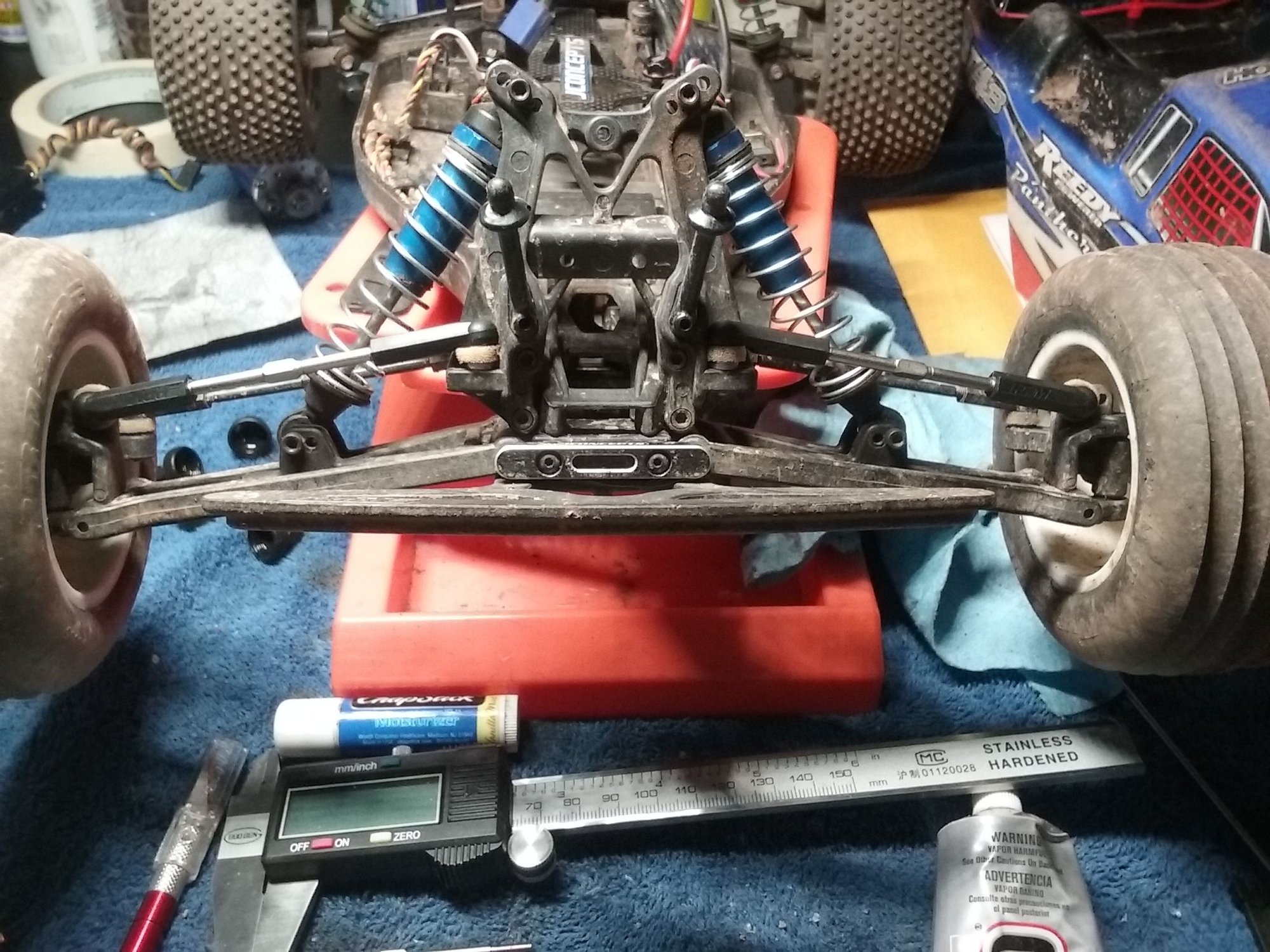

Default T6.1/SC6.1 Turnbuckles
After getting the turnbuckles in the mail, my suspicions of newer AE platforms using longer rod ends were confirmed. Long shank RPM ball cups, and the shorter turnbuckles from a T6.1 fit/work great. Now we're back in business.

I had some Traxxas collars laying around from the time I was wanting to put big bore springs on my SC10. They're collecting dust, and a front set of "BB" springs that were left over from my SC10.2, everything is making their way onto the T4.3's front end.
