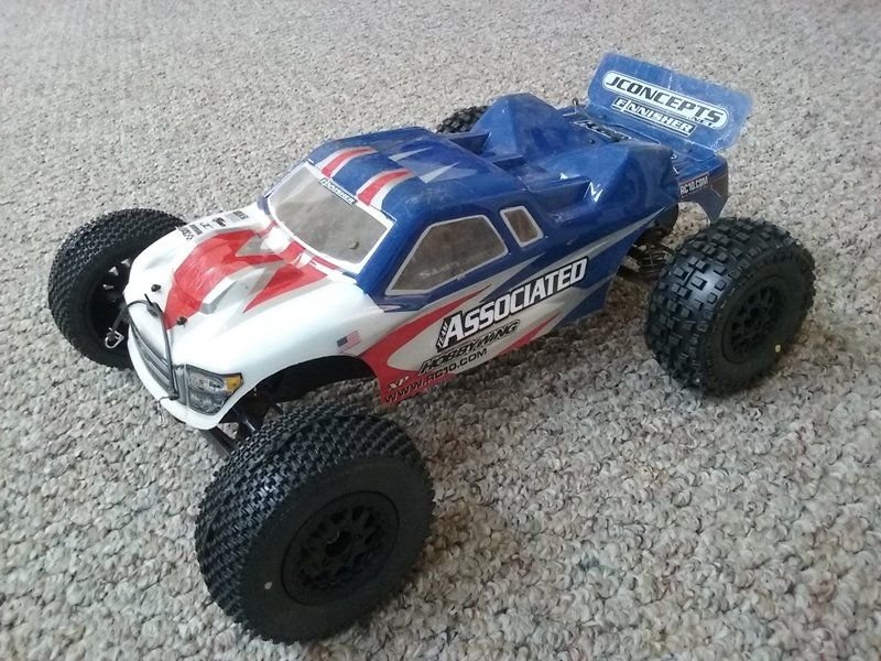

I must have been really focused on short course and never picked up a Finnisher lid for my stadium truck. I had in my mind I'd be content with Bulldog bodies. I missed out on the first round of JConcepts Finnisher bodies for the T4.2FT. I wasn't going to let it happen again; even if I have to put a T4 front shock mount on. After selling off all of my Pro-Line T4.2 bodies, that I had stashed away (sorry MERLIN), my first batch of JConcepts Finnisher T4.3 bodies showed up. This is the part of the hobby I dislike the most ...painting . It takes me forever to get in the groove of things and spray a body.

Got tired of waiting for the weather to cooperate to do this thing. Cranked up the heat; brought air compressor inside to "man cave", and got the first two colors done anyway .
Edit: Finished 'er up tonight. Glad that's over with. Stickers, spoiler, and some sun...we'll be in business.
Edit II: Some stickers and spoiler now on the Finnisher body. Still waiting for the sun .
I can honestly say I'm glad to be rid of my Bulldog bodies. Don't get me wrong, I like Pro-Lines bodies, it's just the way Associated had the Bulldod body painted for the manual and T4.2FT's box...probably one of the worst paint jobs AE has ever used IMO.

How did you use a T4.3 Jconcept body on a T4.2? Swap front shock tower only?

Used T4's arms, body mounting posts, and shock tower. The shock tower had to be shaved a tiny bit to clear big bore shocks.
