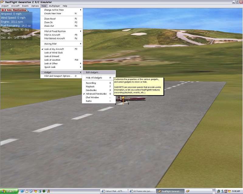

To find out your FPS go to VIEW, EDIT GADGET and you can choose which options you want to view, FPS being one of them. You then select advanced NAV GUIDE to have it show on the screen.

My system specs are about two messages up and as you can see in the screen shot I took, I was only getting 45fps. If I crank everything down I can get in the 100's but I prefer it to look better as long as it doesnt let lower than 30fps...
